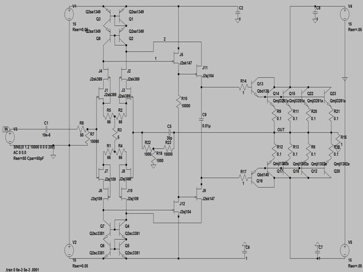

JFET INPUT FIRST EFFORT
Graham,
I duplicated you Spice simulation results to have a reference design that I could breadboard. Thanks again for your hard work. I'll remember your emphasis on hf second cycles where base junction carrier retention can prematurely cause slew rate limiting unless the charges are pulled out by a powerful driver stage.
I would also like to develop a complementary differential design using JFETs at the input and perhaps the VAS for comparison. JFETs have the mystique of low noise and fine detail. The attached schematic is two nights work of downloading LTspice, models, and a first topology. Better ideas are appreciated.
WHAT ARE THE BEST LOW NOISE SINGLE PACKAGE MATCHED BIPOLAR PAIRS FOR:
(1) NPN front-end current sources; 4-10 ma
(2) PNP front-end current sources; 4-10 ma
(3) NPN front-end input differential;
(4) NPN 2nd stage current source of 200ma - 400ma;
(5) PNP for front-end differential pairs;
ARE THERE ANY HIGH CURRENT P-JFETS AND N-JFETS THAT CAN BE USED FOR A SECOND STAGE VAS?

"Fred,
You seem to be the one the major issue with the sim #, why don't you measure one of these devices for us?"
Maybe because I am not the one claiming parameters that are not shown on the data sheet. I have looked at these type trends for devices that I use like the IRF 150 and a few of the IXYS mosfets. I can't understand why you would not have ordered some to measure yourself if you are convinced the device has that good a transconductance at 2 or 3 amps. Afraid of what you might find? I am sure someone will get around to it. Maybe Mr. Pass or Mr. Hanson has some experience with similar mosfets.

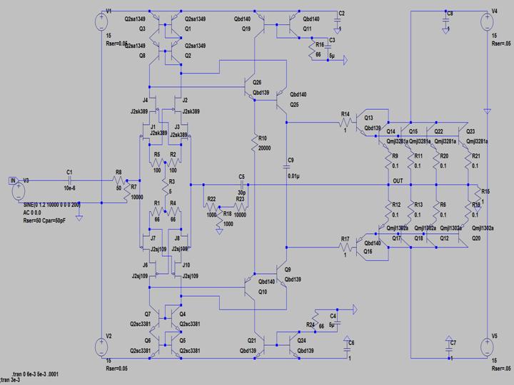

Hi Linesource,
I have a couple of questions about the attached schematic in post #146.
I will focuse on the upper half in my following questions.
What is the idea by cross connecting the cascodes gate to the opposit lower J-FET's Source?
The Miller capacitance seem to me acting in a negative way.
What is the benefit of using doubble curren mirror?
And what is the benefit by connecting Q25 emitter to the input circuit?
There seem to be some 220 mA running through Q11 (15V-0,65Vbe/56 Ohm?), what current are you (as I'm a bit unsure about the circuits function..) suppose to drive through Q25 with emitter connected to the current mirror?
Further on why using R10 with value 20000 Ohm, if the current mirror is programmed to 220 mA, it would equal 4400 Volt over R10 if there is going to be any 220 mA, otherwise I don't understand the use of current mirror Q11 and Q19?

LineSource,
You’ve got a few ok parts and pieces there but they don’t hang together yet – not even in sim ( for posts 146 and 149)
Current mirrors/sources are seldom made with matched monolithic transistors in audio power amps, current/voltage limits of the few types available and substrate parasitic effects make them not worth the bother compared to discretes with a little resistive emitter degeneration – the discretes can be hand matched and/or current balance trimmed with a pot – and that’s even hardly necessary with 6-700 mV across the degeneration R
The 2nd stage/VAS is totally confused, if you mean to use a folded cascode type design you need to remember the dynamic output current is only that of the 1st stage and compare with the worst case driver base current need – and figure out the right bias arrangement too – I think you’re trying for something similar to: http://www.ne.jp/asahi/evo/amp/J200K1529/report.htm (no I can’t read the text but as much as I can “read” the schematics they seem plausible and show quite a few options, fig 13 looks a lot like where I think you’re intending to go)
The driver/output stage needs a bias source – and given the apparent willingness to waste power for high voltage supply overhead with the +/- 15 V output supply there is no reason not to use one that directly senses and regulates the emitter R voltage to control the class A output and bypass thermal coupling/compensation issues altogether
A way to improve dist # is to change the output from the discrete Darlingtons to Sziklai/CFP – they can perform well in Class A outputs (and only class A due to complicated turn on/off behavior that compromises their AB/B usefulness) – potential stability problems may also be reduced by the specifics of your nearly pure resistive load

Hi LineSource,
I find it difficult to understand why you would wish to attempt such a complicated circuit.
You will need approx 100 ohms between the BD139 and BD140 emitters, for otherwise the output devices will not turn off quickly enough.
Why do you have cascoded mirrors; see note I have attached. Note that you would have to turn my 'A' around to use it in your circuit.
Have you got it running on a simulator yet ?
Cheers ............. Graham.

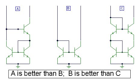

Graham,
A is a Wilson current mirror, B is standard current mirror, and C is a cascoded current mirror.
The Wilson current mirror has better DC accuracy than does a standard current mirror, so in that sense is better. However, it relies upon a short feedback loop for its improved accuracy and may not sound better for audio.
But why do you say that a standard current mirror is "better" than a cascoded current mirror? The standard mirror is simpler, but suffers much more from the Early effect than a cascoded mirror.

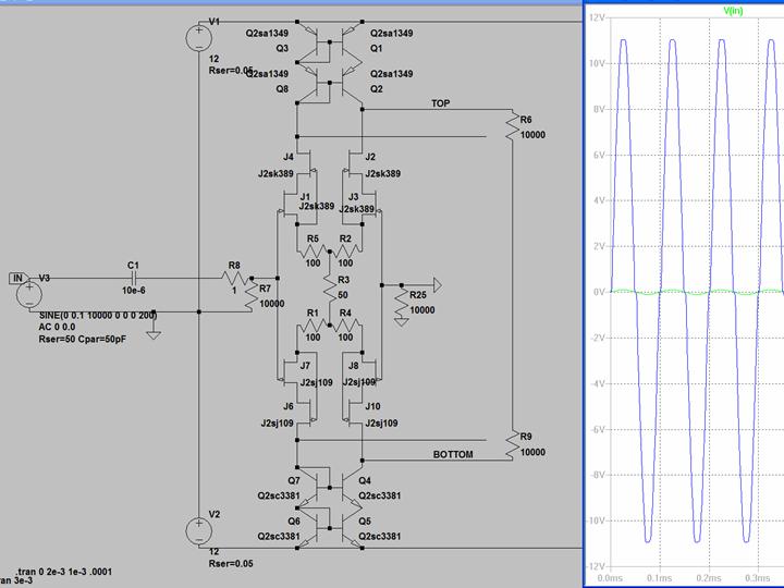

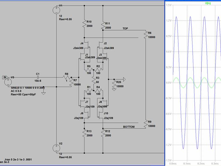

Jfet Cascode + Cascode Current Source
Graham, Charles Thanks for staying with my 25W 1 ohm thread.
There is a mystique about complementary JFET front-ends and separate current sources for each driver stage as perhaps the best topology for low noise and high detail at low power levels that I want to test for myself. Since I've only had a couple hours to download LTspice and search for transistor models, discussing ideas for each stage seems like the best path.
Input stage: JFET cascodes should reduce the input capacitance below 50pF and also reduce distortion by 2x-3x at low outputs. Using a balanced input should reduce distortion by another 2-3x.
I want to find out if I can hear the difference between a high impedance current source and resistors. A current mirror has Rout ~ ro, both the Wilson and cascode have Rout ~ hfe/2 * ro, and the cascode has balanced voltage drops.
Attached a complementary JFET cascode input stage with complementary cascode current mirrors. 0.1V input, 11V output.
