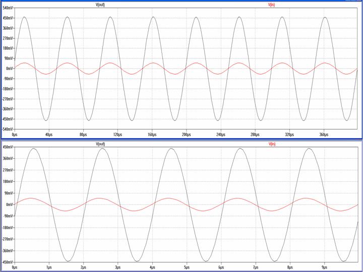

post #168 simulations
Attached are simulations on the circuit in post #168 using LTSpice. This is my cascoded input and cascoded current sources embellishment of Graham's earlier circuit.
TOP plot: 20KHz - 50mv intput 450mv output into 1 ohm load
BOTTOM plot: 500KHz - 50mv input 450mv output into 1 ohm
Low noise and low distortion at very low power is one of my main goals.
I will probably build both circuits to determine how the extra complexity for cascodes affects the sound. Circuit comments are appreciated to help get the best design using the best transistors before I order parts.
JCX...I'm still working on the cascoded JFETs, and would appreciate suggestions for transistor numbers that cascode well. I will use resistor loads for the JFET input stage and +/- 12 volt to 15 volt power supplies.

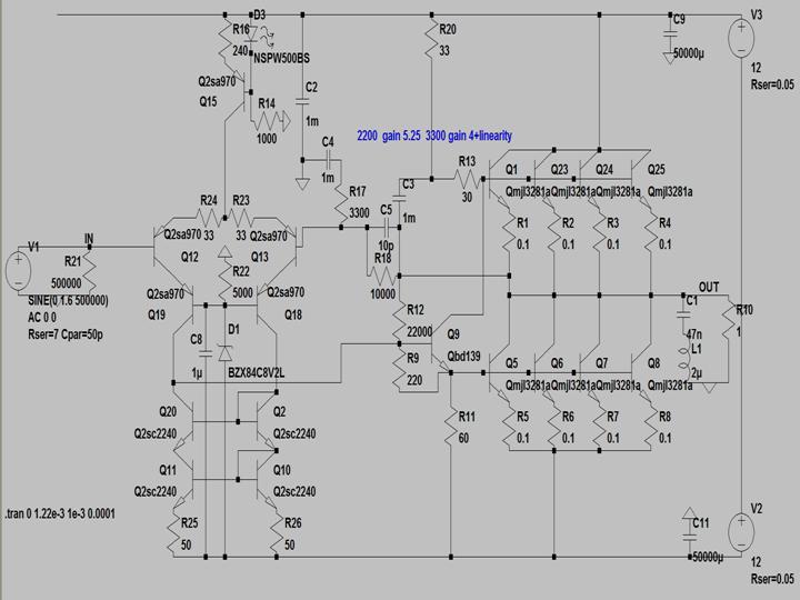

BETTER AMPLIFIER TOPOLIGIES??
I would appreciate sketches of any other amplifier topologies which would deliver very low noise and distortion at low power into a 1 ohm resistive load.
A complementary differential topology using cascoded JFETs would be very helpful. I am currently working with N cascode of 2SK389 input 2SK246 cascode, and P cascode of 2SJ109 input 2SJ103 cascode, and would appreciate other pairing recommendations which have higher transconductance and Id current in order to use closer to 10ma class A bias. Going from JFETS to bipolars in the VAS stage with low distortion presents a problem unless the bias is high.
Here is an update of one design I am considering.
