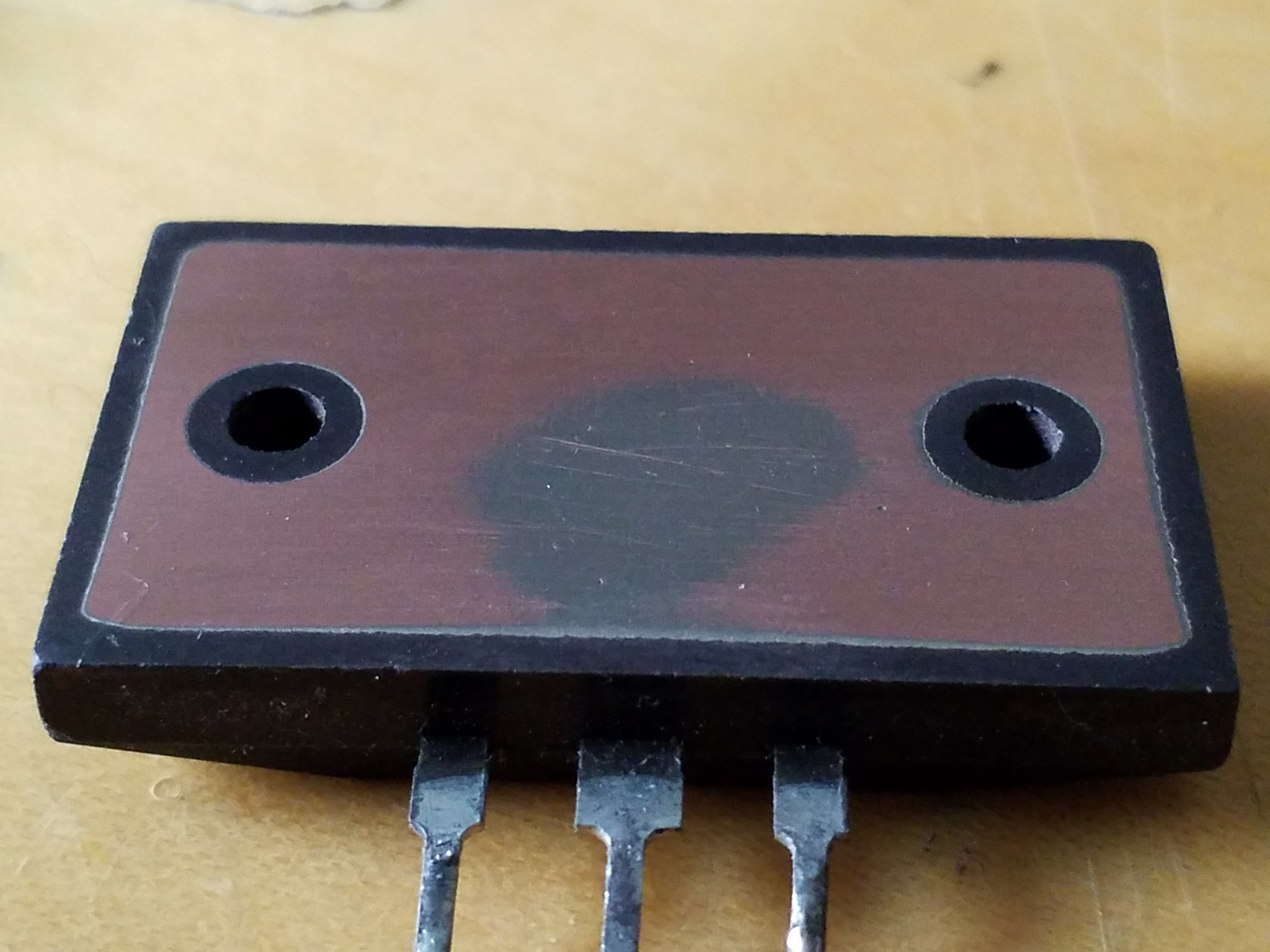

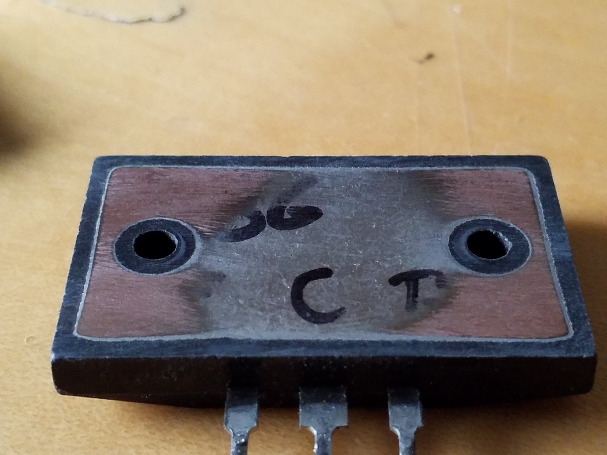

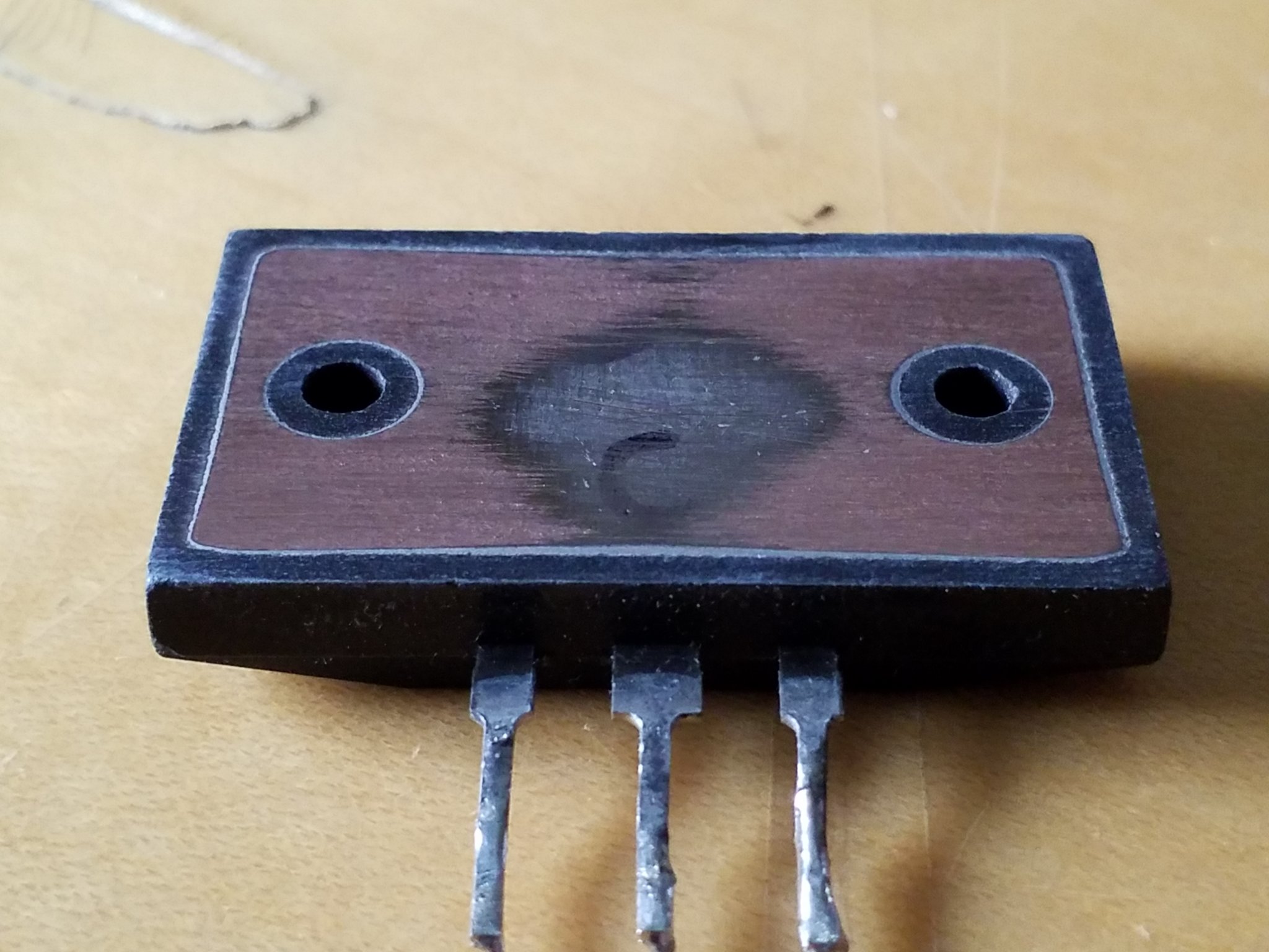

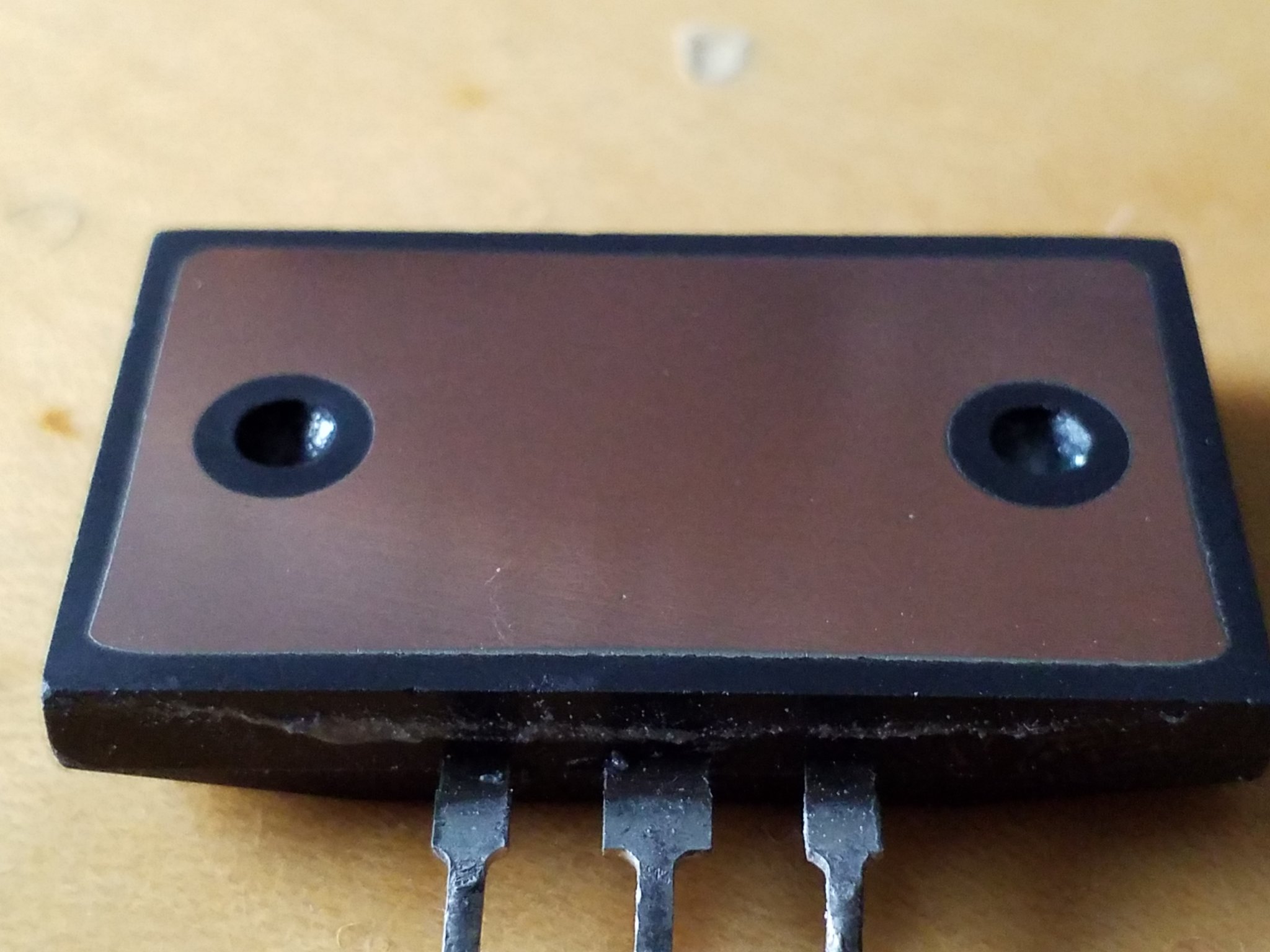

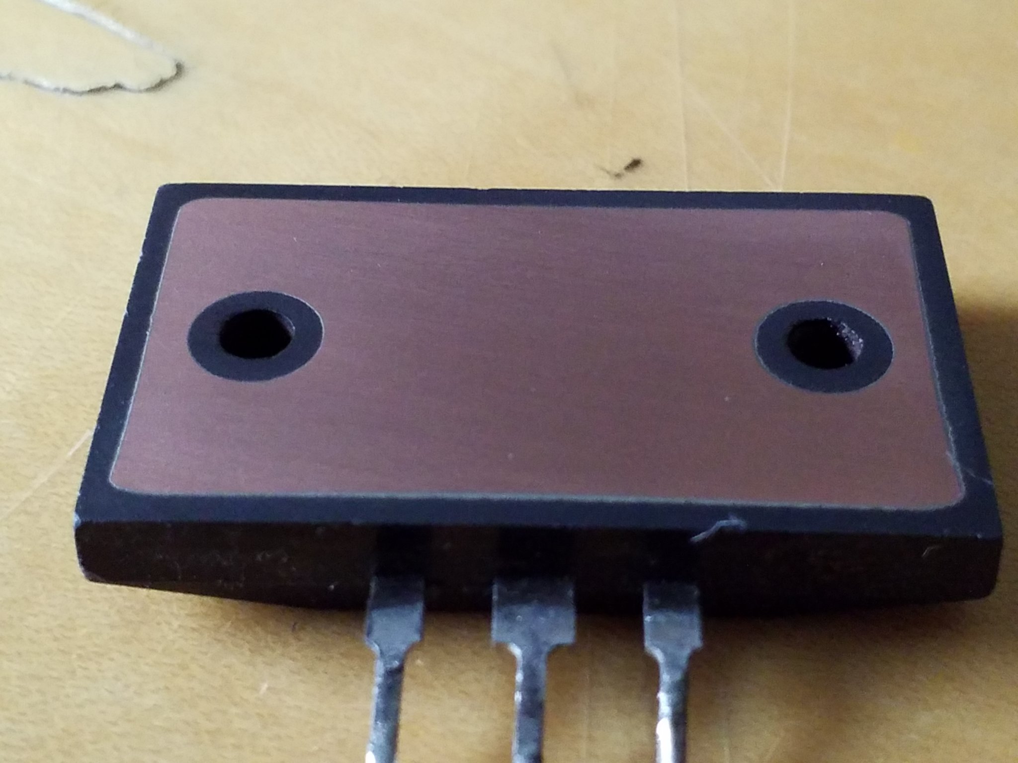

Was preparing theese sanken mt200 packages today, they are absolutely original, pulled from a start 90s amp,
I did not believe my eyes, those packages were far from flat, looks looks their warped into the middle were the actual wafer is mounted.
See for yourself, I bet heat transfer has gone up quite a bit.
Instead of only looking for the miracle. Heat paste, make sure surfaces are as flat as possible, especially in high current amplifiers,
