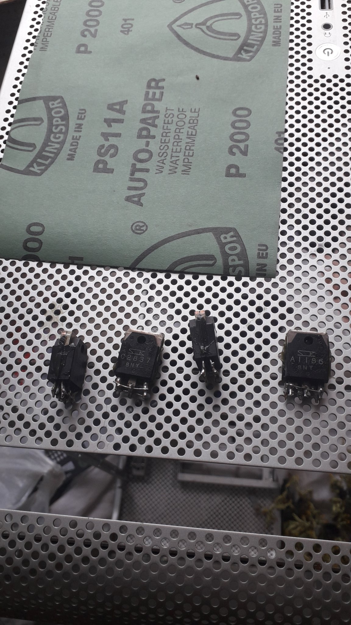

You can also sand the transistor package itself if you want to get down a couple °C:

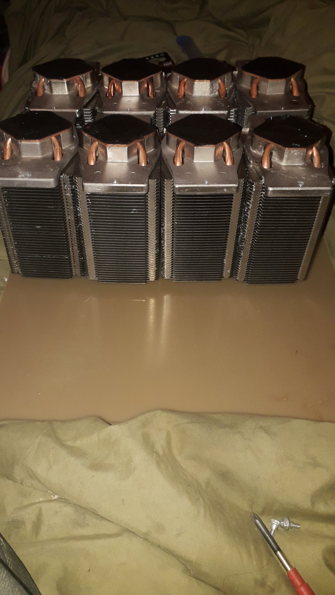

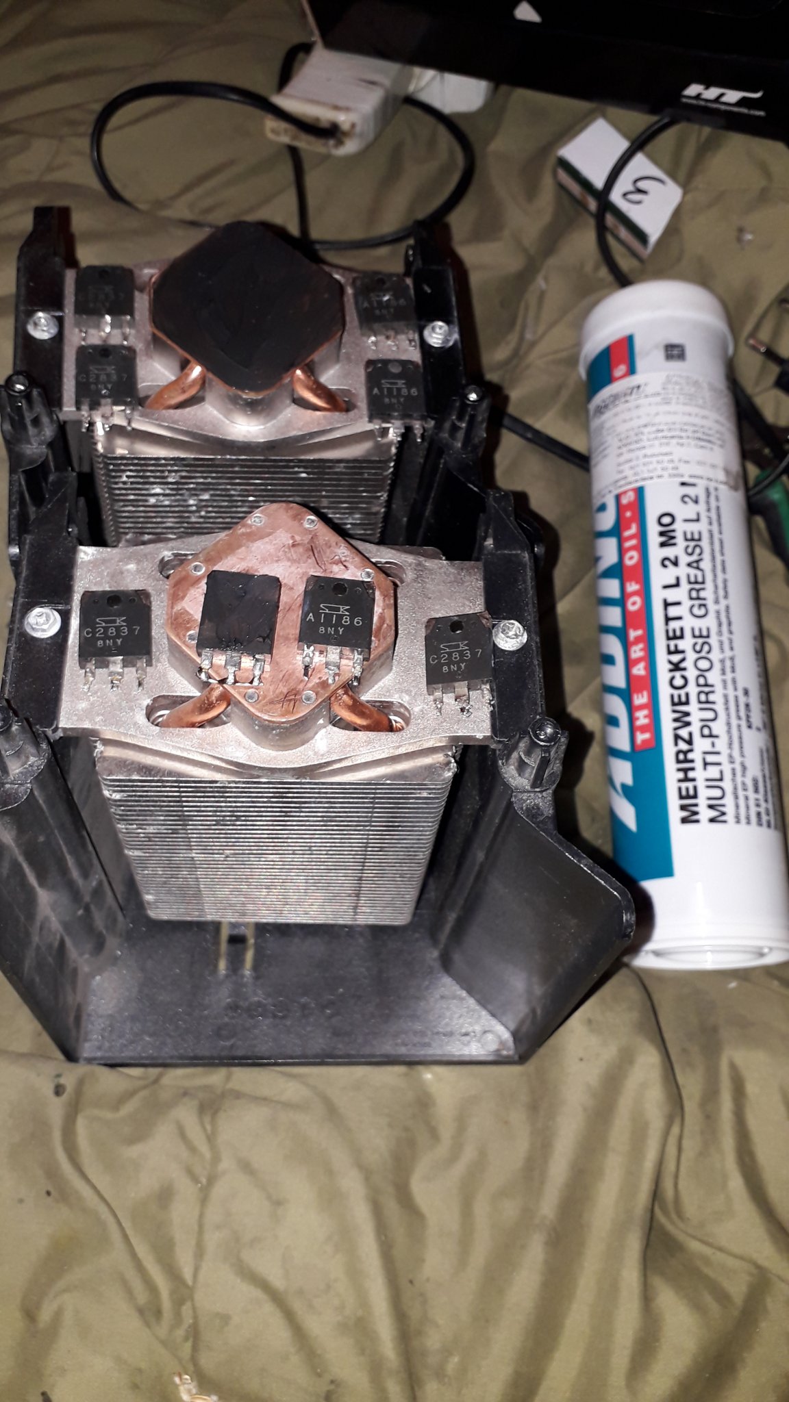

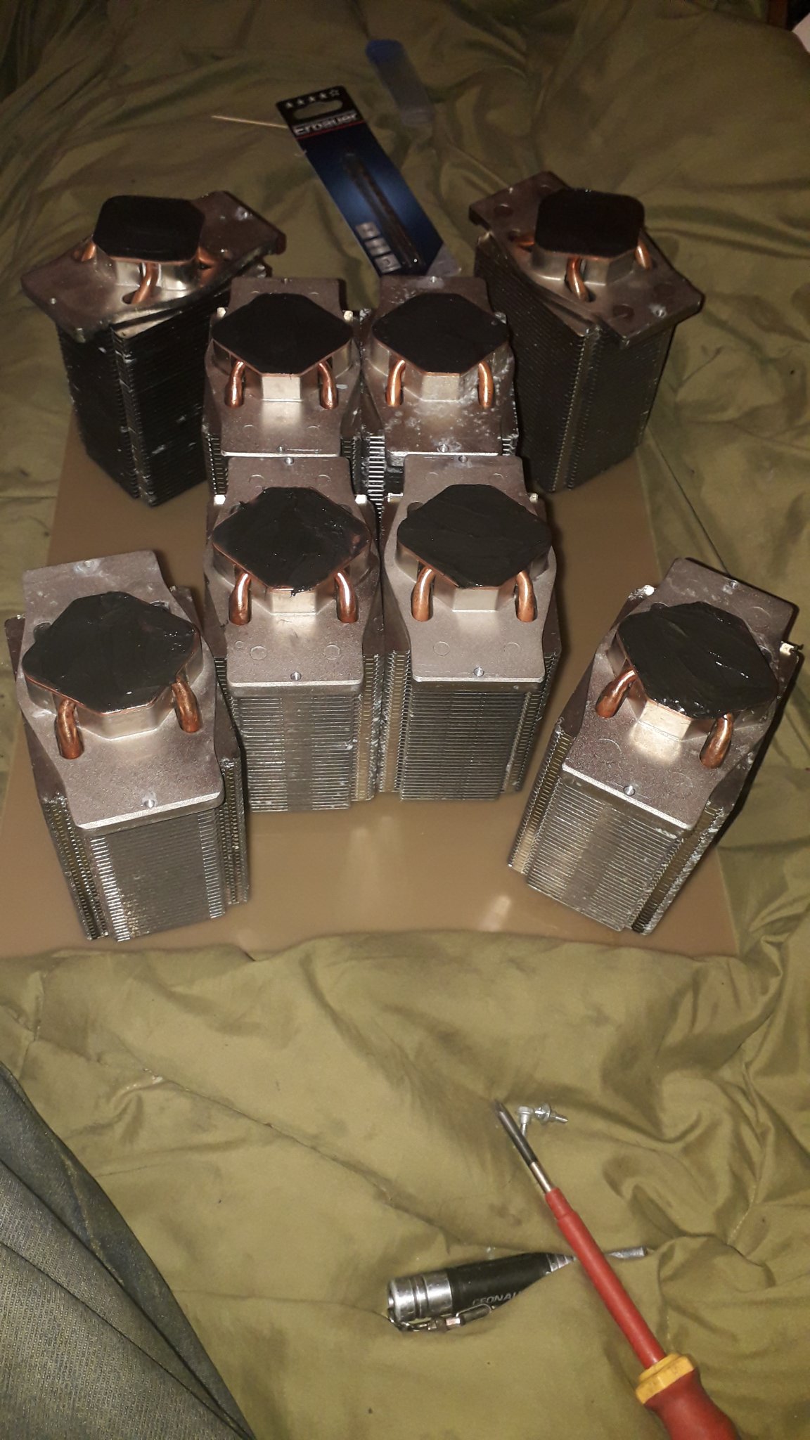

I have 4 pnp +4 npn, each will have its own heatsink, obviously copper interface.The first trz and heatsink were polished and I applied the cheappest graphite grease I found in a car shop just to see in a couple of days if it reacts in any way with the copper.Some more copper fine powder will be added at the end in the grease before sticking the trz to the heatsink.Of course the existent one will be removed snd replaced.
As I can't drill the heatsink I'll need to press the trz against the heatsink helped by some aditional aluminium profiles if everything goes right.
Instead of going with the best compound I chose the cheapest one...
I'm also considering for tests some very heavy duty grease for industrial ball bearings, the blue zinc sulphonate variety as I was told it's very resilient to the harshest environments and I might find some use for my bike hubs if it fails to show any significant performance.For now i need a lot of zen attitude cause one heatsink and one trz took me more than half an hour to polish.

It took me a full day to polish 3 more heatsinks and one more day to polish 8 transistors...It was a learning curve to make it better anyway...The most uneven proved to be the transistors...if all transistors are that bad then maybe optimizing that contact surface can be a really big deal...And the most weird thing is that the graphite grease has a very low conductance so I'm not sure how much graphite actually is in that...Most probably the final grease will actually be some very thin mineral oil for sawing machines or maybe Mos2 grease if it's going to be too thin.For the moment I used Cam2 Ultra580EP#2 universal grease to cover and protect the transistor's copper surface from oxidation.I used that grease for years not just in my bike rear hubs but also for every thermal contact without surface conditioning and I know it works really well.Used it also in some 2kWatt frequency converters for motor speed control and they are working 24/7 for about 3 years now...Some of my friends are using car motor oils for decades ...cheap country, cheap products...Thinking of buying some dense buttery blue mos2 grease, but I heard it's not that good for bike's hubs being too dense 🙂 Yet it offers a good thickener for any weird combination I might wanna try.

Being that they get way more expensive than the norm...I started to like my car graphite grease even more.It's conductive but i can deal with that for sure while I just found that the usual molibdenum sulfide found in Mo2 grease for heavy duty ball bearing has about 45W/mk which is about 8 times higher conductivity than mx4...Not sure how much molibdenum disulphide actually is in that car grease but the rest of it seems to be lithium, zinc oxide and some other petrol based organic compounds ... Being for heavy duty ballbearings these greases are not allowed to keep heat, they actually have pretty good conductivity, otherwise the balbrarings nondissipated heat would destroy the grease... An interesting study about two phase combinations of lithium grease and Fe, Cu or Al gave me sone hints to somehing that was probably best demonstrated by the Grizzly Kryonaut paste which is that Alumium can be superior to Silver (obviously to Copper too) when combined with something else in the same mass percentage due to volume/mass ratio , but I can't tell for the moment if It's the same thinking process that should be applied to Gryzzly grease. https://www.researchgate.net/public...ltipurpose_grease_filled_with_metal_particles
All in all it makes me feel hopefull about trying some moly blue grease too in between two copper surfaces.The best silicon thermal grease I found was almost always blue-ish and I wonder where it took its colour from ...Titanium oxides can be blue too...
