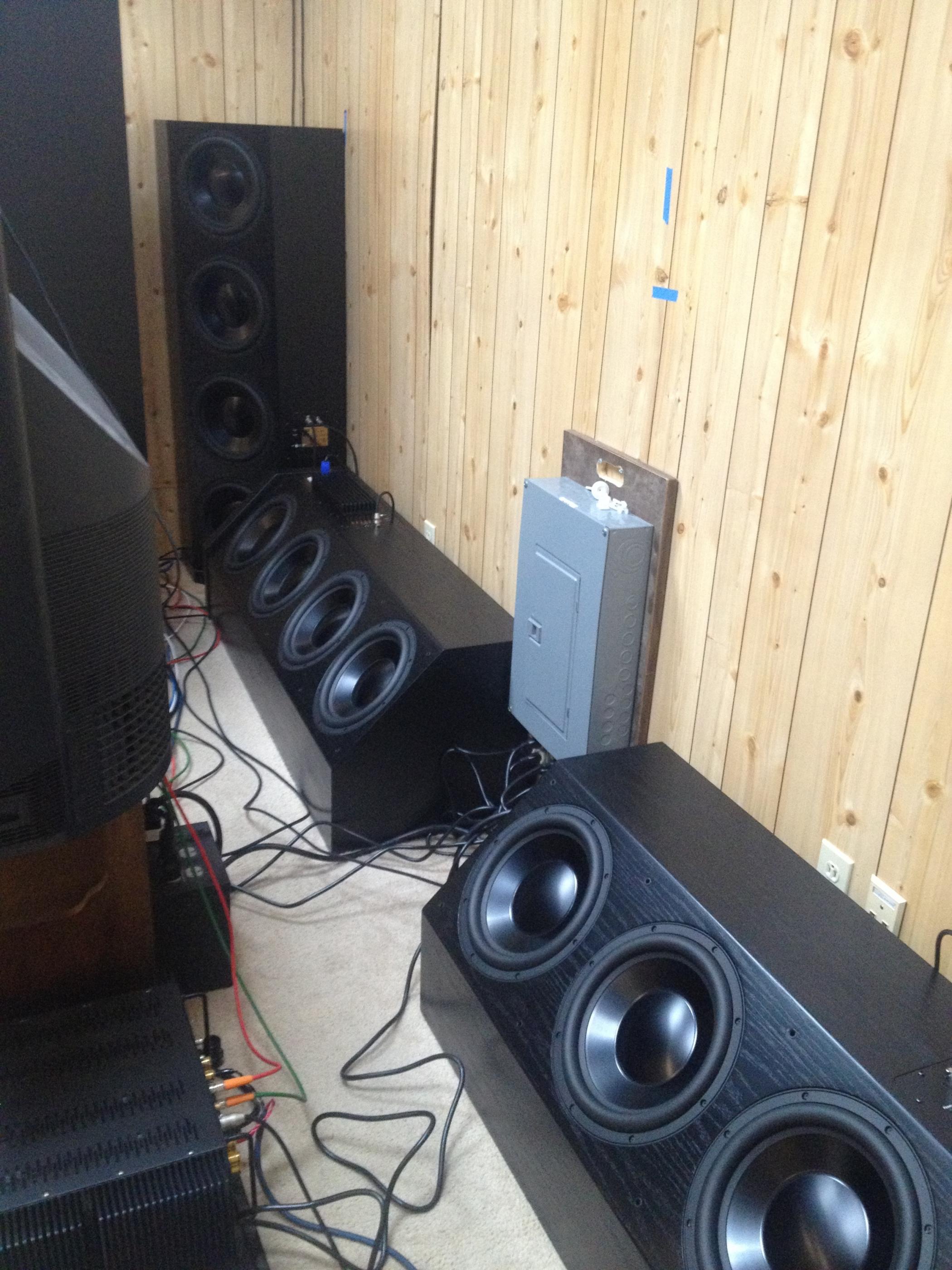

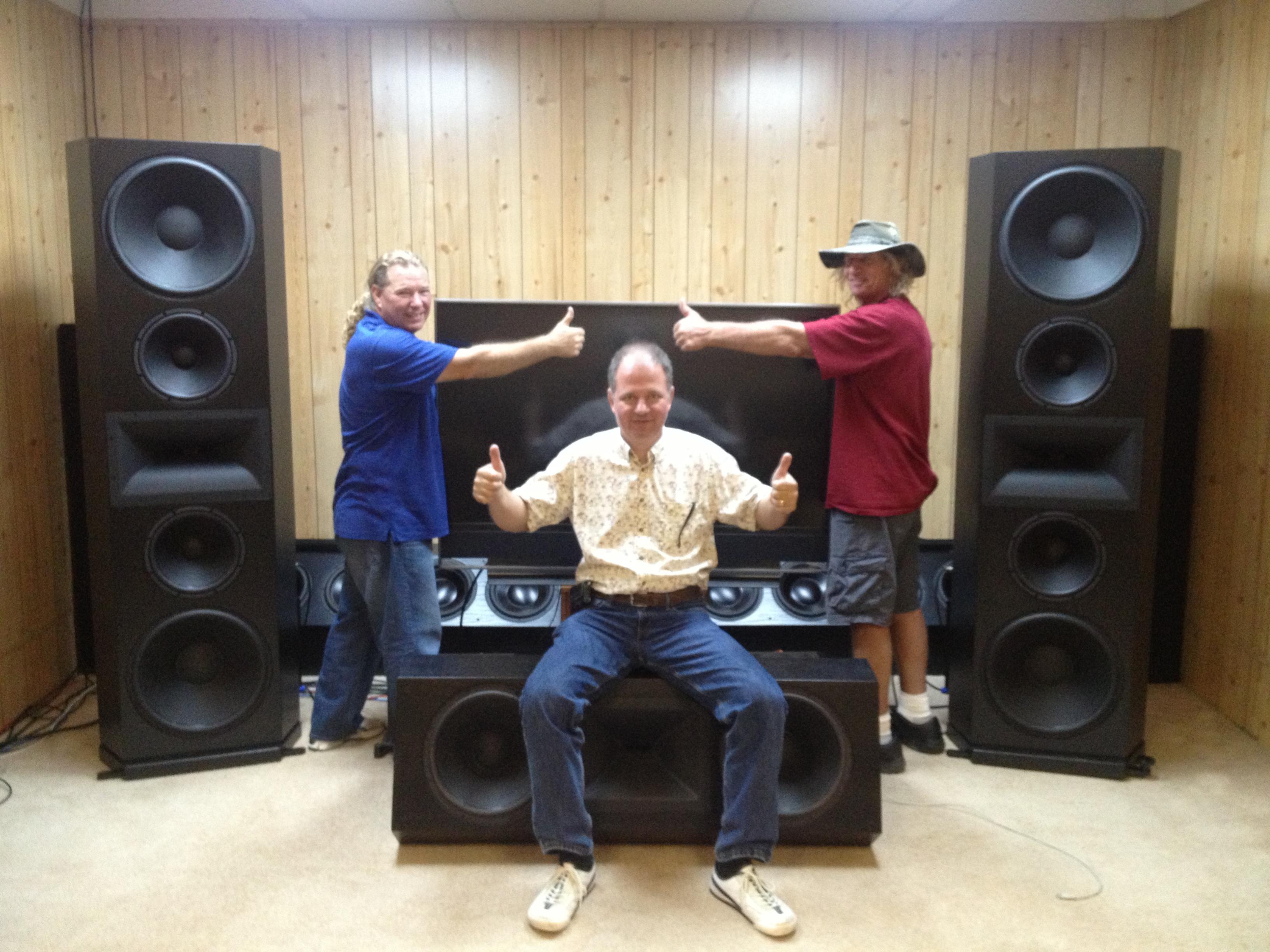

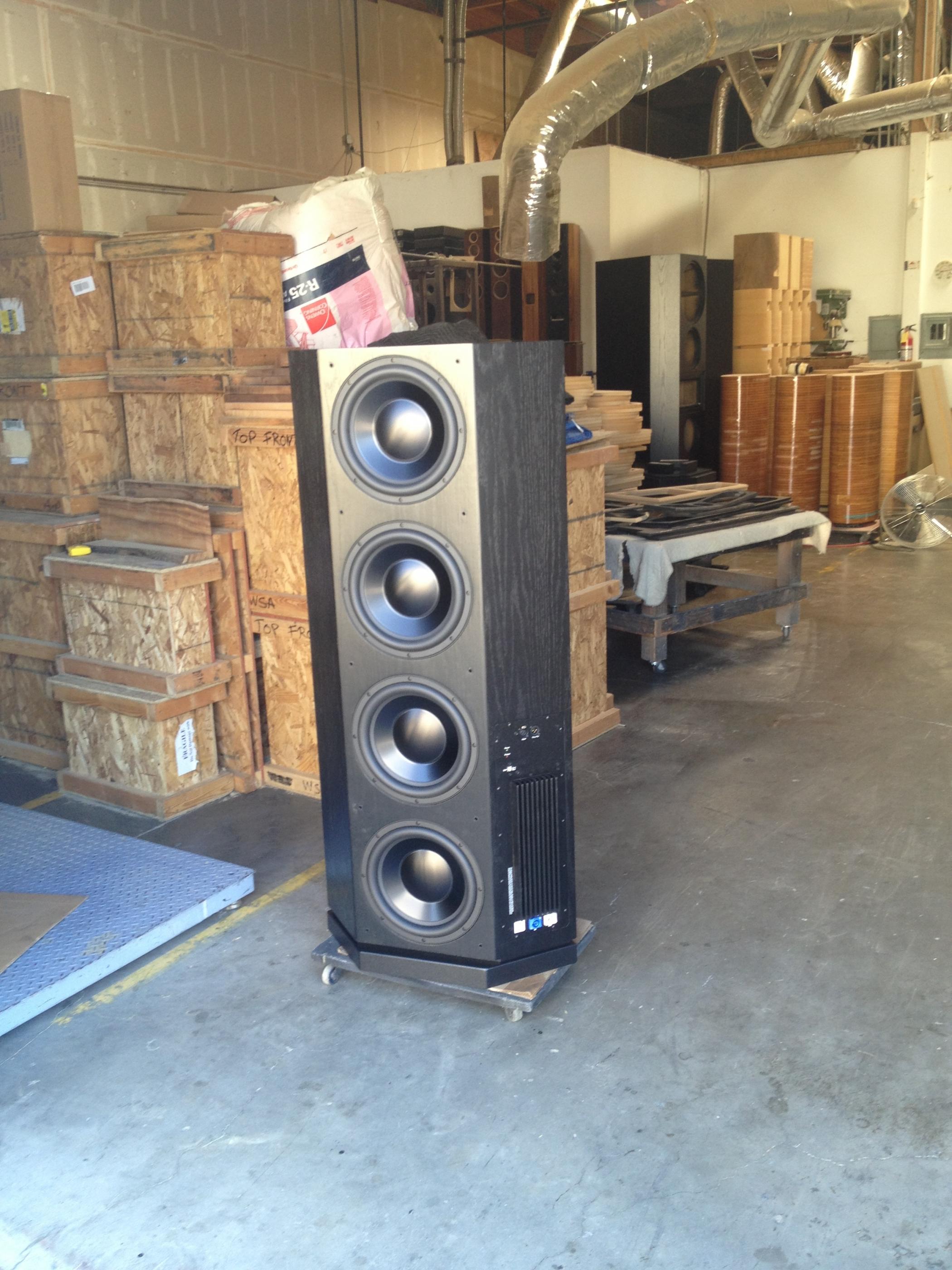

This is how we did a "cost no object" system, pictured is only phase one in a temporary setup. the subwoofer towers are to be placed in the corners of the room, one in each corner. Phase 2 will include 4 additional subwoofers to be placed onto of these.
Amplification is 2 x 1000W per Subwoofer, or 1000W for each 2 12" drivers, they are DSP programable.
On the front speakers the 18" woofers are also driven by a 1000W module each. upon completion the system will have 20kW for LFE alone.
Good Listening
Peter
