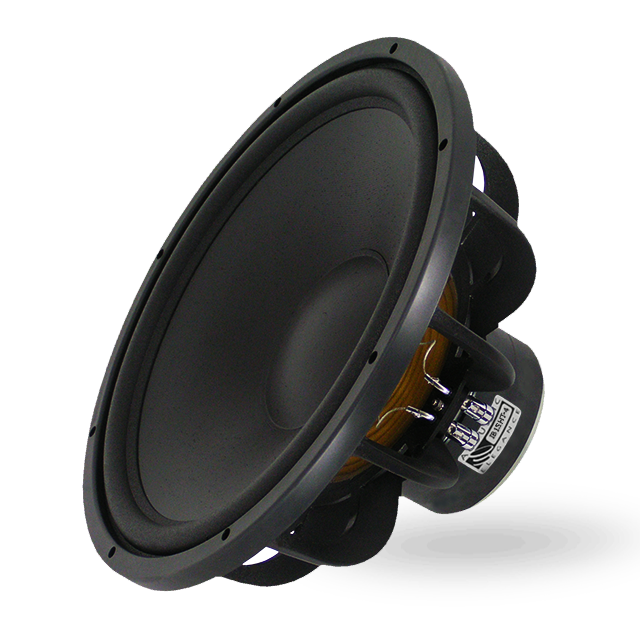

I would make an adjacent 2 meters by 1.2 meters room (5,000L/6.5c.yards) for each IB15 driver and make a ruler flat sealed speaker to the infrasound (F3@15 Hz). 🙁
