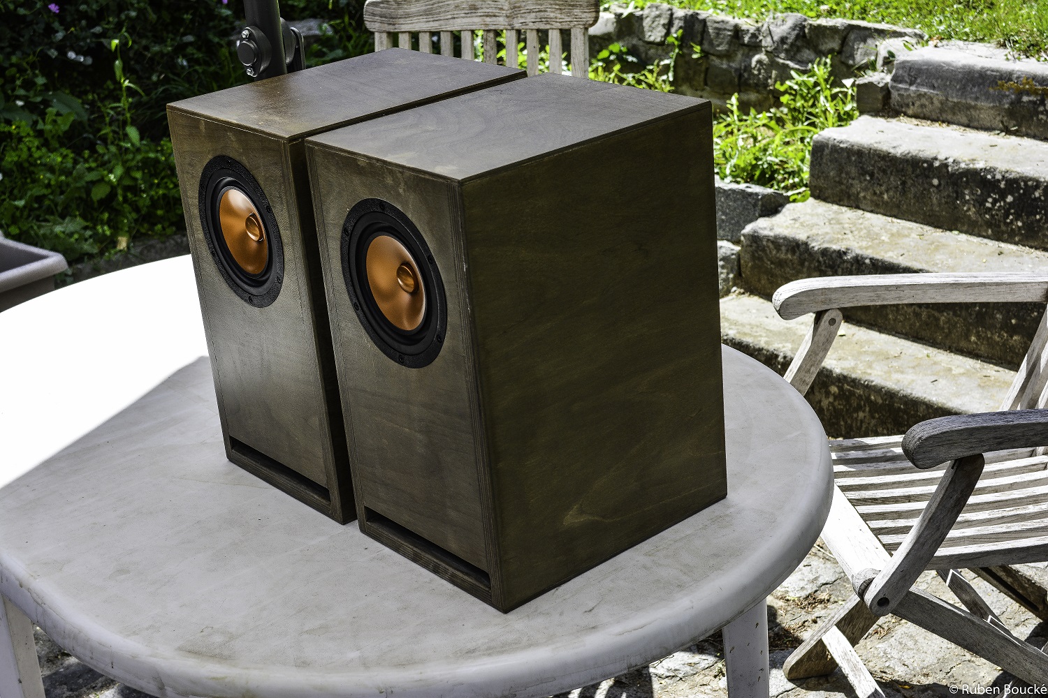

But on the other hand, my own design Mark Audio CHN110 MLTL does play dub (even more demanding for bass) rather well on low and medium volume, in that sense that i don't feel the need to switch to my waw for those. It's only on very loud session that the waw setup is needed. I used a Mark Audio Alpair 10.3/Scanspeak 26W8534G00 in sealed boxes as waw. But i don't have plans yet (i suck at cad drawing), and certainly no flatpacks. I thought Dave (Planet10) got plans of his above that you can ask. There is also an interesting design by XRK971 that is very documented (but again no flatpack or kit): 10F/8424 & RS225-8 FAST / WAW Ref Monitor
I thought Scott got a very similar MLTL as mine design for that CHN110 driver i mentioned and for many others that also give good bass on low power (ask him). If you can find a carpenter to build the cabinet for you, you can still do it. Your budget could allow to pay for that as Mark Audio drivers are not that expensive, and you don't need a crossover or a second or third driver for this.
With this you may have to get a lower power amp to be comfortable (on the volume knop). My 32w tube amp is already way to powerfull for this MLTL in a 5x3.5x2.5m (yes i live in the metric world) room. That should be something like double the size of yours.

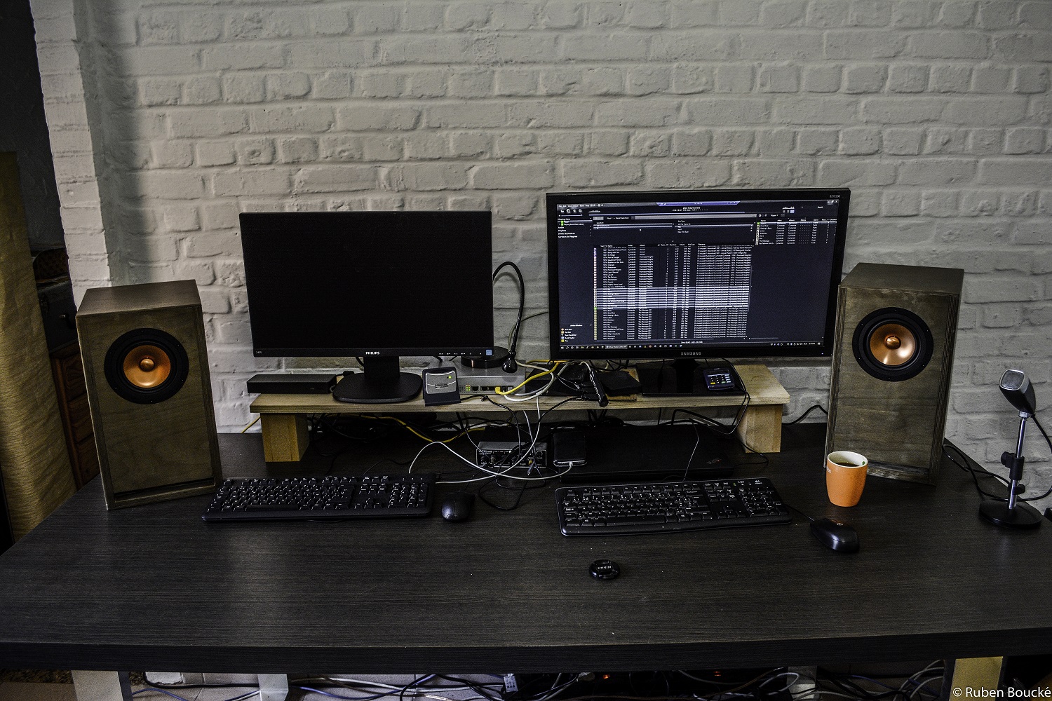

If you want a bookshelf, you will loose some bass, but there are designs that still give a lot. My design used in my homeoffice goes to F3 of 45Hz clean with a Mark Audio Alpair 10.3M driver, and that is lower than many multiway bookshelfs. Dave and Scott can you also give other plans (but no kits i thought). Off this bookshelf a friend made a cad drawing so that i can give you. But this was made to let the wood be cut with a CNC, and i guess you (or your carpenter) will also need a CNC machine to cut those... But to get an id you can still look at it. And it's free to use.

The mark audio drivers in the mar-ken trap boxes are great sounding speakers bass down to 40 -3db clean to 45 on stands. Play pretty loud but at max (ear hurt level ) volume will bottom out. That may be my fault I may not have enough clearance behind the driver. I do not know if with electronic music will have the bass slam you are looking for. That being said the imaging sound stage are very good.the sound is very clean and the fr is quite good. The ones I build are Mar-Ken10.3T stand mounted speaker.

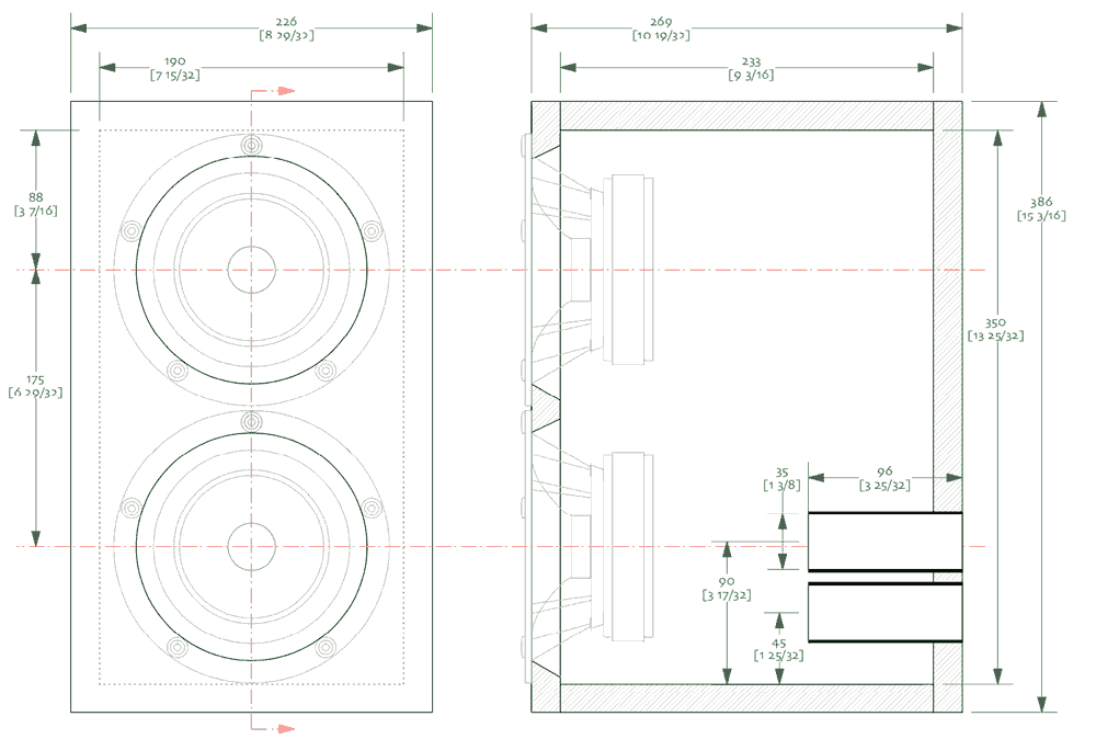

I am not meaning to steal the thread and would like ask Dave a question. and dont want to start a new thread
Dave I have a quick question I followed your link to scottmooses thread and saw a stand mount speaker with two drivers. Can I add a second driver to the marken 10,3T the reason is when I built them I glued the baffle upside down on one of the speakers. the sound is the same but I would like them to match. adding a couple of drivers would be easier than building a new box. I am using the metal drivers. Or would it affect the sound. thank you

Yes. A 2 driver version is doable, it was done for A10 and A10.2, have to chack my drawings to see if i have done or started a twin. CGR? Rectangle? Trapezoid?

Thank you Dave these are the Mar-Ken10.3T stand mounted speaker.trapezoid on the planset it is page 66 should I follow the filter options for two drivers in the planset? thank you again. I have been doing more critical listening and they really are quite remarkable.

Thank you Dave lets hold up on that. I wanted to know if it could be done I am debating a new cabinet vs buying two more drivers. Is there any other benefit like less excursion? I wont be able to do any woodworking for several weeks. (broken ankle) thank you for responding now that I know it is possible I have more options. thanks again
Same LF response, 2 cones at low frequencies, 3 ways to wire with 3 different compromises.
http://www.planet10-hifi.com/downloads/Dual-Driver-Wiring.pdf
