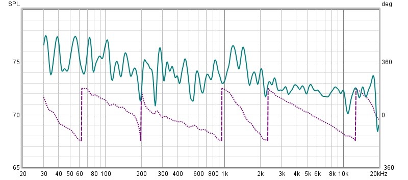

I have just built DSP active speakers with Faitalpro 12PR320 plus HF108 with horn. Very decent drivers. Above 1m in-room (non anechoic)
measurement.
