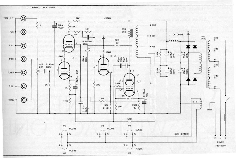

I need to draw out what I think you have written so I can get my mind around it. Though it's purely academic as I have no ability to wind OPT. Though I would like to build a second EAR859 amp at some stage.
My venerable and much modified EAR859 amp has EL509 output tubes. Tim de P wrote that it has a 4.8K OPT, and I'm sure (at a hifi show in Buxton UK many years ago) said it had 13 winding sections.

If you post the drawing I can check it.Thank you Ciro,
You are very generous.
Can you also post a schematic for your amp? or at least give me some info about output stage current and internal impedance?
So I can pick something close enough 😉
The EAR 859 schematic was published in a hifi magazine. So I think it is legal to put up here. Else just google EAR 859.
The pdf: http://www.jogis-roehrenbude.de/Leserbriefe/Synola-509/Paravicini.pdf
