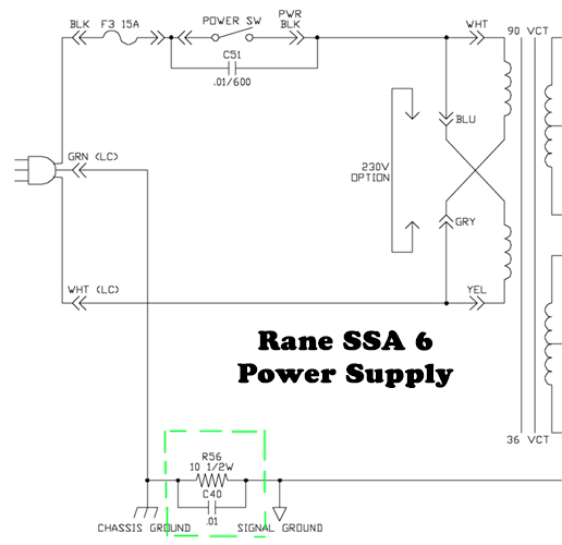

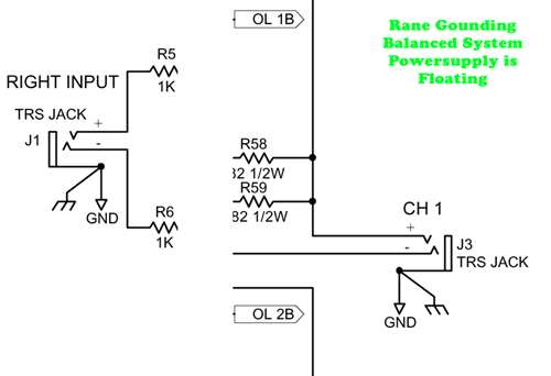

I've mixed up some of my schematics. . .
My DC power supply for testing has everything tied to earth ground.
Most of my audio equipment is using a floating ground.
Some of the Rane equipment has a ground lift switch to allow
signal ground to reach earth ground through a passive network
or not connect to the earth ground. But the chassis is always
connected to earth ground in a three prong situation. The
signal ground is it's own star or bus.

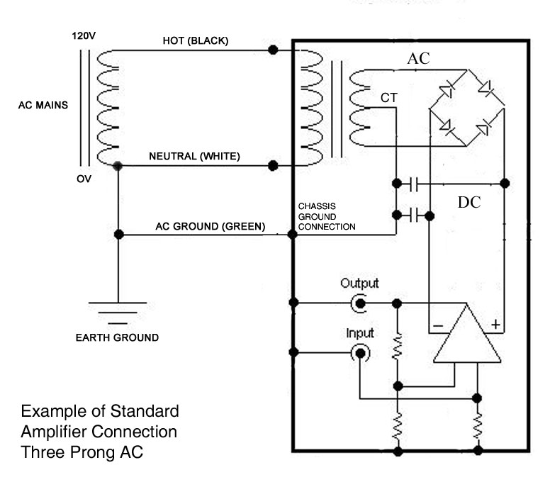

Grounding Diagram
I guess we can talk about the same thing if we look at the same
diagram. . .uploaded is a diagram of a power supply with some
numbered switches. . .
Potential unsafe mains schematic removed.

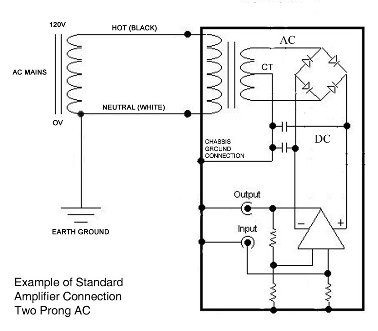

the diagrams in post 36 and post 37 are absolute balderdash.
Any manufacturer offering that solution should be strung up.
And you suggesting they are "standard" compounds the error.
AndrewT said:Hi,
I agree that as drawn there are issues with the schemes presented. The picture translates to using the chassis as a plane type ground for all supply-input-output-safety grounds. the results of this would be a problem to stabilize and the resultant sound would be two-D and congested. There is no way to eliminate interference between the various functional blocks.
I wonder, having attempted to present such diagrams in the past, what the true intent was. I am also curious to examine the correct approach to component grounding.
Andrew, can you post a link to the descriptions you mentioned as being a guide for your efforts? I've been to the Self site but other than references to grounding and cabling diagrams I do not find the overall approach that you mention. I've built a couple of chip amps to experiment with and this input would broaden my experiments.
Regards, Mike.
