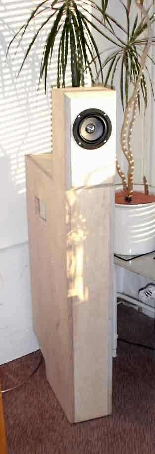

I tried the Mark Audio Alpair10P. It is a very nice driver but not to my taste. What was really shocking was the bass F-R. I had to measure it twice to be sure of my readings. Measuring 3 ft away with one speaker only and then at the listening position 9 ft away with both speakers. F-R was about the same except the 100-200Hz range.was elevated 7 dB at the listening position. Maybe due to the flat cone design have better dispersion in this area? It also seemed less punchy than the Seas.
I have tried elevating the bass response with different tone controls and DAC with eq. but anything above a couple dB boost, bass gets slow and muddy. So it's a matter of finding the best compromise.
The other issue about the bass was that my cabinet was too big. While getting more bass below 50Hz, the larger cabinet produced way too less bass around 63-100 Hz. Just going to a correct sized cabinet gave more balanced bass and not so bright sounding overall.

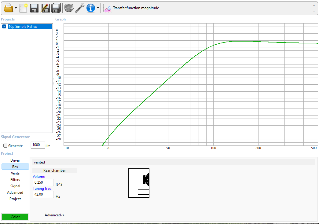

Yes is vented with a 1" dia x 4" long port. I calculate 42 Hz.If that's a vented box, it's too small IMHO. Vent diameter & length?

Pretty much bang on. Doesn't look great, but there isn't a big bump above 100Hz. You have your speakers jammed up against the wall?I calculate 42 Hz.
Here's a sim.
Thanks for the sim. Nice to see some correlation. No, they are 50" out. Sounds kind of strange but in my small room I actually get a good combination of bass and sound-staging.You have your speakers jammed up against the wall?

Box is 12H x 7.5"W x 10"D. Not sure about the internal distance if that is what you are asking.how close is the back wall of the box?
