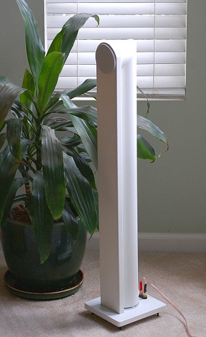

Sibelius or NSMT Bossa Nova
The first uses a 5.25” driver and should be near your low frequency target, it is a folded ML-Voigt.
The second an end-loaded pipe (3” ABS?), probably a 3” driver, line too restrictive and, for the driver, too long. They sensibly specifity F10 and F6 which are much more useful numbers for figuring how low they go, -3 dB is a meaningless thing to the ear/brain (ref Toole).
Frugel-Horn Lite, uses 3” drivers and gets to something like 60-65 F6, Frugel-Horn XL with suitable driver meets your LF needs, uses a range of 5.25-6.5” drivers.
Not many 4.5” FRs, the FF125wk, FE126 won’t go that low comfortably…

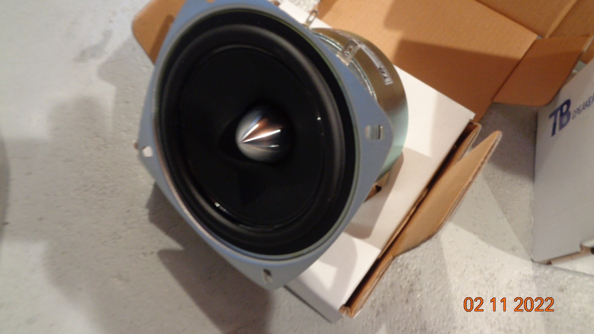

Right now is
Tang Band W4-616SA
Considering
Tang Band W4-1879
and
Tang band W5-2143
Leaning to the W5 as I have not liked TB's bamboo or neo motor or long throw drivers. Also prefer smaller Xmax although 5" is worse midrange. Best IMO is ferrite with C37 paper cone.

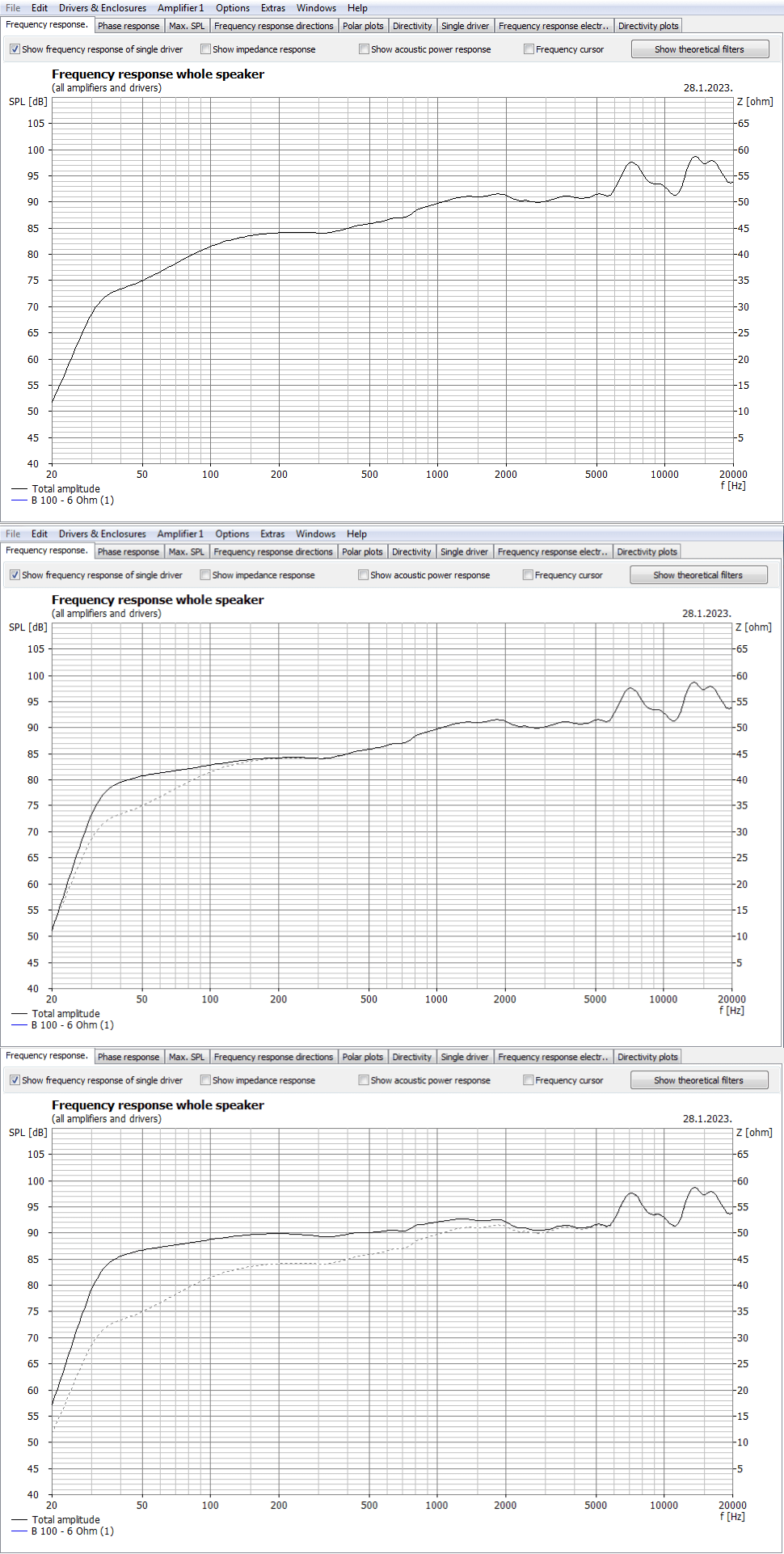

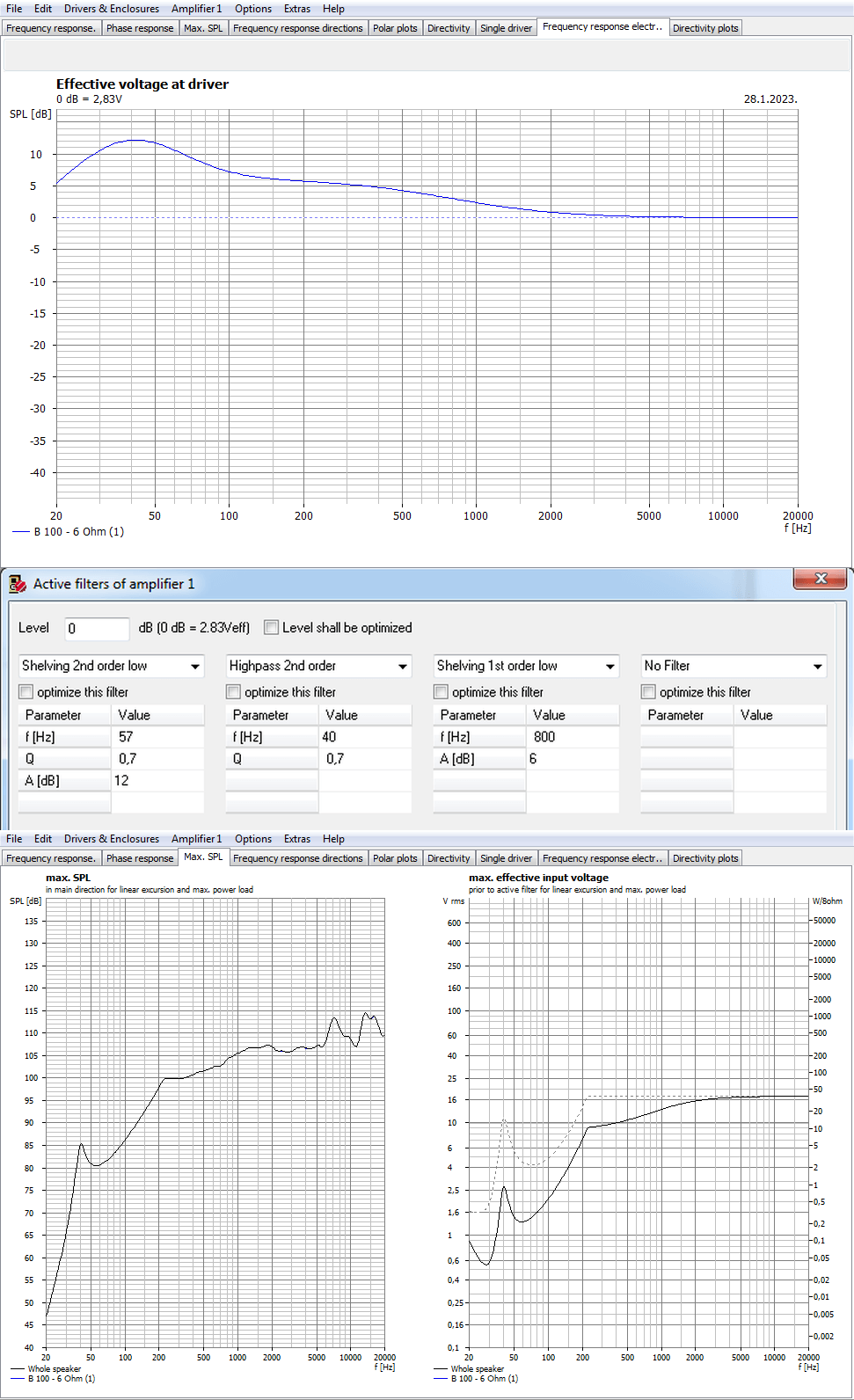

Try this way:
-Vb should be equal to closed box with Q around 0,7
-Set the Fb to around 0,5 Fs
-Add active shelf LF boost. 2nd order, Q=0,7 , centered between Fb and Fs
-Add active high-pass, 2nd order, set at Fb to protect the driver below Fb (important!)
-Add desired level of BSC
I made some sims in Boxim with Visaton B100 4in FR driver to show this.
7 liter/0,25 cu.ft. vented box tuned to 40Hz with 15x25 cm front baffle. Free space.
First graph is driver only response.
Second is response with bass boost.
Third is response with bass boost + full BSC.
Fourth is electric response from filters
Fifth is active filters list
Sixth is max SPL and driver input voltage before Xmax
You should be able to replicate this with DSP.
Note that with all the active boost max voltage at driver terminals in working range drops to 1,3V or 1/4 Watts at drivers 6 Ohm impedance.
Still, over 80dB is possible before Xmax.
