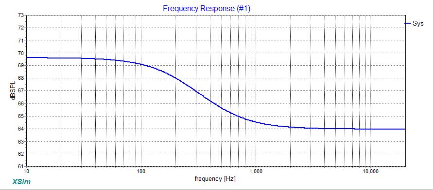

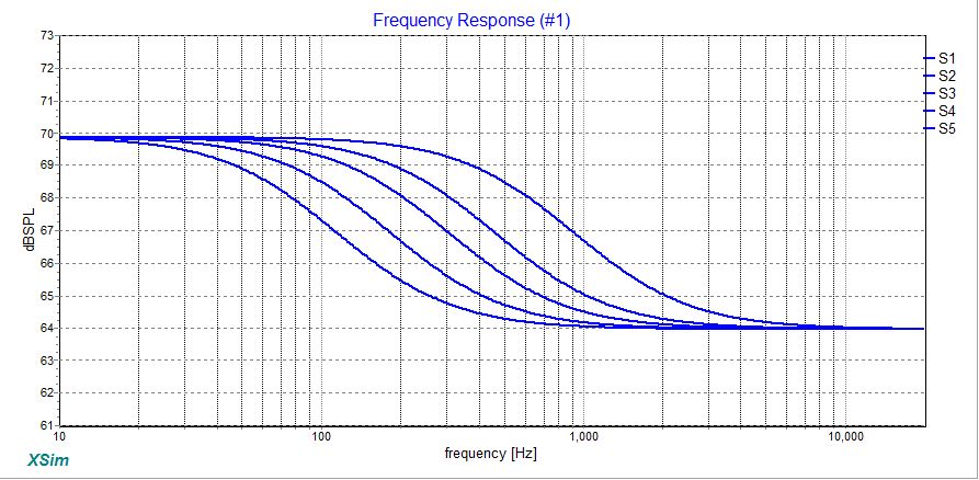

So you use the same 8 ohm resistor and vary the inductor? I thought notch filter had a dip in the middle and the HF would remain unchanged. But your graphs do not look this way.I've made a range. Here all have 8 ohms. Right to left... 1mH, 2mH, 3mH, 5mH, 8mH.

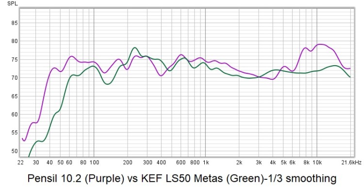

I did some searching of F-R. First i was told by one person, the Pensil-type designs will give about 5Hz deeper bass compared to conventional box like the King of Swingers and it will sound more natural.
Page 5 for Alpair 12 - 8" driver shows is good to about 60 Hz / dies at 50Hz. So the Alpair 10P would be less.
Pluvia 11 4 1/2" cone is good to about 125Hz.
RVB Precision BUILDING PENSIL 10.2 SPEAKERS had these graphs
So it was no surprise the builder said "The bass was a bit more than I like. Stuffing some Poly-Fill into the bass slot calmed it down perfectly." Sounds like a lot of work doing trial and error.

This is a shelving filter, not a notch filter. The highs level out like the lows, with a step in between. I have exaggerated the jump by stretching the Y axis so you can readily see the frequency of the step.I thought notch filter had a dip in the middle and the HF would remain unchanged
The resistor affects the level of the step.So you use the same 8 ohm resistor and vary the inductor?
