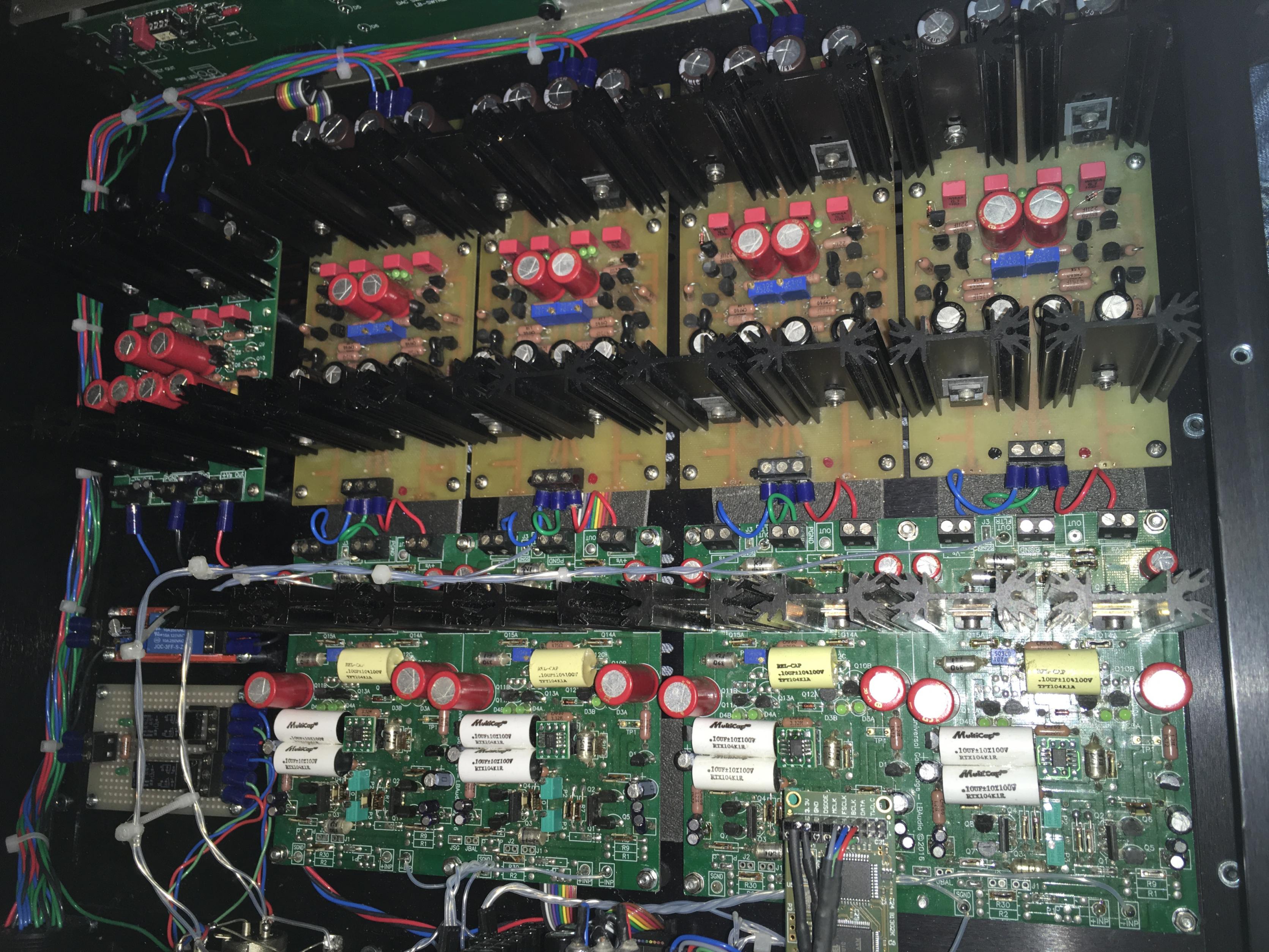

With 8 x 1704K I have 4 Borbely discrete jfet IV stages , it also acts as the output buffer with 85 ma bias on the output mosfets so just a single analog stage for each phase. 10 discrete jfet shunt regulators and the dac board ( not in the picture).
Uses 2sk389/2sj109 , 2sk170/2sj74, 313/2013 mosFets - all the hard to find parts.
over 50 Blackgate caps, teflon caps, nude tX2575 Vishay, silver wire, everything I could find that flat earthers think is a waste of money. With Highdef downloads it’s very , very nice.

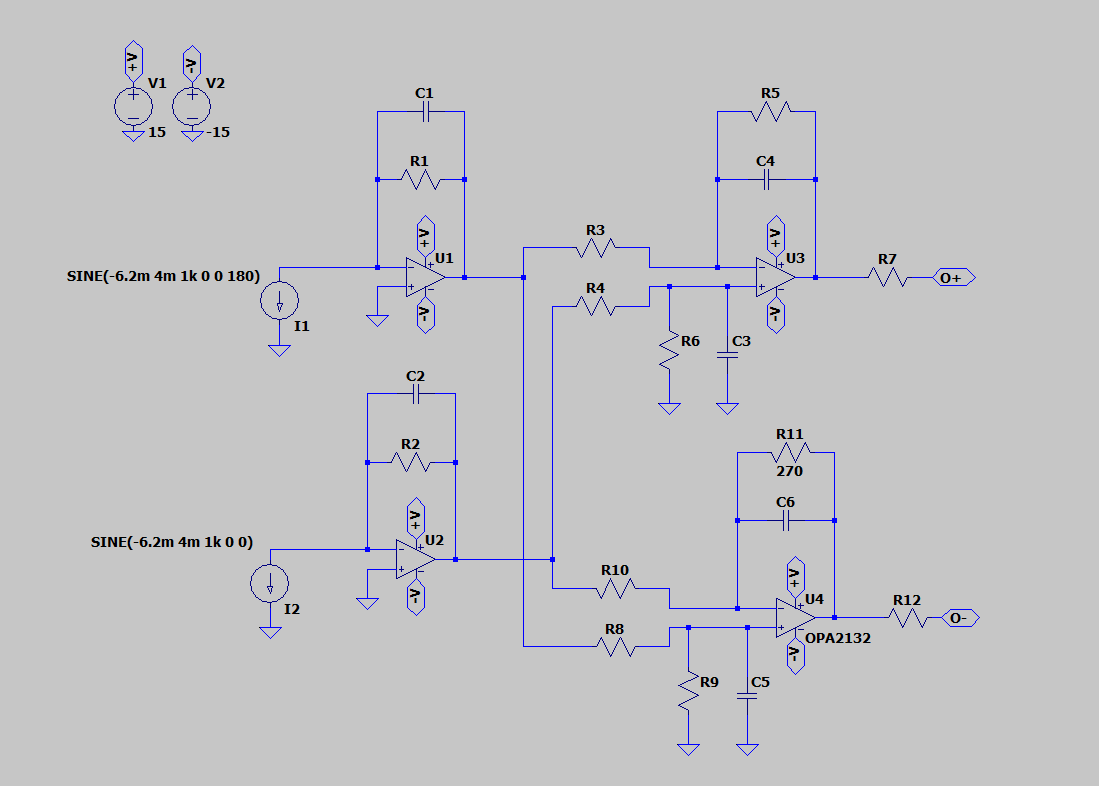

So how about current output multiBits delta-sigma DACs? What shall we look at when choosing the I/V stage opamps? All newer DACs are based on this architecture.
For example, what slew rate and settling time should be fine? All the discusses at the beginning of the thread are focus on older DACs.

The true current OP PCM179x family have *very* fast current step rise times. Effective RF energy way >100MHz. The newer unity weighted resistor
architecture DACs appear to be less demanding WRT OP edge rates but more
demanding WRT lower OP Z.

Just introduce a new option for this.THS3491. CFA.Very high Transinpendence and very fast. If you can accept the distortion of LMH6172, it can be considered.
The classic AD811 still have no alternative at this moment. LME49713 has been discontinued.
A big problem of the new dacs (say es9038pro, ak4499eq)is they have very high output current,which is good for SNR, but makes harder for CFA ops for I/V stage,since they may need a relatively big feedback resistor value which may cause Vout running too high.

We found AD811 didn't sound as good as other options and yes, it was correctly
bypassed. The problem with CF opamps for I-V is that if you wish to place the
first pole of LPF around I-V opamp, as is the usual practice, it will require
an additional resistor feeding into - IP to retain stability. Adding this resistor will
increase the distortion and CF opa's already have higher distortion than VFB
OPA's.
