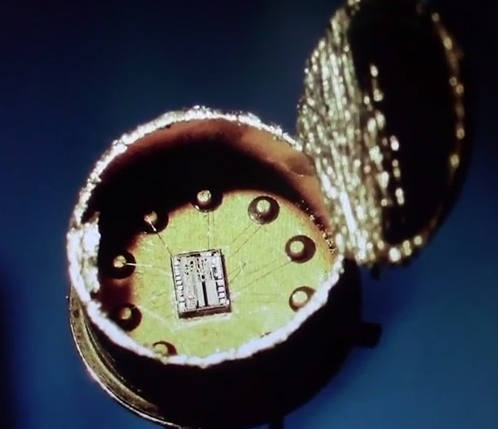

Nick,
There is not any fluid of any kind inside the LME metal can HA devices. In fact I have never seen that in a metal can device before. The Bob Pease comments, that I listed in my last posting, are the most likely reason for the improved / perceived audio improvement of the cans over the dip/SO packages.
abrayalito,
Here is the excerpt from my last posting describing what an actual Faraday shield is...
Faraday shields include both electro-static and electro-magnetic shielding techniques.
Best Audio Regards Everyone,
audioman54 / Mark
The jpg of a metal can with its top cut-off attached... the small, thick metal cylinder, with the rigid, extruded top & the thick bottom metal plate, PLUS the way the IC die is connected to the pins should definitely make that die less prone to mechanical oscillations, compared to plastic and even ceramic encapsulation, so I tend to disagree with you when you say that immunity to mechanical oscillations has nothing to do with superior sound of metal can IC’s, compared to their plastic / ceramic siblings.
Nick
