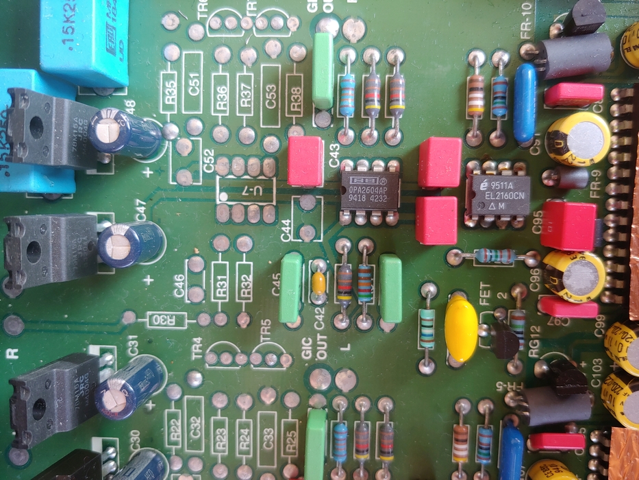

the OPA2604 was installed at the factory (it's a monarchy 22B unit) to perform the I/V and was wondering if there was a simple drop-in option for upgrading. Don't know which other op would suit

if you can, drop the I/V shematic and photograph of this area of your DAC and what is after till the RCA output.
It will help people to help you more. It deserves a dedicated thread. Your oap is a dip8 but there are also adaptator pcbs for soic smaller casing oaps for them to stack on a DIL8 area. In the Miro1360 thread about ad1862 dac chip you can find free gerbers to make them printed by a pcb maker, they are cheap nowadays. And mostly you willl see the best oaps from today discussed in the thread.

Easy to start with a couple of shot. No I/V schema or any schematics of the unit are available, I'd just have to trace it on the board.

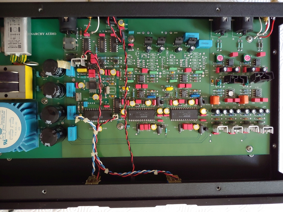

P.S.: As of today audio signal is taken directly from GIC L and GIC R, bypassing the whole right board.

Notice you certainly have with the EL2160 a bipolar single chanel oap for the I/V task. I'd keep them ! Monarchy was a good brand and they know what they did.
Forget perhaps what I have said. you can try JFet oap as well to swap the op2604 (perhaps filter task here ?) next EL2160 stage. Can try a soic opa1656 or 1646 on a DIL8 adaptator or of course a DIL8 oap.
So you mean that the right part of the board behind the output plugs are for XLR only and the RCA are bypassed from this stage ? Or you btpassed it ?

Swapping the OP IC's will not bring any major improvements.
Ther are 3 areas that you could focus on (pretty much the case with any DAC):
- have a look here, Lundahl is used with a Cadoc as an I/V, with PCM63. This will sound better than IC's... DAC by Armonia Hi-Fi
- There are 3-legged voltage regs on that PCB that could be replaced with something better, like LT3045 direct drop-in replacements (pending the Vin and Iout/Pdis are within the acceptable level)
- there is an Xtal oscillator there as well - you could try a different oscillator with very low jitter and phase noise.
The above will bring marked improvements to your DAC... but require time and money... Is it worth?? sound wise - yes; return on investment?? probably not... you may be able to buy a consumer DAC (just for the cost of mods alone) that will sound good, but will give you USB in, DSD/PCM options... and then you can try HQPlayer with it... it could be a revelation...

Ops, go figure I thought the 2160 was operating as a current buffer...
Seems more likely its doing I/V duty here. I downloaded its DS, the weakness of this part in this position would seem to be its too noisy (5.1nV/rtHz voltage noise).
I'd suggest another CFB opamp to substitute but a quick calculation shows even AD811 - with much lower voltage noise - would be more noisy in practice due to its higher current noise (20pA/rtHz). Noise seems to be an issue with all CFB ICs in this application.

@E-bokys....the jrc 3 legs are good enough if you lower the impedance at its output and decouple it at its input by a low esr cap. The output cap seems blue Elna that has not so good esr which is what you look for here and you can even degrade it by a serie resistor of a very low Z. But having aged the Elna should be ok if at the output.
There is way better than the caddock at this task and being important it is less than oaps from what I experienced.

Do you think the op1611/12 could suit instead despite it needs a lossy soic to dil adaptator ? Then for the opa2604 a 1656?
OPA1611 might suit yes. Its lower noise than the Elantec but not as high speed so might run into slew limiting at the DAC transitions. I'd prefer an OPA1642 to the OPA1656 due to lower low frequency noise. I found its poorer sister (OPA1678) too bass light for my taste but haven't listened to OPA1656 myself.
