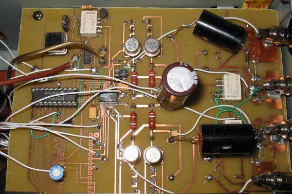

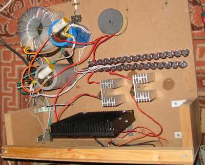

I have save this text and attachments:

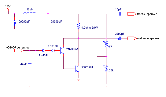

A Power DAC (simple two-way I/U converter for AD1955)
This is a hifi design using a minimum of components in the signal path. A DAC AD1955 is used and the current to voltage converter will be the power part. So I modified a CD player and made a DAC board equipped with the AD1955:
and used and external case for the power part. It uses a class A current to voltage converter able to deliver 1W per channel, enough for horns. A PIC decodes the the infra-red commands and ajustes the digital volume in the AD1955:
Analog Device recommands a 2.5V voltage at each AD1955 current output. Two 1N4148 diodes and two transistor bases make this voltage. The feedback is ajustable and set the bias current and the gain. The high frequencies are naturally filtered by the limited bandwith. A PI filter has been necessary to get a perfectly silent amplifier.
Use: I am using this amplifier from 120Hz only, a conventional active crossover and amplifier are used to get a higher power output for bass.
