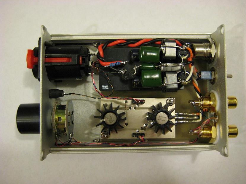

I built a headphone amp using two of these that was powered by a DC/DC converter. No RFI problem that I could tell; excellent sound.
