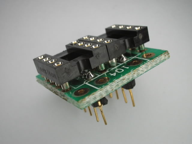

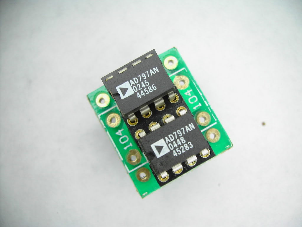

Anywhere here on diyaudio exist a thread, how I can make a small PCB for two single OP-AMP appropriate for testing in a socket for a dual OP-Amp. Unfortunately I don't know the headline and the aera, where this thread is filed.Well, at least we don't have to compare vintages! My layout only supports dual op-amps, so the OPA827 can't be tested on my current platform. It would be fun if they made a dual.

ckeck ebay Item number 220677386848 (dual inline) and 370351701454 (smt/smd so-8) so as follow URL:
Browndog Single to Dual Opamp Adaptor Page

for the adapters, the browdogs are about the most expensive and worst implimentation of this idea, the most available for sure, but we are on DIYA here. I suggest checking out the boards by DIYA member peranders of sjostromaudio.com he has produced a single soic8- single dip8, a 2 x single soic8->dual Dip8 and dual soic8 to dual dip8. all provide ample positions for decoupling the power supplies right there on the adapter.

I have now found the URLs:I suggest checking out the boards by DIYA member peranders of sjostromaudio.com he has produced a single soic8- single dip8, a 2 x single soic8->dual Dip8 and dual soic8 to dual dip8. all provide ample positions for decoupling the power supplies right there on the adapter.
http://www.diyaudio.com/forums/group-buys/166811-group-buy-so08-dil08-adapter-adp0r0.html
Group buy: ADP05 SO08 to DIL08 adapter - diyAudio
sjostromaudio.com - ADP01 ADP02 ADP03 ADP04 High End SMD to DIL adapters
yep, thats the ones, much better than the browndogs, only thing is you still have to supply the DIL pins. I have a heap of the adp01/02/03/04 and use them regularly last night even, I have been thinking about getting some of the new boards too
