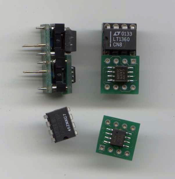

two different monolithic opamps on adapter
Nice to see this very old thread living again from time to time...
I have tried searching but ended up with nothing.
In advance I apologize for my ignorance, and if my idea is some kind of engineering blasphemy or so...
because I can not believe that no one came up with same idea before...
So I'm suspicious why nobody came up with combining two two different monolithic opamps on adapter in places dual opamps are used.
I beleive it was very common in many diyers favorite - TDA1541 based players, to use dual opamps for conversion and output stage.
I thought why not use AD844 in place of first opamp for I/V conversion and my favorite AD797 as second?
My friend has tried many combinations in his marantz 94 because in it's circuitry it's is already two mon.opamps per channel.

Your idea is not uncommon, at least not for me or in the CD63/67 mods thread 😀
I've been experimenting with lots of opamps over the last few years. My favorite combo is the AD8610 with AD8510 for my CD67-OSE at the moment. For a TDA1541 DAC, the AD797 is a nice one indeed, but I also like OPA211 and AD8597.
