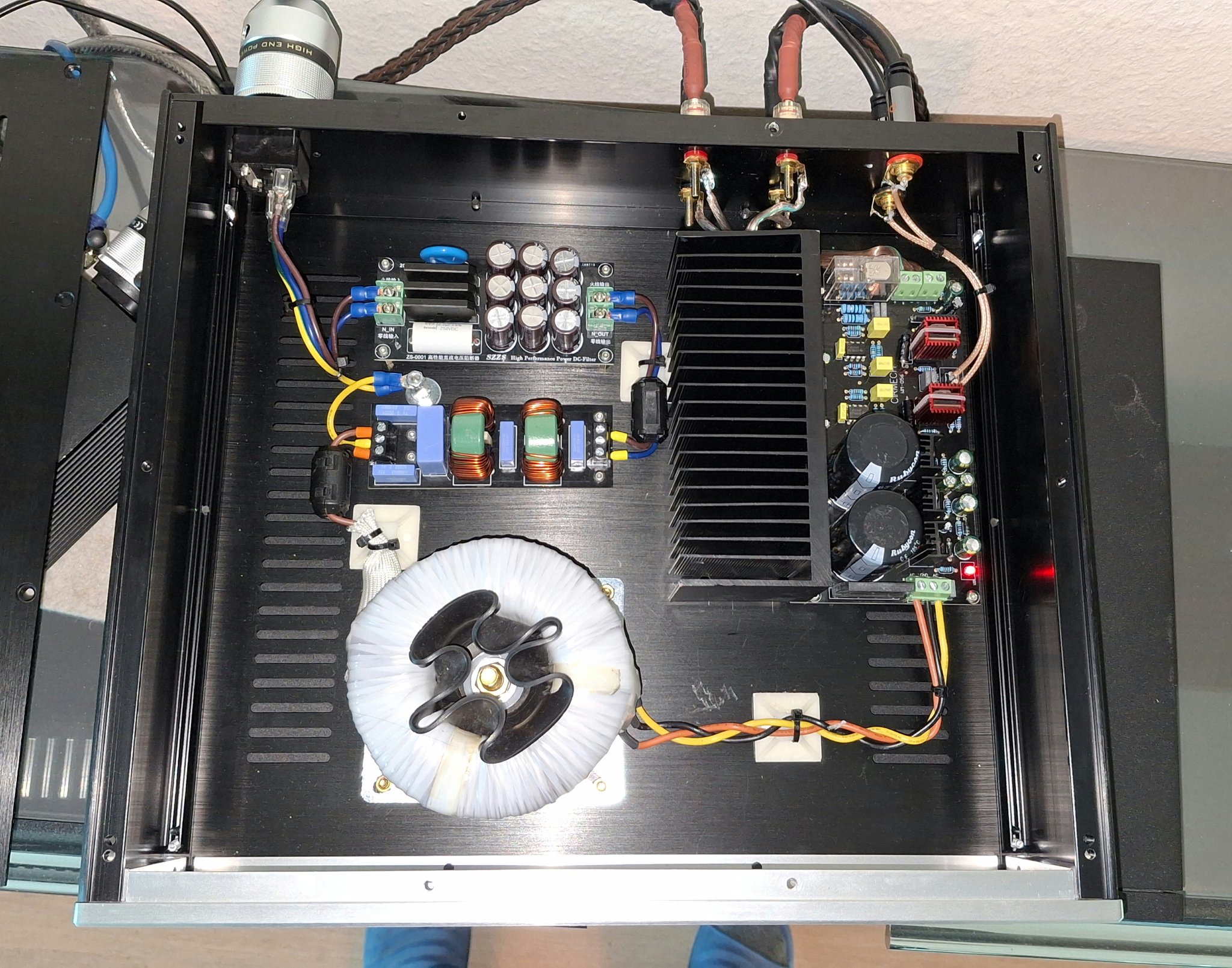

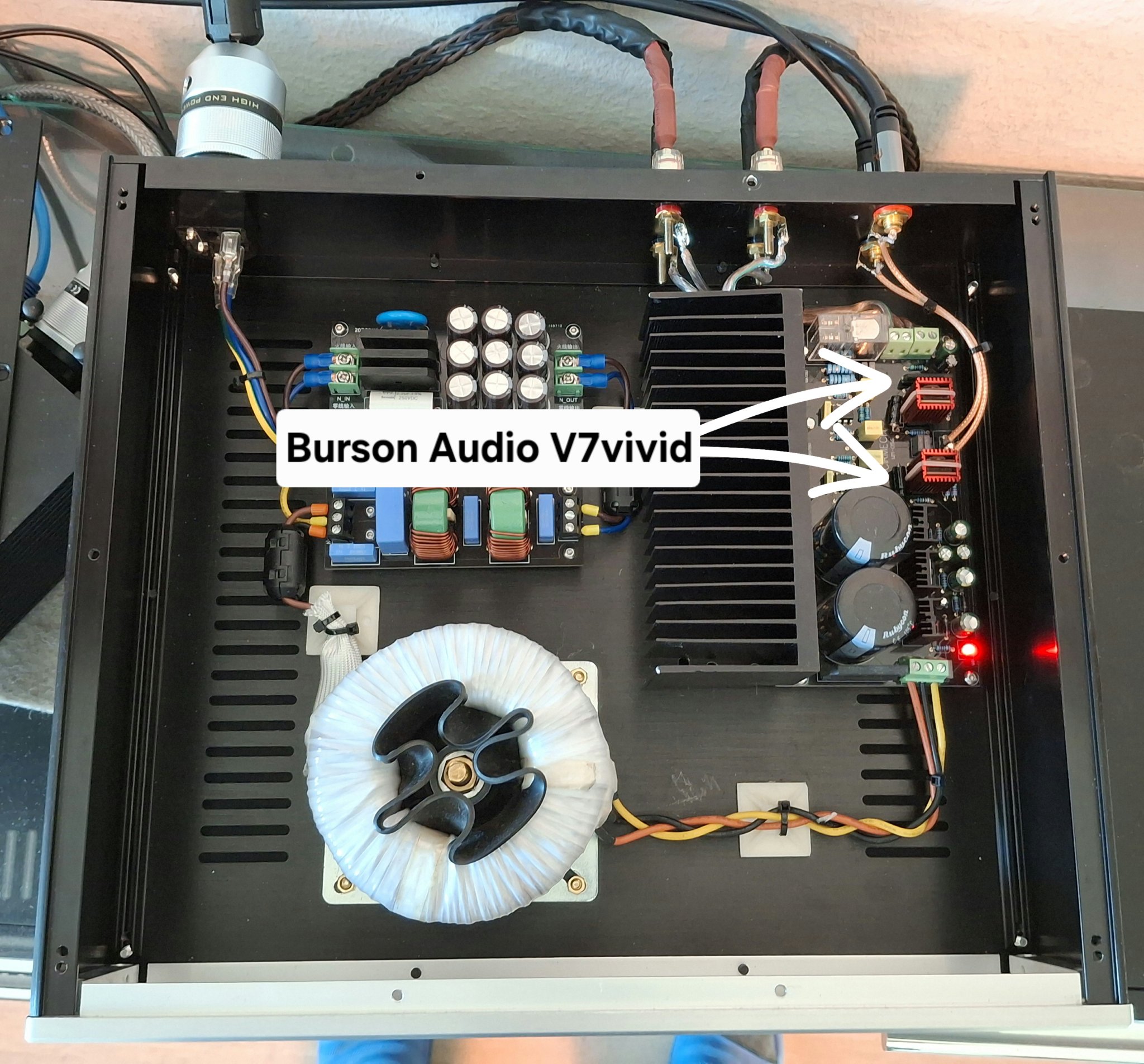

I built an amplifier with a Chinese circuit board (CRM-Tech, TDA7293, OP NE5534, and OP07 Servo). The sound was okay, but then I swapped the NE5534 for a Burson Audio V7 Vivid pro Single.
The sound is now significantly better.

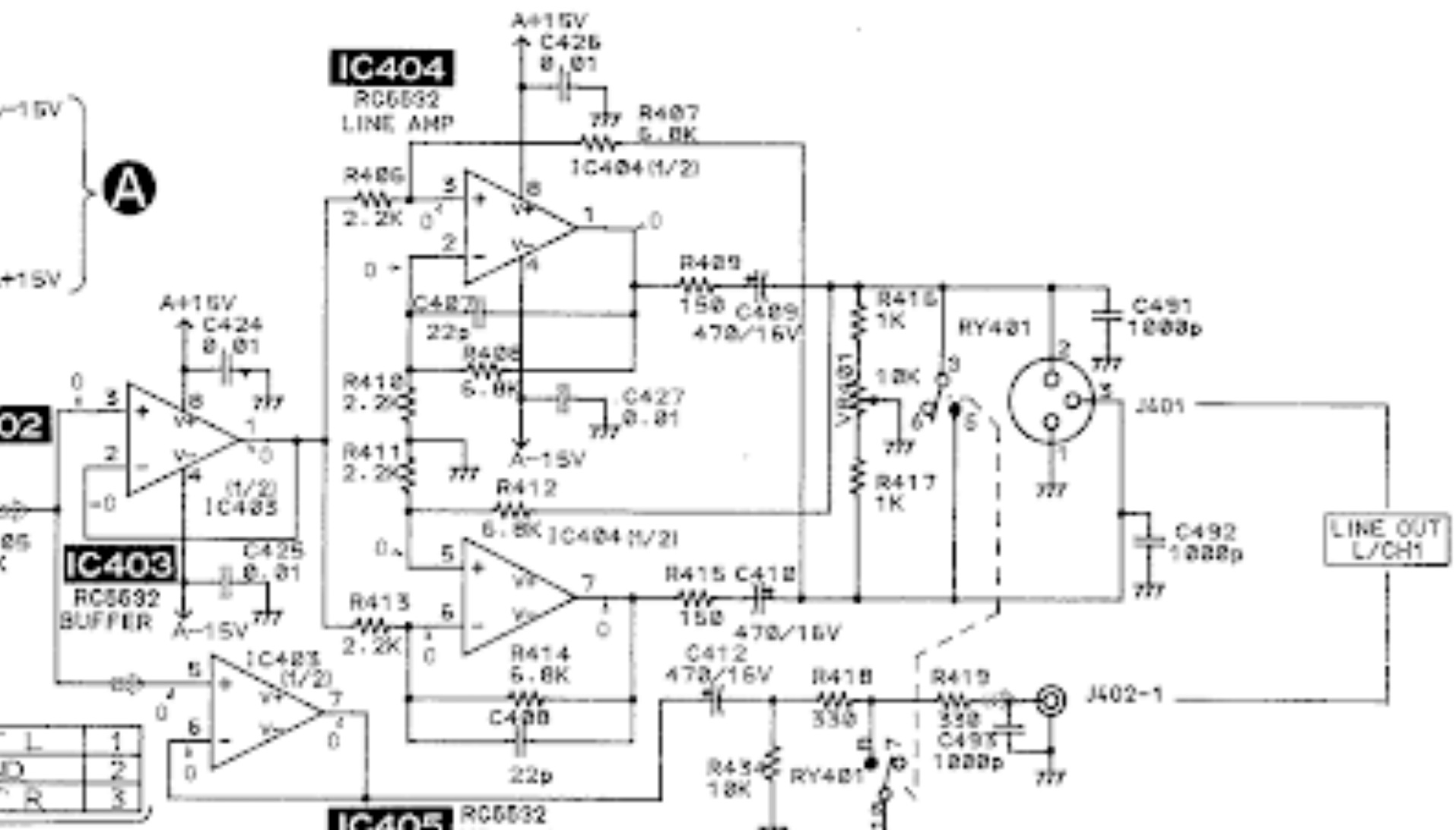

@IamJF I've built and tried various line driver output circuits with varying results. The separate inverted driver style circuit (very popular with lower grade pro audio equipment ie. Behringer, Alexis, Samson) has symmetry problems with input offset and hurts CMRR.
The closed loop matched driver circuit (pictured here below) performs very well with proper layout, carefully matched, low temp coefficient resistors and good PS decoupling. I've seen this circuit in Accuphase gear and other Japanese equipment. Its likely the best sounding circuit design I've heard, with and without an output transformer.

Can you quantify that or could it be comfirmation bias? Or that the original opamps were fakes?The sound is now significantly better.
I used the board from CRM-Tech. The components aren't fake. I've tried other op-amps, including the original NE5534N from Phillips and also op-amps from Texas Instruments, and they all sounded the same. The Sparkos SS3601 was good, but the Burson Audio V7 Vivid Pro Single made it a completely different amp! There are no measurements, but my ears aren't deceiving me.

I'm 55 years old and built my first speakers (Visaton VIB) 41 years ago, and my first amplifier with the TDA7293 about 33 years ago. I've been to trade shows, have expensive equipment, and know what a good amplifier sounds like. I've been listening to this amplifier for over a month, and I don't hear any increased distortion! However, I do hear the poorly resolved highs, the tighter, more opaque room, and the soft bass reproduction of the Naim. The Naim may be a bit more controlled at very high volumes, but overall, it completely fades and is more inharmonic than the TDA7293 amplifier with the Burson V7.
I use an Eversolo DMP-A6 Master Edition with an LHY linear power supply as my source device, and Elac Vela BS 404.2 speakers, Monacor full-range drivers, Visaton Solo, and Sonoro Orchestra Slim as my speakers.
The result was the same even with a different DAC (Fosi ZD3)!

No, what for... Everything's working perfectly.
I don't even have the circuitry for this board!
This board cost me €41. It was a coincidence that I put the Burson Audio OPs on it! But now they're staying put.
It is the V7 vivid pro single not a V6
