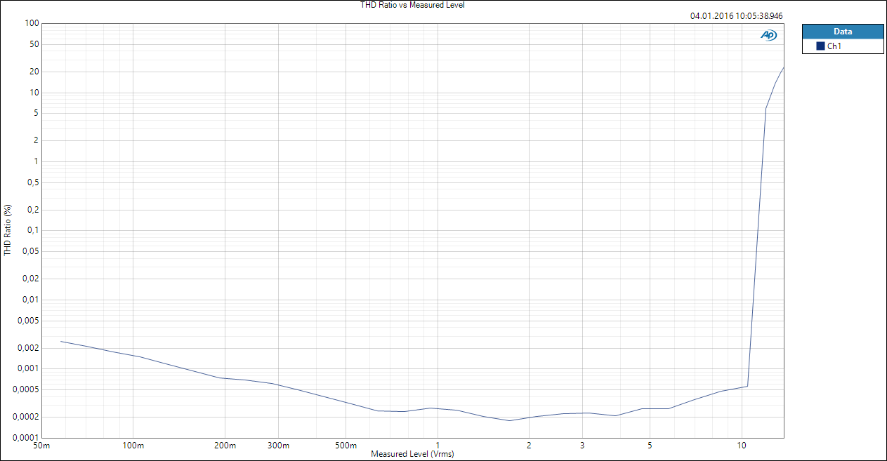

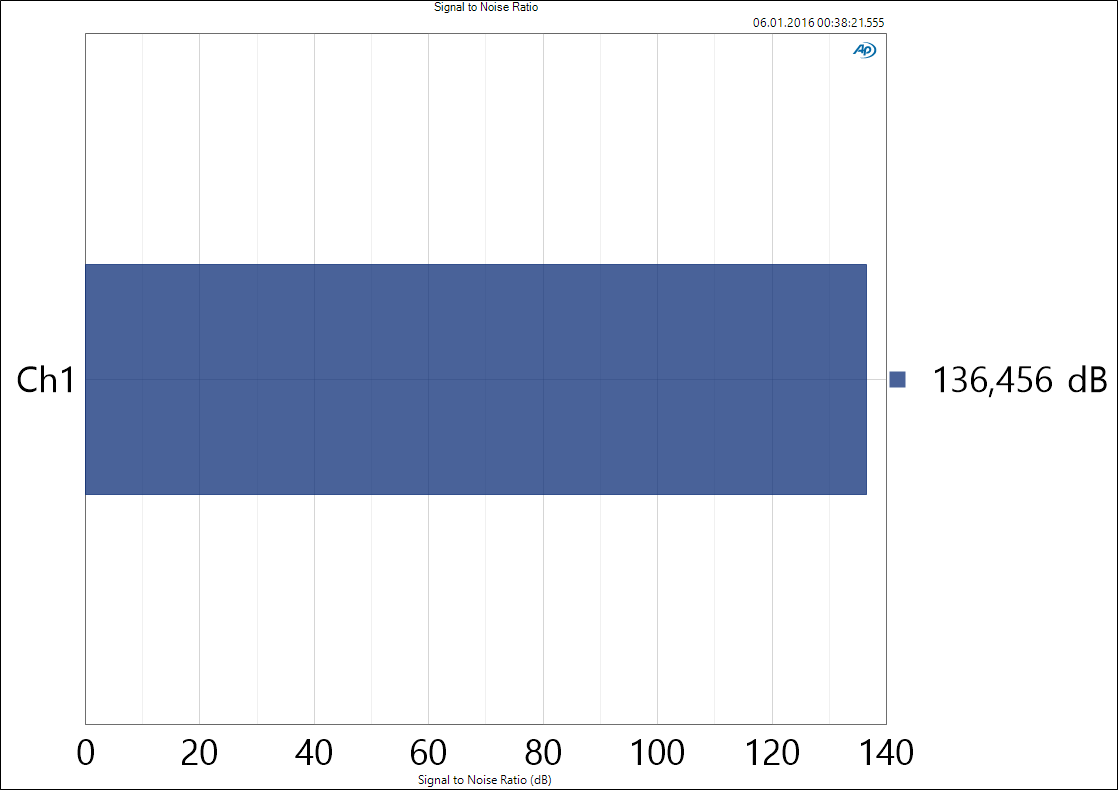

I don't know if you ever designed a very low noise and THD circuit but I would not choose a 5532 to do so. There are better parts for a reason.
(e.g. I had to design a very low noise headphone amp for audiometric measurements. 136dB(A) S/N, THD hard to measure with my Audio Precision. Not every design needs to be just ok and 100dB S/N. It's DIY - where is the fun in building "just OK", you can buy that for cheap.)

p.s.: The measurements I showed are from OPA1611 + LME49610 as Buffer and a symmetrical input stage with some switchable gain. Feedback resistors get in the 1-2k area to achieve that noise level so a high output current of the OPAs is a must.

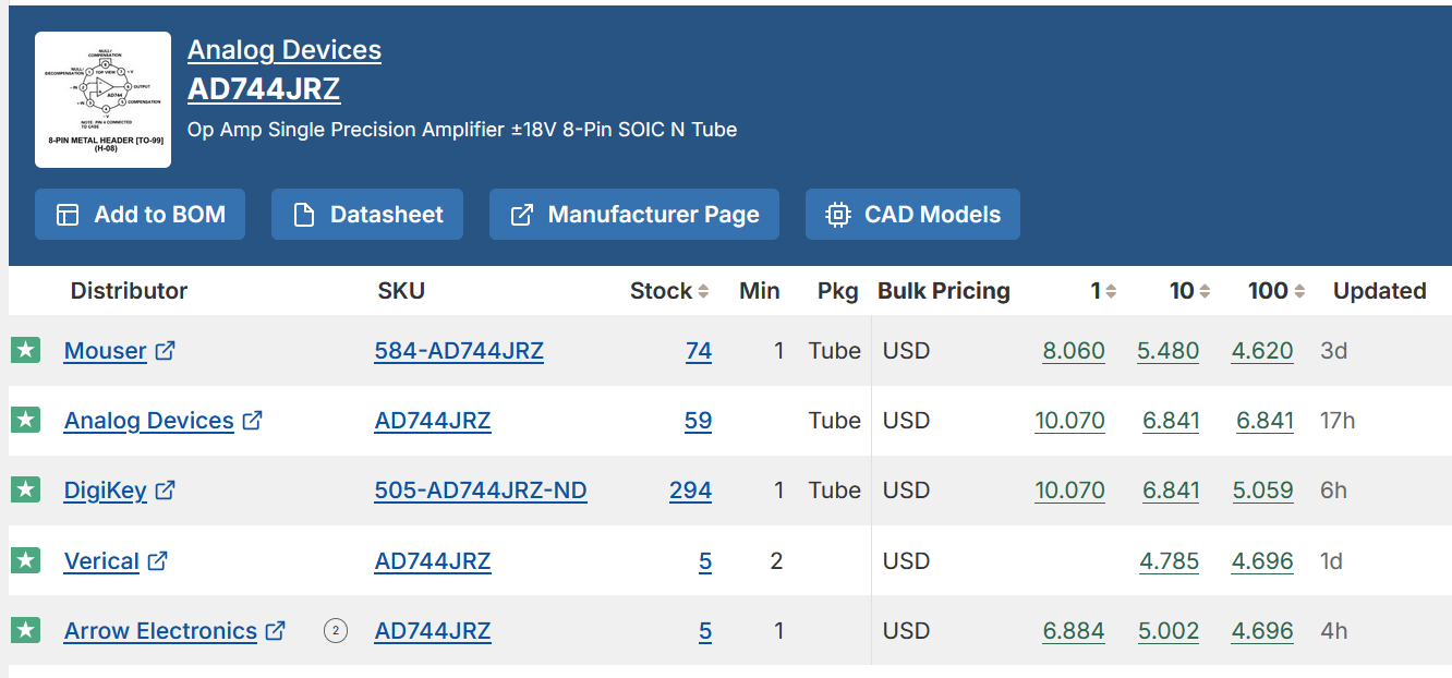

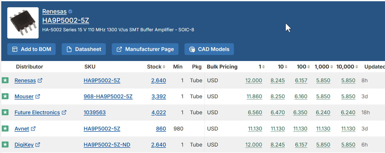

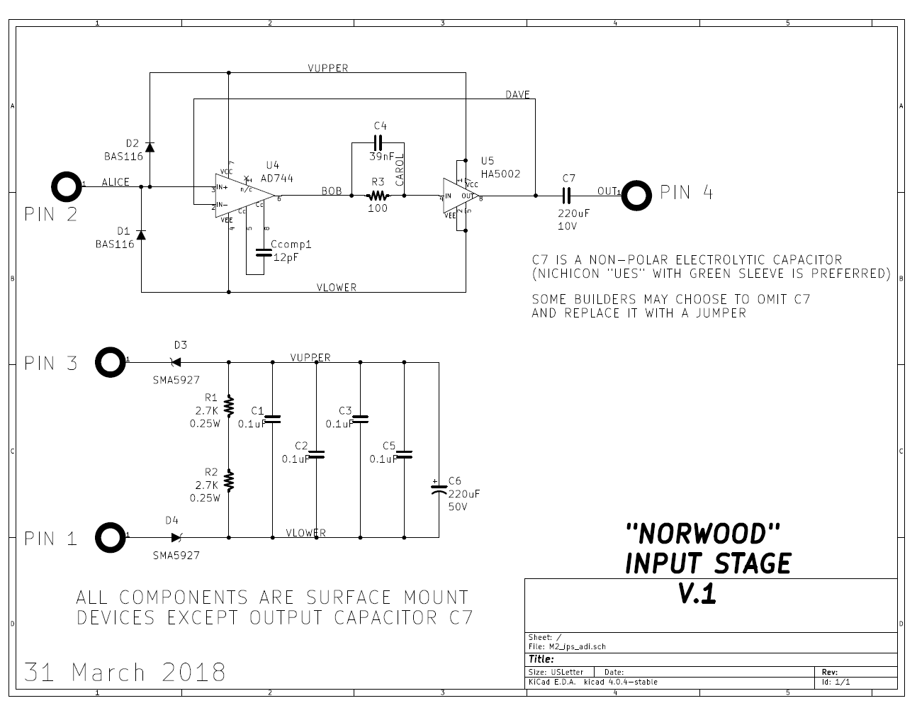

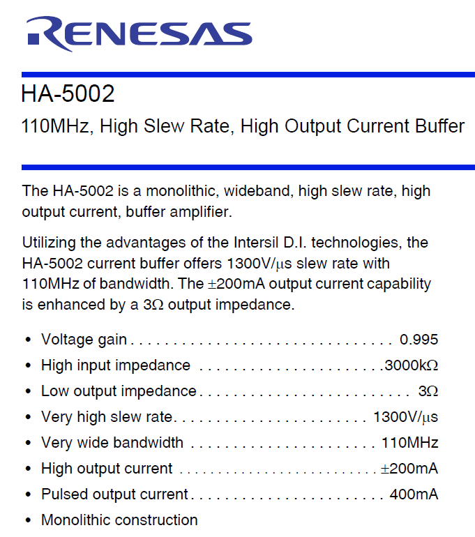

I've had good success driving 600 ohm transformers using a composite amplifier. Two ICs contained within a single global negative feedback loop. The AD744 is wonderful for this job because it has JFET inputs AND dedicated I/O pins for external compensation, which are ultra handy in a composite amplifier. The HA-5002 is a video buffer with plenty of grunt; 600 ohm loads are child's play to this beast. Octopart price tables are attached.
Reactions: IamJF and profiguy
