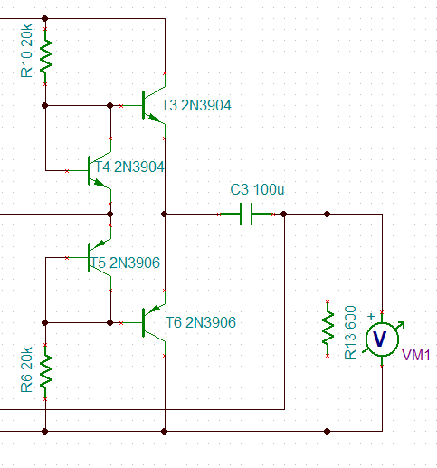

I think that mixing LME49600 buffered opamp with a zero impedance type drive mentioned before might be the most optimal way. I would avoid THAT 1646 in this case. It has differential outputs, which means the effective impedance of the load will be halved to 600Ohms/2=300 Ohms. This will increase distortion. Even in perfect conditions 1646's distortion is still a bit higher than of a good opamp.
Add this to any op-amp output. Include the C3 if the supply is unipolar. Don't include if bipolar supply used, Simulation shows the added distortion is less than 0.005%. It looks complicated but really it's just repeats of three different parts.
"Boost Amplifier Output Swing With Simple Modification" is an old AppNote from Burr Brown that does this, only better.
