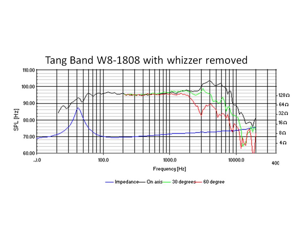

When the Tang Band W8-1808 8" full range speaker was $140 I drank enough wine to cut off the whizzer cone in order to turn it into a true midbass to mate with my DIY ribbon tweeters. The W8-1808 was the first 8" that came close to my wish list parameters from playing with a T/S calculator tool.
Wish List:
1) flat frequency response from 80Hz to 1,400Hz
2) 94-96db/watt efficiency
3) no ugly break-up modes
REQUIRES:
a) ~9 grams moving mass
b) which is only possible with underhung motor and
c) light full range state of the art paper cone
d) and well dampened suspension capable of 5mm Xmax
e) and phase plug to reduce beaming at 1,400 Hz
f) a large, odd shaped enclosure with extensive rear wave dampening material and resonance breaking cross-bracing.
A sealed back midrange with a sharply rising SPL like the 18 Sound 8NM610 would not be my dream midrange.
