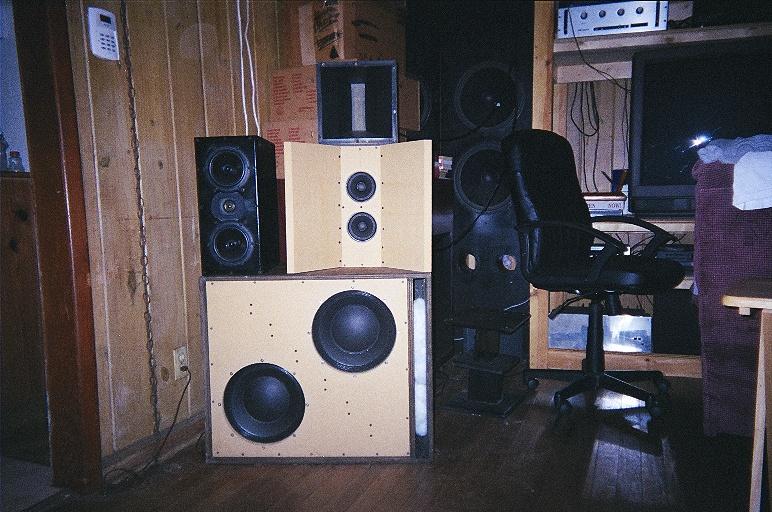

I like the way you have your bass (or in my case mid-bass) drivers off set.
I used this same approch a few years ago, and intend on going back to it. Sounded really nice.
(ps disregard the MTM video speakers in the pic, and then notice the similarities)

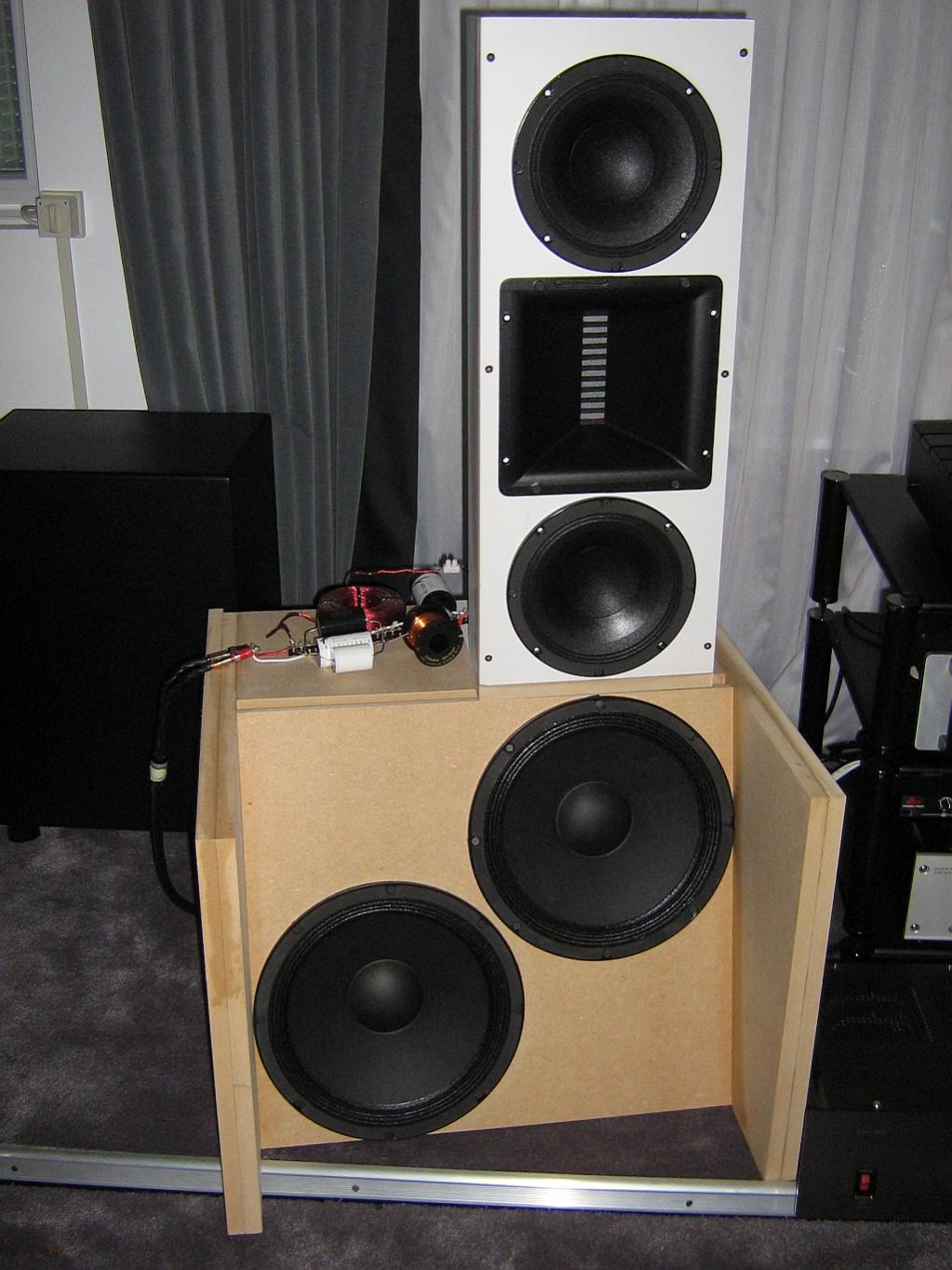

Here is my friends set up; open baffle bass still under development.
He prefers the TPL150 horn loaded (actually more a waveguide); I prefer it without.
In this situation the woofer offset is done to limit total height of the complete rig.
Maybe some kind of U or H frame might have done the bass job, but I am not sure if that sounds good up to some 200 - 250 Hz.
