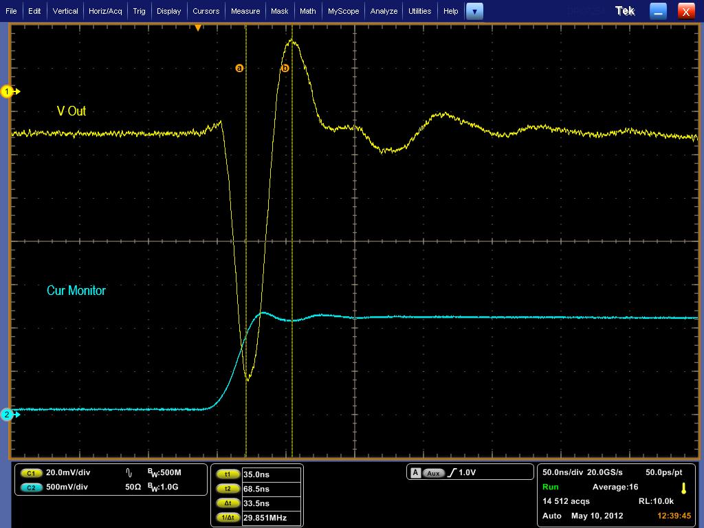

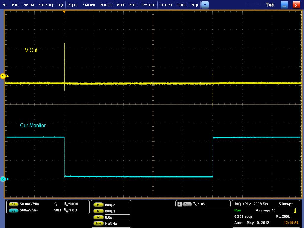

Response to a current saltus.

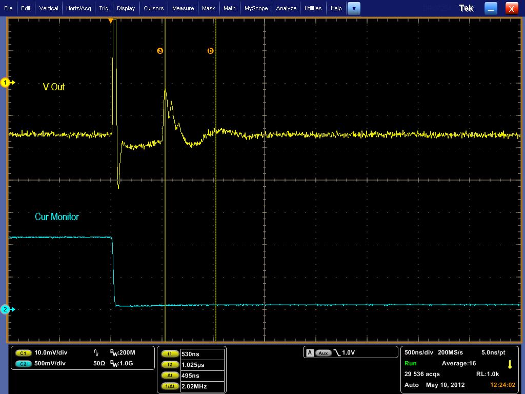

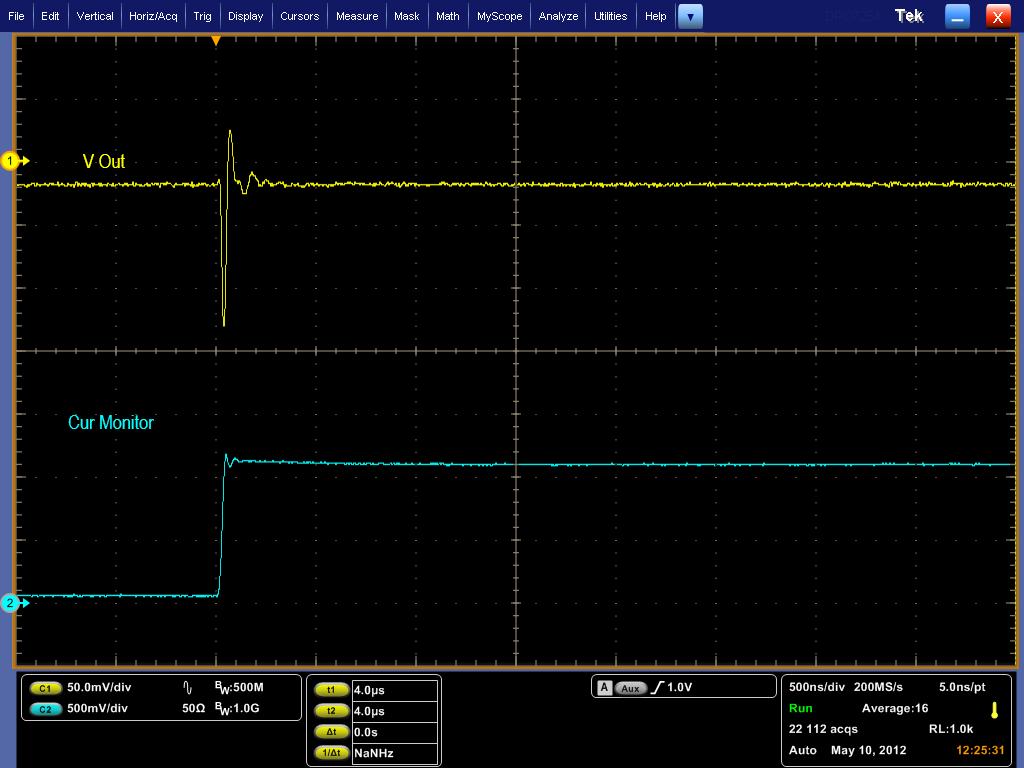

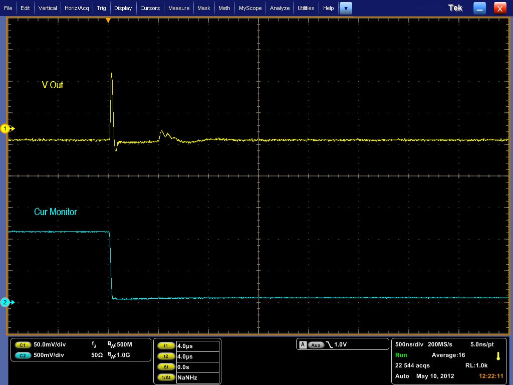

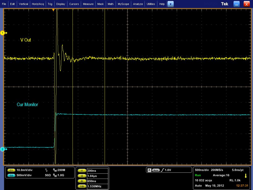

Loading-100ma current, is set by the constant resistor of 150 Ohms on an output. Current races about 100 mA. Frequency-1kHz.
Stability measurments.
Looks good!
Can I ask you what equipment you used for this measurement?

Thanks. Can you give me the name of the equipment or software you used to make those Bode diagrams I asked about?
Ja

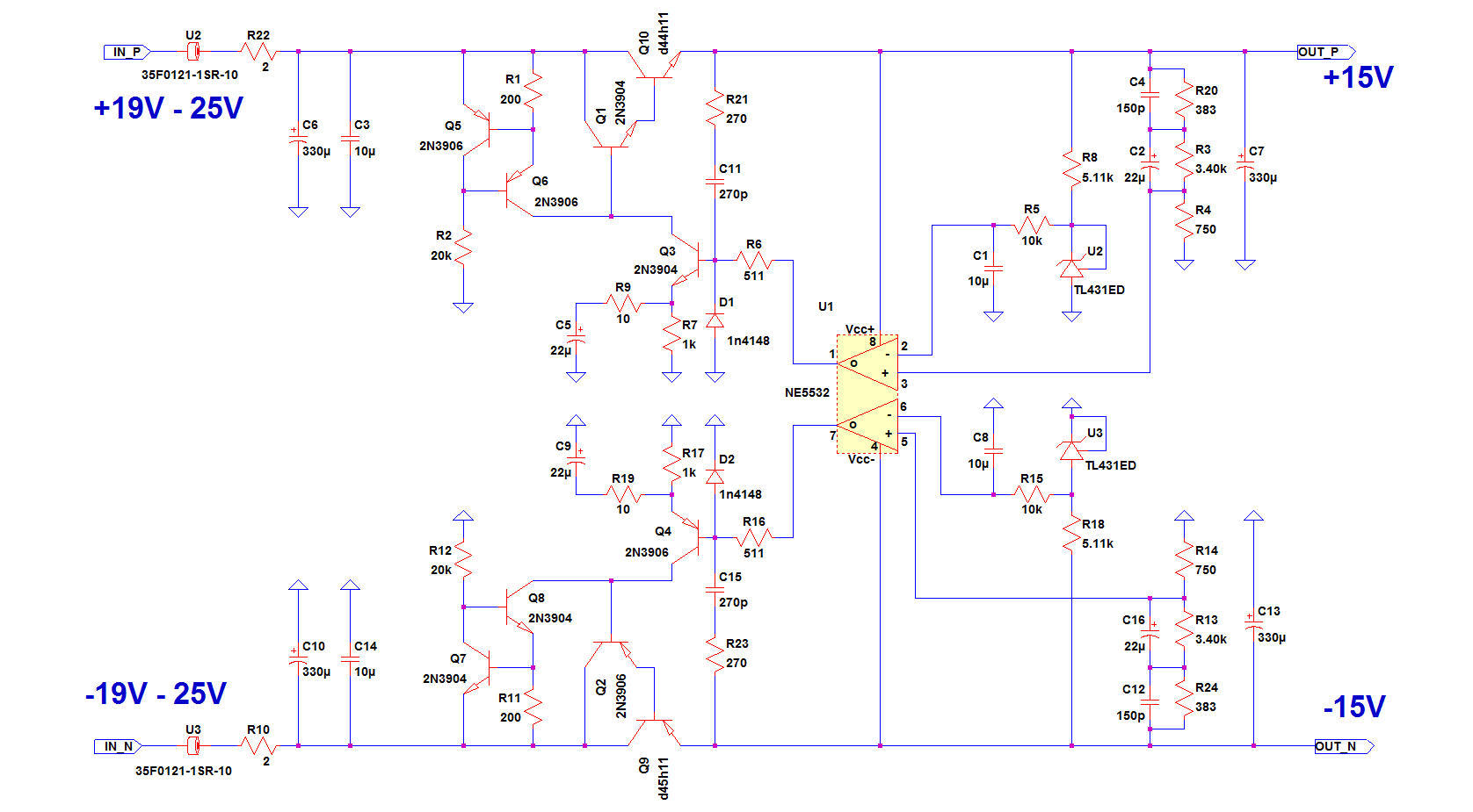

I have this (analog) schematic with current limiting.
Circuit is at home, wait for a while.

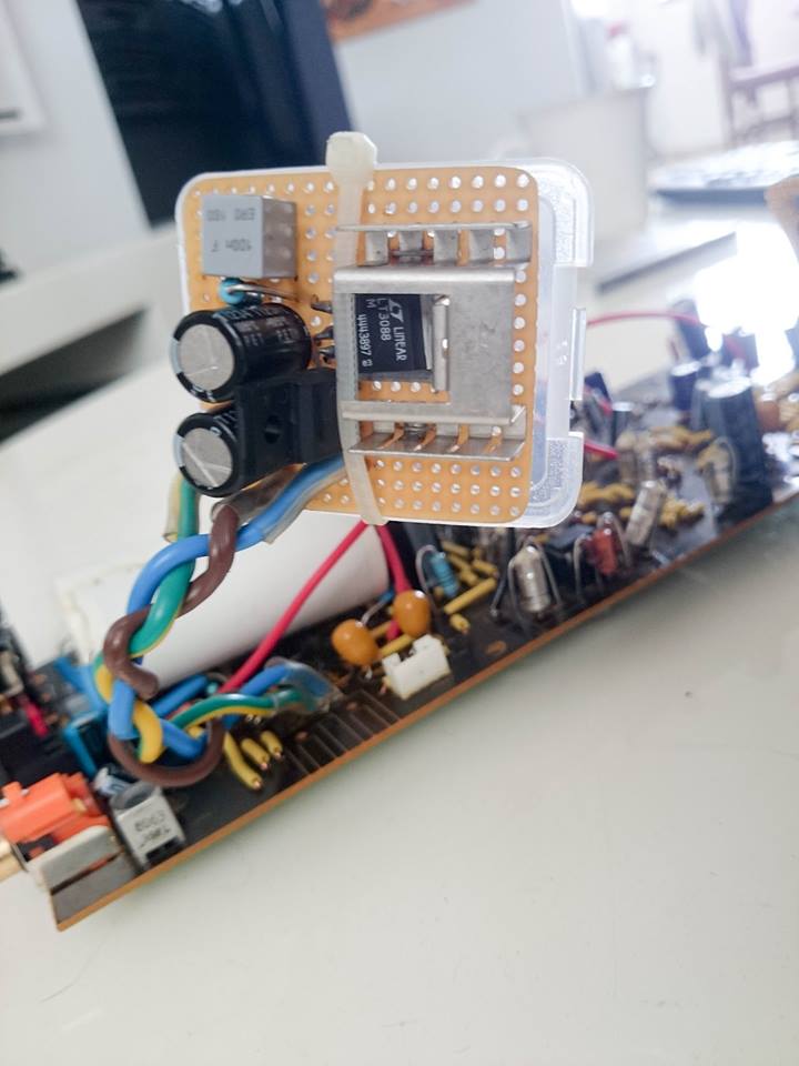

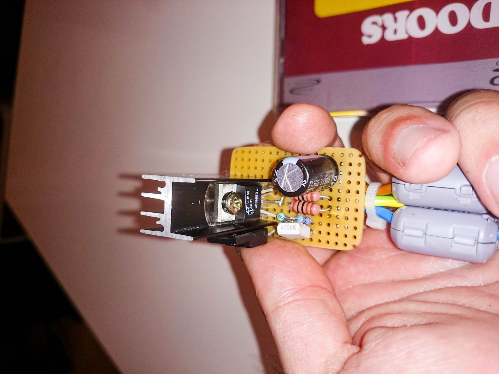

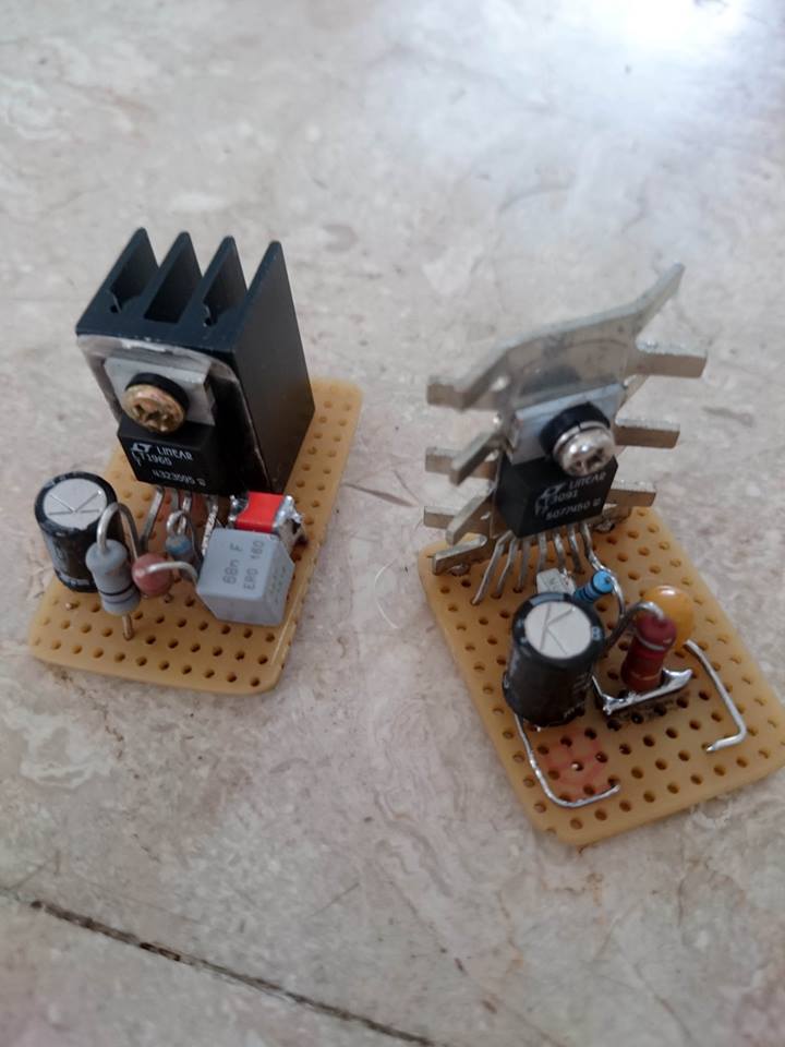

The temperature was just an example
built the same Voltage reg
For example
3.3V
Gives power to all audio processors
And it has a lot of
load
Over the 1A
With LT3081 hardly heats up
With LT1764 heats up much
With the same heatsink
In the same place circuit
The
LT3088 (800ma)
LT3081 (1.5A)
LT3091 (1.5A)
Amazing very stable voltage does not change even if the load light or very large.
also the lt3081 lt3091
has Programmable Current Limit
and
Positive or Negative Output Current Monitor
( Add CADJ 0.1Uf and diode and you have soft start . As the cap greater in value
the Soft start time is bigger and the Output Noise, PSRR,
Transient Response is Improving Especially in the lower frequencies )

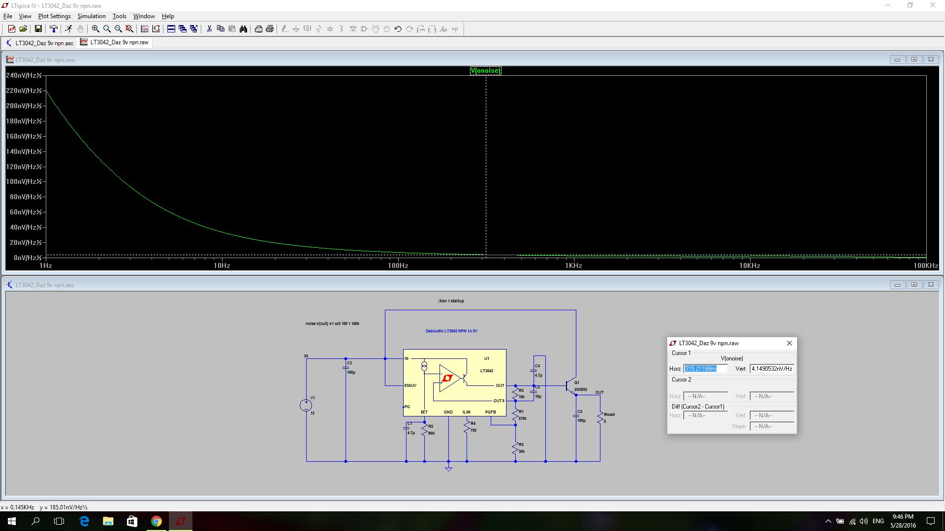

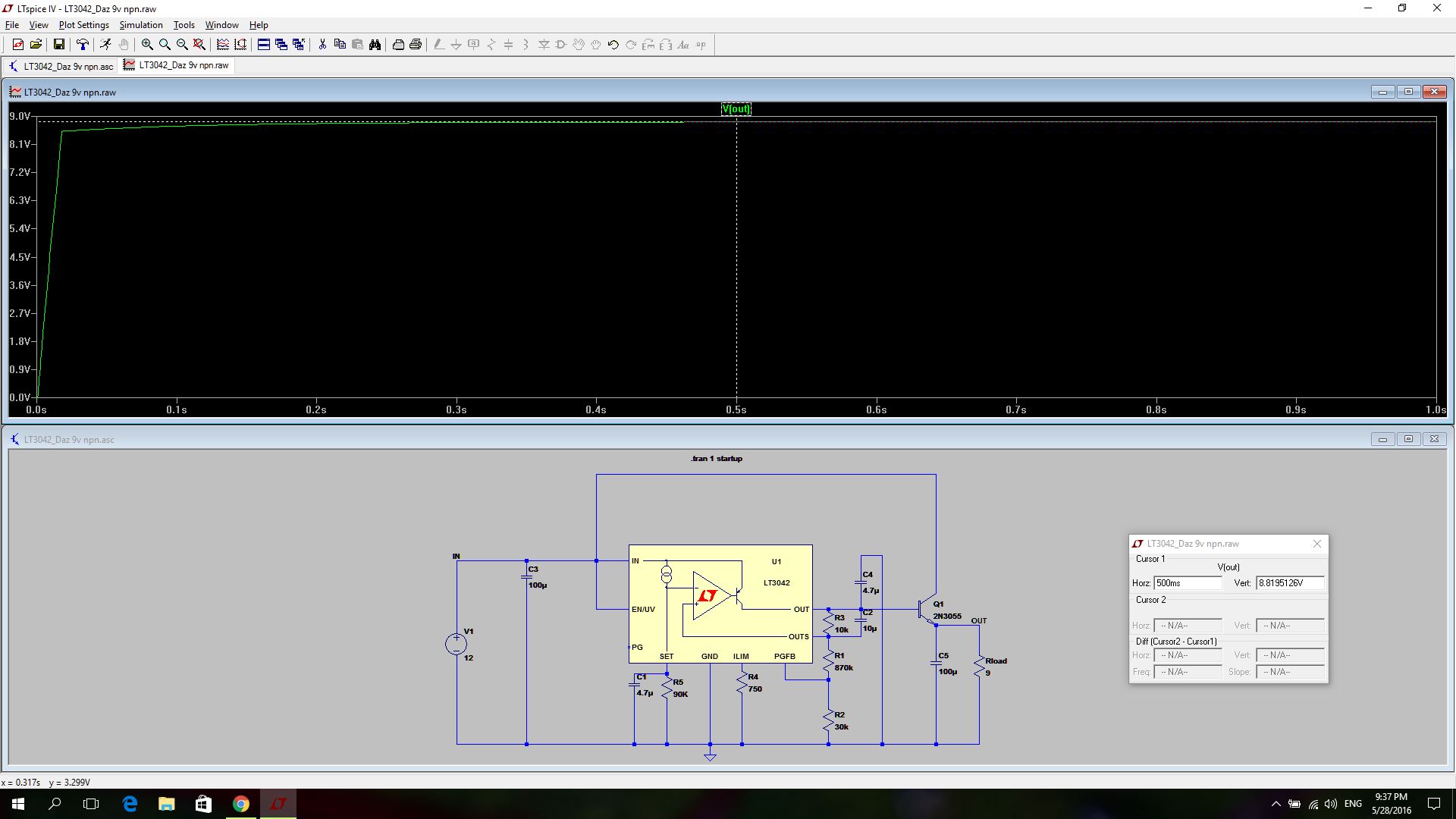

I have a lot LT3042
Still not built with them Voltage Regulators
Only designed In LTSPICE

What I wanted to explain is that if they are in the same circuit, they will dissipate exactly the same power.
If they have different temperature, it is because you use different packages, or a different PCB layout.
The temp does say noting about the regulator quality.
Edit: depending on the output load capacitance, a regulator can oscillate. In that case they can disipate more power and really heat up. Maybe that happens with some regulators.

This is funny. Especially the terms "Our" and "Russian answer". 🙂Our circuit works better...
This is my circuit and measurements. They were described in my thread of this forum ???????????? ??????????? ???????? ??????? ? ??????? ??????????? ??????? ??????
as soon as a couple of my Russian-speaking friends showed interest in it. More detailed description, measurement setup and calibration is described in this article https://linearaudio.net/article-detail/2257
This circuit has nothing to do with Russia as well as it was not designed to compete with Jung's or any other circuit. I fact, Walter Jung's publications inspired me to try it.This is Russian answer...
You absolutely right. Measurements were taken in US, in sunny Colorado. And yes, it is 60Hs.Post 477 -- given that the power line frequency is 50Hz in Moscow, I am questioning those measurements which show the typical Audio Precision power line at 60Hz.
As per network analyzer question, I tried both HP 4194A and AP instr 300 analyzers as soon as I had acsess to both. They showed similar results, but AP data is more convenient to save.
😀 Eugene this is really fanny, especially
This is Russian answer to Salas's The simplistic Salas low voltage shunt regulator .
