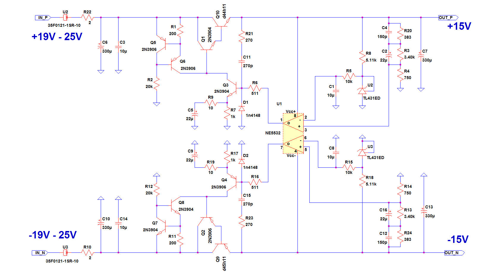

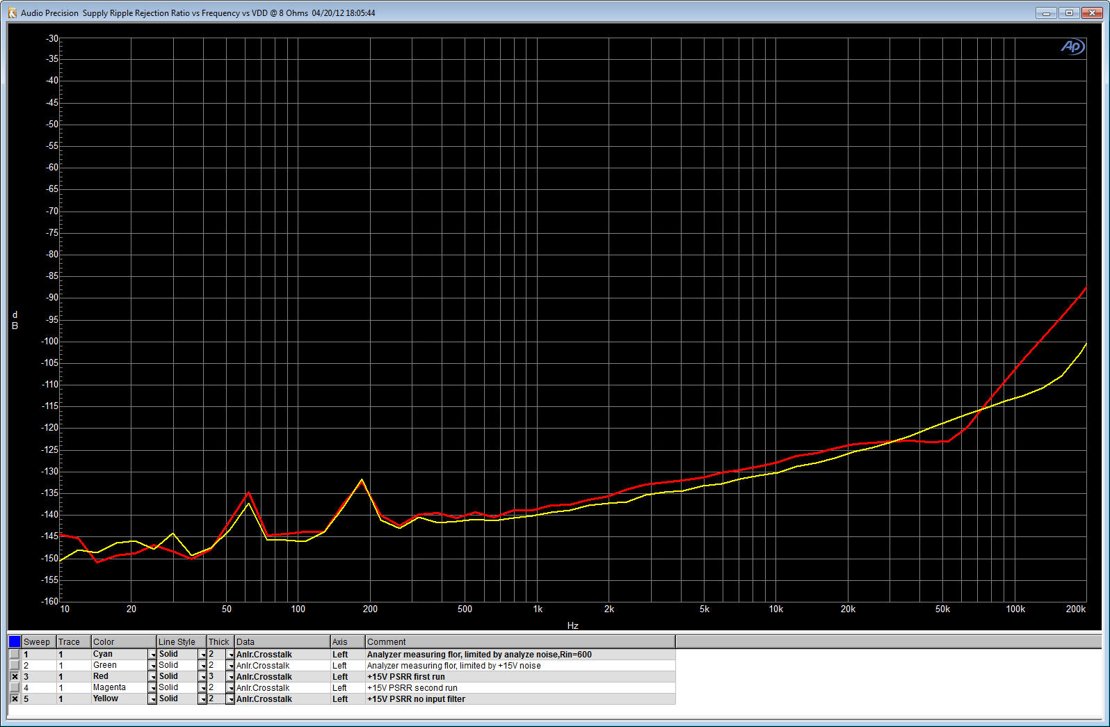

i will run the experiment in real time with a pair of LDO's like the LT1963A and LT3015 -- more common than the Jung regulator these days and requiring equal care in selection of the output reactive loading.
