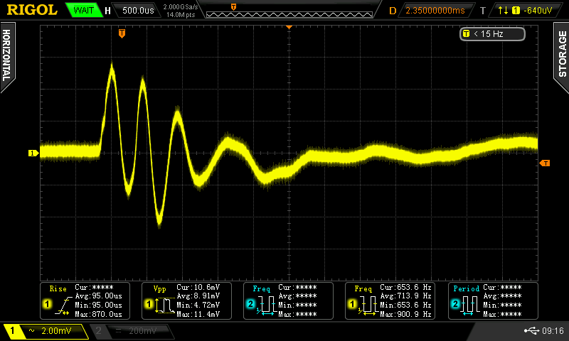

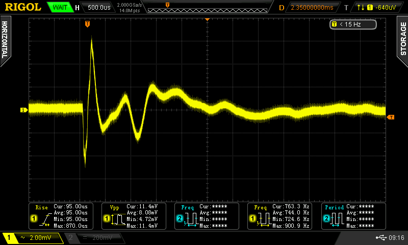

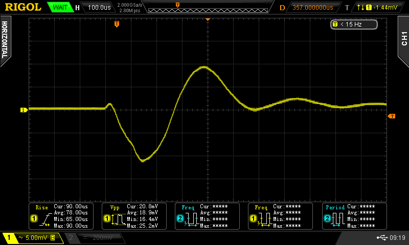

You should read a bit before bitching like this. It is a well known phenomenon and anyone can measure it, just stick a coax on a high-impedance scope input and twist it.
Fortunately tribo, piezo etc result in a charge being generated, not a voltage. This charge will translate into a voltage high enough to be annoying only if the cable is not driven by a low enough impedance. So if your cable is connected to a low-impedance output like a preamp, usually it does not matter.
For example check out these scope shots. Here we have a coax that I hit with my finger. It delivers about 20mV pk into the scope's 1Megohm input. Of course this means it would deliver something like 2µV into a preamp's 100 ohm output impedance. This cable would be very bad for a microphone, if someone steps on it, THUMP. Fortunately this is not a problem in practice since everyone who has setup a microphone on a stage knows that you're supposed to use the kind of cable that doesn't THUMP when someone steps on it.
If you got very low-level signals and/or high impedances, special measures are needed. Balanced microphone cables have cotton filler to prevent rubbing, and you can find low-noise cables for medical (ECG...) or vibration sensing applications, which have conductive layers (usually graphite) at interfaces to neutralize triboelectric charges.

You just said a story in which you did mentioned the problem and the answer.
Therefore never connect a microphone to your oscilloscope by using an Oscilloscope probe as extension cable. 😀

Just for clarification I would say that there is no problem, except if you manage to replicate it, at normal conditions, and with normal use.
The probe of the Oscilloscope is a very special item, and is designed to operate at one million ohms as impedance.
There is no comparison with any sound application, microphones is at 600 Ohm.
Do not bother with this hilarious theory that is distributed mostly in YouTube, so kids to keep their heads busy with one phenomenon that happens only to oscilloscope probes.
And it happens because they have a capacitance adjustment pot on them that causes this recorded anomaly because the plates of this adjustable capacitor are moving due the impact.
We are talking for just 12-18 Pico Farand here, which for an Oscilloscope it is an significant amount as capacitance.
So all these reputable companies making low noise microphone cables are just wasting their time by solving a non-problem?Kiriakos said:Just for clarification I would say that there is no problem, except if you manage to replicate it, at normal conditions, and with normal use.
So it is not the cable being hit, but the sound travels up the cable to the 'scope probe and affects the capacitance preset? Implausible. Easily disproved by connecting the cable straight to the scope with no probe.And it happens because they have a capacitance adjustment pot on them that causes this recorded anomaly because the plates of this adjustable capacitor are moving due the impact.
Would it not be easier and simpler to just accept the known fact that microphone cables need to be made in a specific way in order to reduce handling noises?
Anyone who has spent any time doing high quality recording or performing has had cables that "talk." Low noise cables, from companies like Belden, Carol, or other "mainstream" manufacturers are inexpensive and effective.
BTW, as mentioned, the above traces were taken from a bare BNC to BNC cable, about 1m long, RG58 I think, not a scope probe cable, just a cable that was laying around on my bench.
I did not take the cable from the box where I put the high noise ones, that I really don't want to use for LF analog stuff though (that would have been too easy).
Also my scope probes don't seem to generate spikes when I handle the cable. Maybe the manufacturer did their job, who knows.
