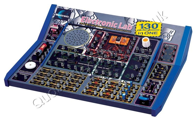

Well at least light has a speed. It makes sense that electricity or the "molasses" inside of wires does too.
I might have to go back to this:
