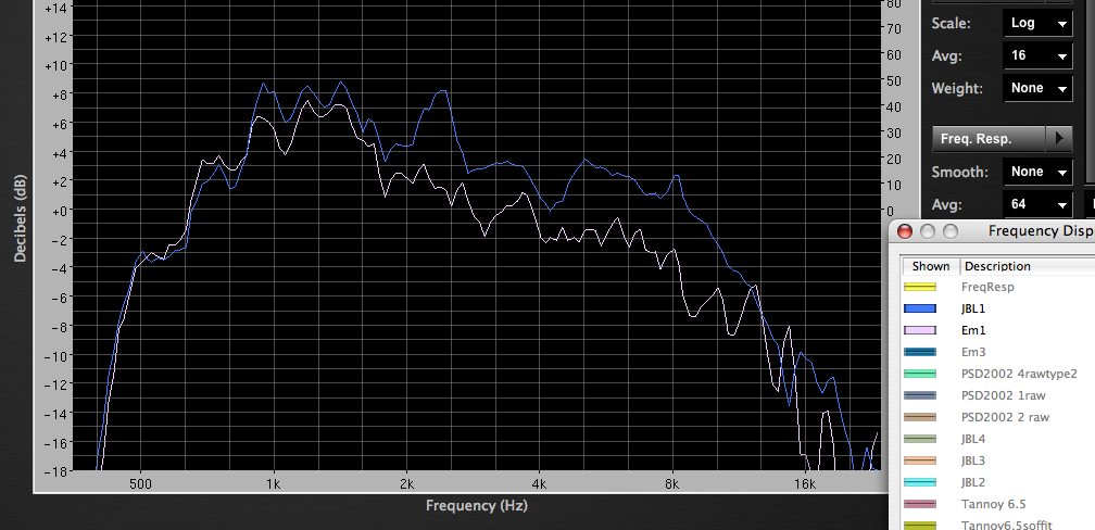

The graph below shows a JBL 2420 with a Clear Power titanium diaphragm compared to a Eminence PSD 2002 (type 1) on similar horns, the difference between horns being the horn throat for the 2002 driver throat was made longer to equal the 2420 depth.
Art
That's an interesting comparison.
I see the Fs of many low cost drivers are above 1kHz perhaps due to cavity size or suspension.

Do you have response graph for the Eminence PSD 2002?
I'm interested in the Pyle Pro drivers as well.
I posted a response curve for the PSD2002 series 1 on one of my old 60 x30 horns in post #87.Do you have response graph for the Eminence PSD 2002?
Eminence has response curves available in PDF form on their website.
