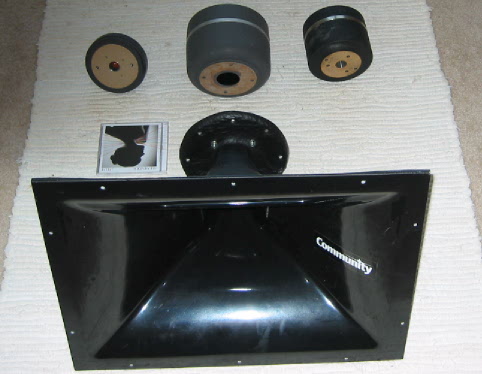

Magnetar,
Always wanted to hear that one, and those monster EC600s!
Daveis,
I like the Community M200 midrange. Mylar diaphragm, shallow profile, and, in my opinion, slightly smoother than the JBL 2440 within its bandwidth - 400Hz to 3500Hz.
The exit geometry/flare rate for the JBL 2440 and TAD 2001 are similar, in that both have deeply recessed diaphragms, I suppose due to the low resonance (the 2001 ~ 340 Hz) and magnet/motor design.
When measured a few years ago, the Radian 475 didn't measure as well as the 2001, with a couple of extra peaks in the response, but were fairly close.
I included the Altec MR901 1" as a comparo. Also relatively shallow.
I do believe that with better materials and simulation tools now available, the choices offered by BMS, B&C, and Radian, among others, will all sound very good on the right horn, and contoured/EQ'd as needed.
Tim

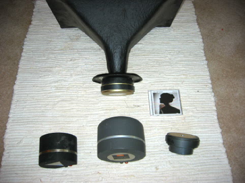

another view
Reversed:
1" Altec MR901... 2" JBL2440... 1" TAD 2001... 2"Community M200 on 90 x40 horn
All sound decent to very good on the right horn.
I would look at the Beyma 1" drivers, and the JBL 2435 looks to be a winner in the 1.5" exit category.
Tim
Reversed:
Tim
