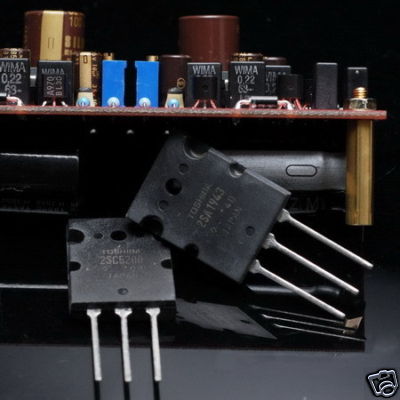

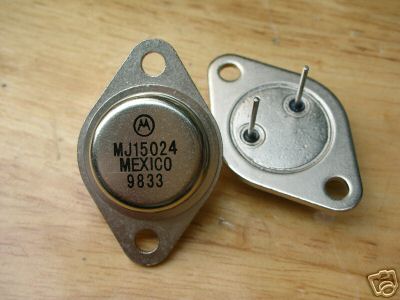

Re: Anyone have experience with this seller?
No, those are fake. The real Motorola/Onsemi transistors are perfectly flat underneath.
I believe digikey is a good option, especially that you are in the US. MJ21195/6 is better and cheaper.
clm811 said:I saw some transistors on eBay for a fair price, from "ALLPARTSPIPE".
They claim they are genuine Motorola.
-chas
Sorry, Charlie
Chas!
Don't trust those fakes- It only costs a few cents more/unit to buy from reputable, domestic sellers. Don't be taken in!

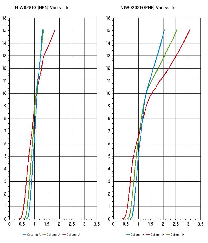

OnSemi desktop manouveres
Dear All,
Re: The new(ish) 0302G & 0281G from OnSemi - They are available as both MJW in TO-247 case and NJW in TO-3P. There seem to be 'quite a following building' for these devises...
I have done some spread sheet and other severe desktop manoeuvres in order to have similar Vbe vs. Ic graphs for these OnSemi devises, like the ones published by most far eastern manufactures, to aid the benefit of possible direct comparison.
Please find the graphs attached below in standard PNG format. I have a better detailed version of the file available in open office drawing format as well if you like to request it by mail.
All the best
a1greatdane aka 'Dr' O
Chilli Sound Works
London, UK
