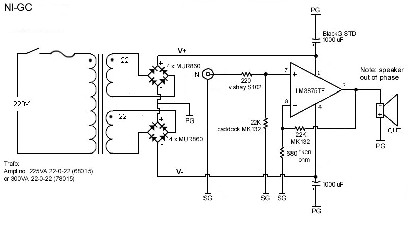

Didn't want to start a new thread just for asking this, but would this all be correct (think it is but don't wanna blow anything up right away since i'm quite a newbie at this) no zobel and no input caps but i guess that's obvious. My speakers are 8ohm 86db effeciency but those wil probably be replaced by speakers with a higher effeciency(and maybe lower impedance) in the not to distant future.
Not sure if i should go for 25-0-25 instead.
Another question, does the double bridge have any influence on the x1.41 from in front to after bridges, since the 1.41 figure is for single bridges.

Seems impossible to edit a previous post, i forgot to add the 'by Peter Daniel' in the schematic, since it's basically his GC but with the PSU section added...srry bout that.

waben said:Seems impossible to edit a previous post, i forgot to add the 'by Peter Daniel' in the schematic, since it's basically his GC but with the PSU section added...srry bout that.
Seems fine to me. As long as you don't mix PS wires, you shouldn't be getting any problems. I just measured today what voltage I'm getting with 2 x 22V AC, 400VA Plitron. It is 34V DC on rails. Also, with monoblocks, I'm not using any bypass after bridges, but when PS is separate you might try putting 4.7u BG N caps (right after bridges, in PS) as it may sound better this way.
PS: I started listening with normal plarity on speakers recently. With TVO it seems to be better this way. So check both plarities and decide for yourself.😉
I thought that the voltage would be (22v) (1.4) = 30.8v
Is this another case of the Plitrons putting out more than rated into smaller loads?
I used the same diagram as above but with a single bridge rectifier and also I did not include the 220 vishay resistor. Forgive me but I do not understand the purpose of the resistor in series with the input signal. I can see that it would form a voltage divider. Is it a stability issue? I also have a noise problem but I did not use a true star grounding scheme. I grounded each channel to a point and then that point to the power supplies star ground. I know thats not optimal but my soldering iron couldn't heat the large node of wires grouped together! I also used a 1k feedback resistor to ground.

Variac said:I thought that the voltage would be (22v) (1.4) = 30.8v
Don't forget that they spec the voltage at full load, otherwise regulation factor applies. My mains are higher too (120V)
The series resistor is to prevent excessive offset at full volume.
hey waben, if (when?) you know where to get those caddock's in holland, let me know. I couldn't find them and had to order them in germany. i'm using 18-0-18 and that's enough for my 87dB 8R speakers.
btw: i do have an input cap 'cause my pre has a little dc offset.
