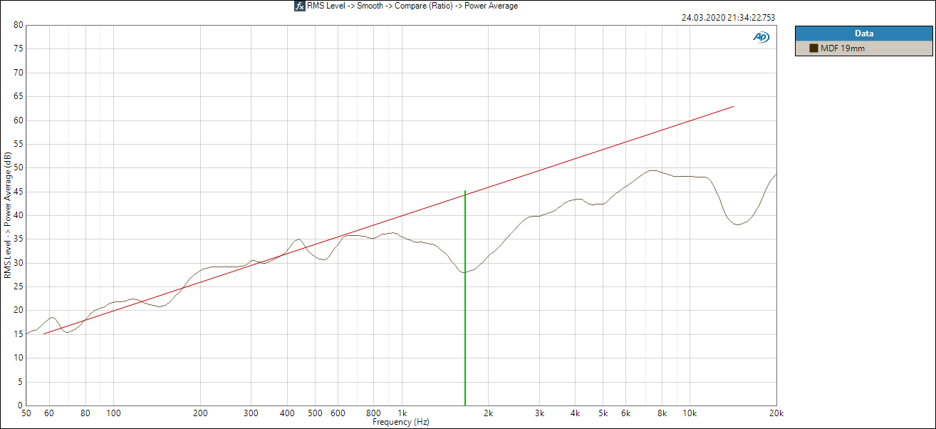

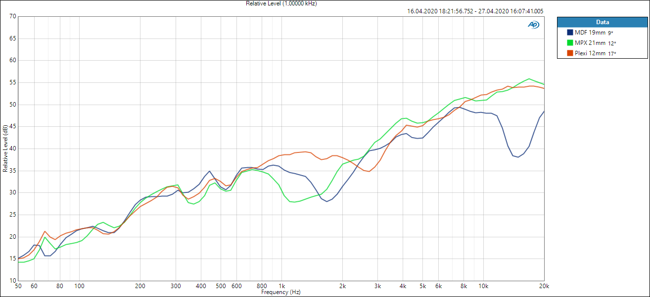

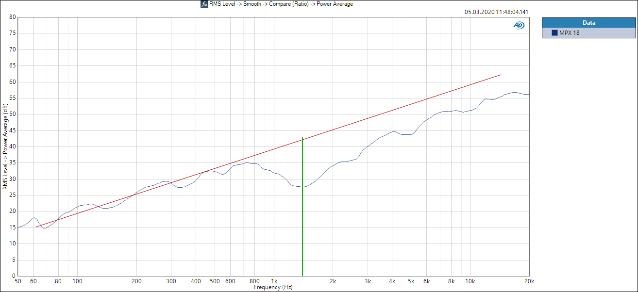

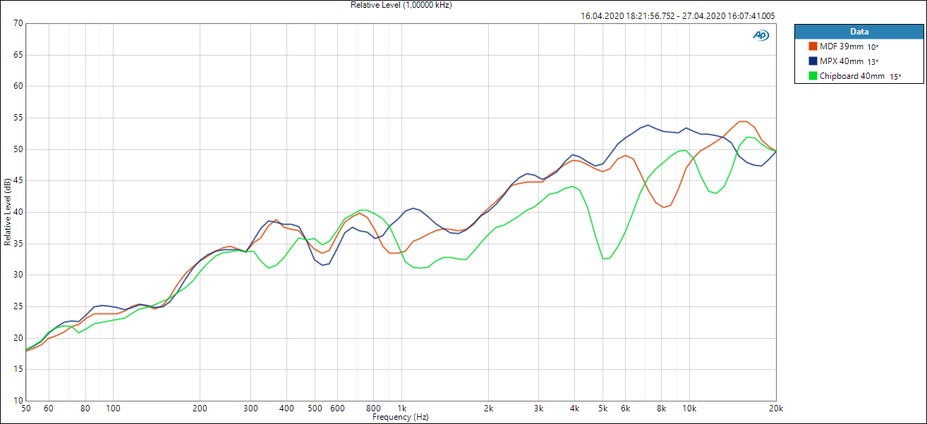

They are MDF. Not a great speaker building material, but not at all good for woofers.
MDF behaves very close to plywood in terms of resonance. It's just glued dust and for a woodworker a kind of disgusting material ... but acoustically it's fine.

MDF sounds ok its more a matter if you can bear the dust and end joints showing through your paint or other type of finish job. If you use a duraliner or an equal or a laminate it shouldn't pose a problem otherwise.

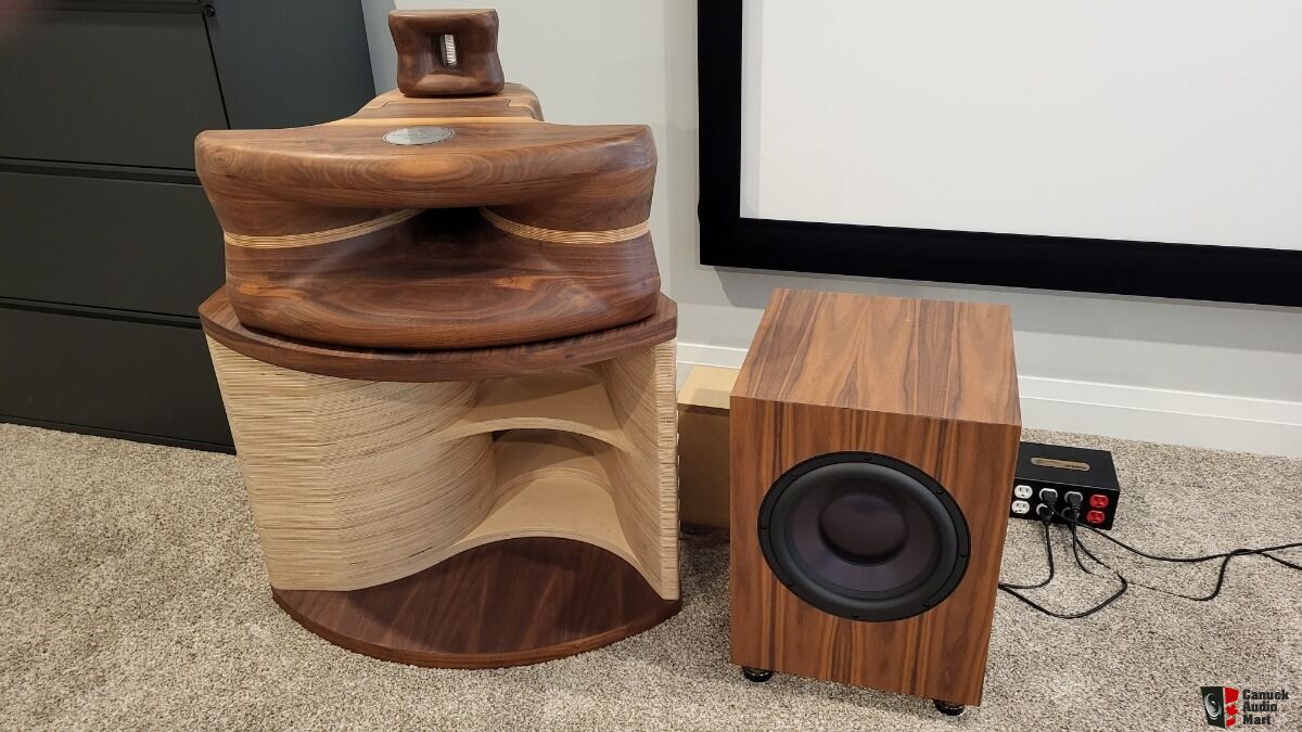

You might have to expand it to get the idea how he laminated that horn with the ply. Then a single sheet layer in between the solid wood to accent it. So cool, love that.
  • 4520650-d46fab14-joseph-crowe-custom-designed-horn-loaded-masterpieces.jpg

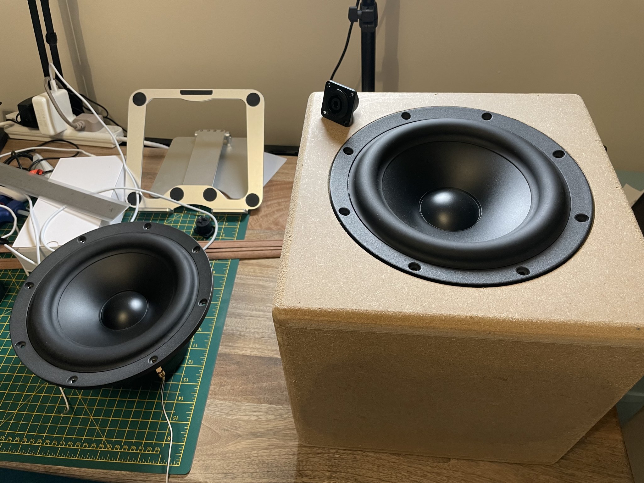

Making me think to just buy another of the same subwoofer rather than throw in 2x passive radiators and run them opposed. Amp says it can handle 2ohms.
Because they are nice woofers with huge magnets which displace or remove available airspace.
So the box is too small regardless for one ported, sealed or passive.
And adding 2 would make it extremely too small.

@WhiteDragon What size would you make the box? It's for music rather than home theatre. Just looking to fill out the bottom on speakers that only go down to 60hz with a AMT tweeter but sound very nice apart from that.
Madisound recommend below which in sealed seems even smaller.
Sealed box of 0.4 to 0.5 cubic feet for an F3 of 65Hz. You would need to use a bass boost or DSP to push the driver into lower frequencies. The F6 is 45Hz and F10 is 35Hz.
Vented box of 0.8 to 1.0 cubic feet with a 2" port by 8" long for an F3 of 35 to 32Hz.

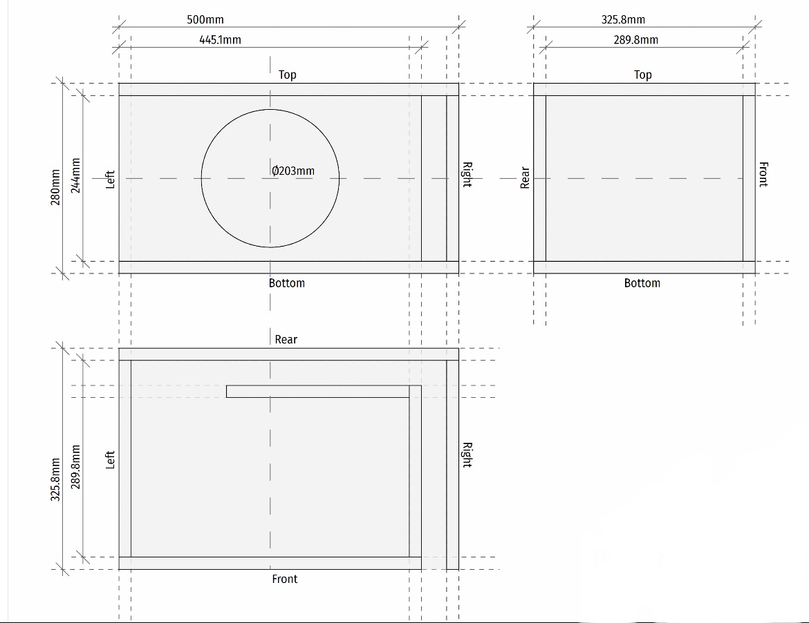

Okay, you changed your plan, that's fine.
Are you absolutely sure about the port though?
The driver you want to use claims a 12mm xmax, the box volume is a bit small, and the slot port will cause some additional resistance.
I am a big fan of slot ports, but not for all uses, they need to be carefully balanced for the application. A port this size with the box and driver you have decided on, should really be a round aero port, because they are better suited for this particular brute force application and can take more air velocity before making problems.
Not having looked at the numbers whatsoever, so I may be wrong about this, but the numbers do not add up in my head (no pens an no napkins available), you may end up with a lot of chuffing.
Other than that, I support you in your consideration of vented enclosures.
And again, if someone did take all these matters into consideration I am happy to be wrong.
