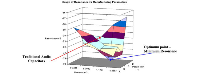

According to Clarity Cap the "trick" is that their products have a minimum resonance point, see the attachment and the graphic.
ESA polypropylene audio capacitor from ClarityCap
Two axis of that graph are labelled "parameter 1" and "parameter 2".
So is that my shoe size and hat size? Or something related to the unit under test?
1) You say it is a misleading chart ?
2) I suppose it refers to the behavior of a capacitor under test, I do not know in what type of electronic assembly it was made

Have you read this? Just talk about the graph you question
" In the past capacitors were just capacitors and sound quality was determined by the dialectric material with polypropylene considered by many as "the best" seeing as this type of capacitor had the lowest losses. But technology of the 21st century has brought us new measuring techniques and insights and there seems to be more to it. We can now measure things that were not possible a few years ago. In a nut-shell: microphony is the keyword - the mechanical resonance, a key feature of audio capacitors. This is a physical deformation of the capacitor plates which occurs as a result of the audio signal passing through the component, in some ways like how an electrostatic speaker works. This resonance is dependent on the size, shape, materials and manufacturing parameters of the capacitors. This effect has been known about for years as it plays a part in the impulse strength of capacitors. However, the effect has never been considered to be significant enough to affect a hi-fi system's audio reproduction due to the low energy involved. For more indepth information read the Clarity Cap white paper on mechanical resonances inside capacitors. Another interesting article was written by Martin Colloms back in 1985 in which he tested several capacitors on their sonic differences. Also look at the equivalent circuit diagram of a capacitor at the top of this page, this also explains a lot. A capacitor is more than just capacitance C! "
