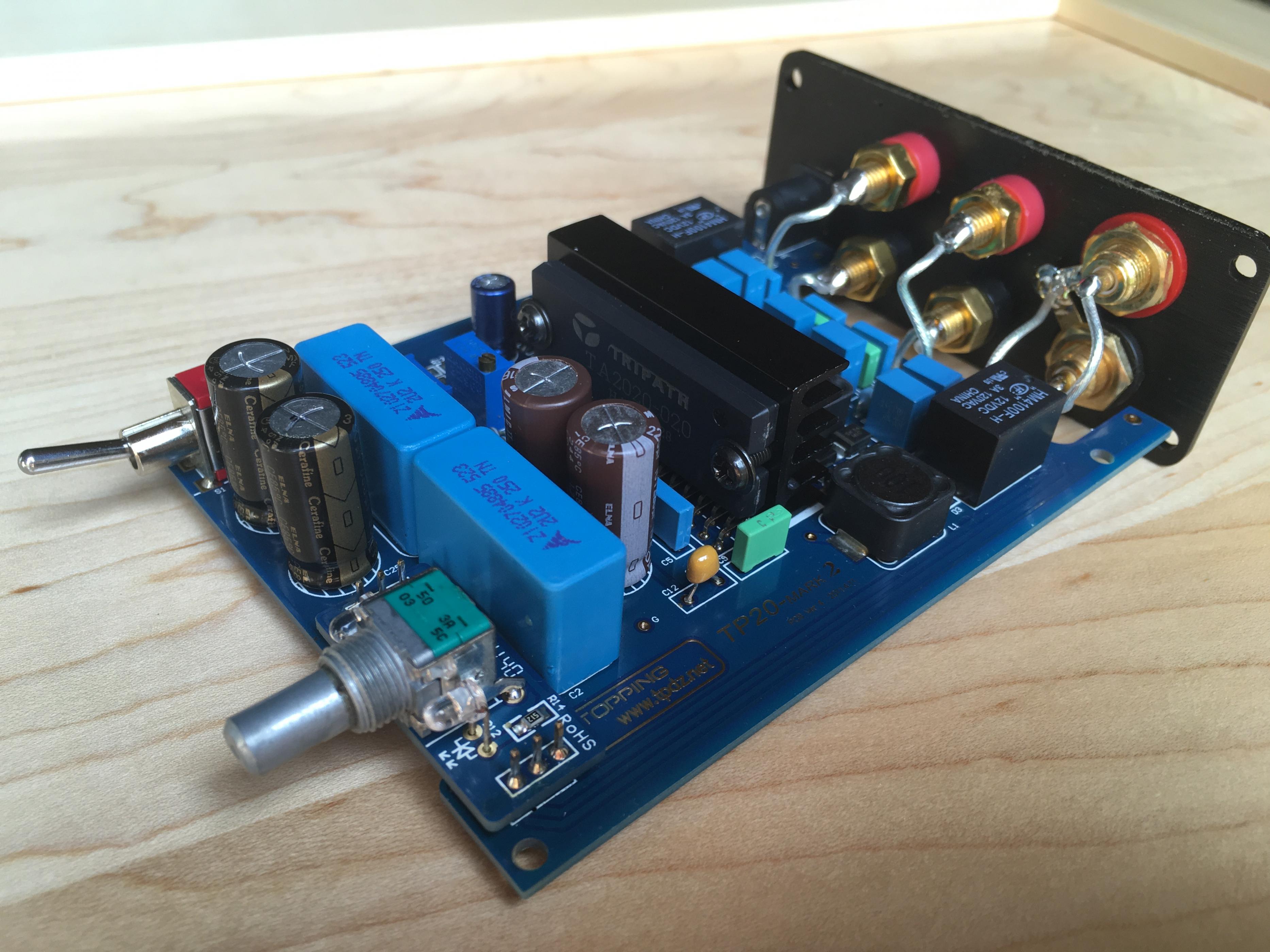

Well I recapped my Topping Tp20 mk2 (Tripath amp) this week. I tried a wide range of Panasonic, Nichicon, and Elna. Ended up combining Cerafine and Silmic II.
To my ears, Silmic has the treble shimmer and phat bass, and Cerafine has the forward midrange. On their own, I felt the colorations were wrong for this amp. Together, there is a balancing act with some serious mojo going on 😀
Great that it work out for you Stell. There’s just too many combis, too many varieties of caps to try & the” most excruciating part is that what works on one circuit does not mean it will do just as well on another. I’ve got some Red Cerafines but never like it’s sound slow & too forward sounding, I do wonder if the black ones sounds different. There was this following back when from tube se guys who worshipping the Cerafines, perhaps it gel well with dht tube stuff.
