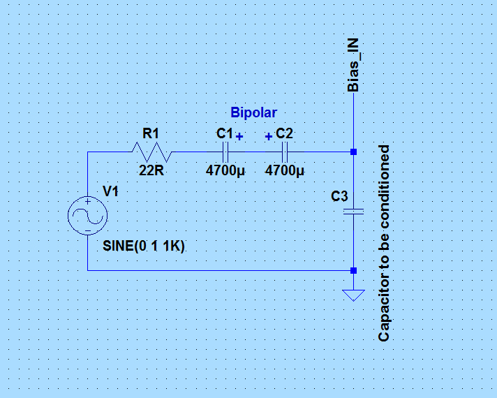

@carlmart: Some days ago I think you asked me for a schematic of the setup I use for conditioning capacitors. I have now drawn it up ... the sine generator really is an obsolete micro system I bought for this purpose.
Regarding capacitor distortion getting lower as a result of time, when there is a bias across the capacitor, Douglas Self has actually confirmed this in measurement (Linear Audio article). The distortion drops somewhat over time.
