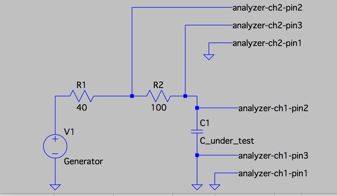

@Monte McGuire: Some days ago I remember asking you if you could outline the setup you use for measuring capacitor distortion (a schematic, if possible, would be helpful). Not to be insisting about this 😉 ... but I have used a setup that apparently looks similar to yours, however, my distortion levels have been much higher for electrolytics - similar to the levels Cyril Bateman measured. So it would be clarifying to find out if I have made a systematic error somewhere ...
Sorry for the delay - work gets in the way! Attached is a crude drawing of the setup. I’m not familiar with your analyzer and I can’t remember what Cyril Bateman was using, but I’m using an Audio Precision APx-555, which has an extremely low distortion floor, so this may be a reason why my numbers are lower. Also, I'm measuring harmonic spurs directly from 64 averages of a 512K point 192kHz FFT of the analyzer residual, and not THD+N, which would include a lot of noise, and not distinguish between noise and actual distortion, or identify which harmonics are present. In these tests, the noise of the analyzer seems to mask the residual distortion of the generator or analyzer, so there’s no uncertainty from that potential problem.
The 512K point FFT helps to push the analyzer noise floor down, since the analyzer residual (and DUT) noise gets sliced up into many smaller pieces each with less energy. The distortion spurs do not get reduced in level by the wide FFT, since they're pure tones, not random noise signals, so the wide FFT significantly decreases the noise floor level. Still, I can’t see the generator’s residual distortion in these measurements, and maybe that’s a limitation of this setup - a low noise preamp on the DUT could possibly reduce that noise, but for my purposes, it works well enough.
The connection is a single ended drive from the APx high resolution generator set to 40Ω output Z to the 100Ω probe resistor and the cap under test, all in series to ground. I’m reading the voltage across the 100Ω probe resistor and the cap under test using a balanced XLR connection to analyzer channels 1 and 2 of the APx. In this way, I can calculate the impedance of the cap easily, by dividing the DUT voltage over the 100Ω voltage, and scaling the results by 100Ω. Since the probe cabling is the same for both the 100Ω and DUT, you can get HF impedance measurements that are fairly accurate - the probe cable stray impedance divides out.
I originally misspoke and used dBc as the units. From the above, you can see that my data is actually the voltage across the DUT, not a true dBc measurement. So, my 'crud floor' is around -165dBV across the DUT when a 470µF cap is driven with the test signal and probe. The highest drive signal is +15dBV, but to decode that into the current through the DUT, you need to look at the data for the voltage across the 100Ω resistor and convert it to a current.
So, here are some re-stated figures from various caps I tested at 22V DC bias with 2kHz drive, just to keep it all straight. The drive level listed is the current measured through the 100Ω probe resistor, just for accuracy:
Panasonic EEU-FR1V471 with 46.65mA drive: -150.3dBV of 2nd harmonic, -128.3dBV of 3rd harmonic.
Panasonic EEU-FM1V471 with 46.65mA drive: -153.1dBV of 2nd harmonic and -135.2dBV of 3rd harmonic.

I hope this clarifies things a bit. The use of 470µF and 22V bias was because of the circuit I’m using these caps with, and the drive levels of ~45mA correspond to a very heavy signal induced ripple current, again from what I could expect worst case from my circuit. These caps were examined as power supply bypass caps, and while there are differences, these distortion levels are extremely low. In my circuit, a regulator follows the caps, so the actual levels are largely academic, and extremely low. Still, these measurements are reliable, and may help to identify their relative performance. Further, their absolute performance is probably worse with a complex music signal, and not a pure sine wave, so while these distortion numbers are very very low, I think they can still be useful to identify relative ‘cleanliness’.
One thing I forgot to describe is that my impedance probe includes a composite of 48 paralleled 10µF 200V metallized polypropylene caps to couple the generator to the 100Ω probe resistor, in order to shield the generator from the DC bias used in these tests. These caps are pretty high quality, designed for speaker crossovers, and each is around 0.75” x 2” size. Each cap was also screened for distortion using the APx, and only 2 or 3 were excluded from the group of 48 due to slightly questionable distortion levels, presumably from termination problems (schoopage failures) inside of the cap. In practice, the composite 480µF polypropylene cap seems to behave well, and I cannot measure its distortion in use.
Sorry for the omission, but yes, it is important to shield the DC bias voltage from the APx generator output, at least to insure that the generator circuit is not biased out of its linear range, and also to prevent any damage to the generator circuitry.

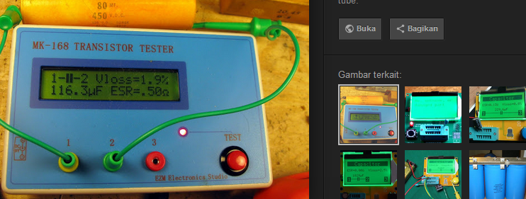

Where can I find information about Vloss from the manufacturers?
I don't know why my post, answer to gazzagazza is missing, but the picture attached to that missing post is attached to the next post (May be because I edited the last post while there is newer post).The manufacturers give you the 'tan alpha' parameter, as an indication of good new capacitor. For old caps, or if we aren't sure if the cap is original, fake or semi-original, then we cannot rely on datasheet. Simple measurement that correlate with good cap for supply decoupling is the Vloss, as can be seen from the picture, where an ESR meter measures the Vloss as 1.6% which very bad.@johnego:
Hmmm ... I am not quite sure what you mean but will see if an understanding comes along. Thanks for explaining, though 😉
