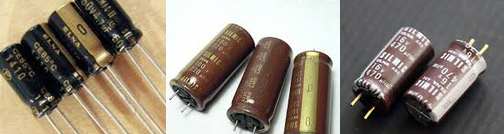

Your welcome Karl. Yes Jap verion more evenly balance. The once that you buy from digikey or mouser is more splashy on the treble & bass sounds fatter & does not go that deep. Oh on some applications the sound is more forward.
Strange that pic shows Brown with Gold print Johnego. Could be earlier version when transition was made from Silmic 1 to Silmic ll

They are current production. More popular locally than the black-gold version.Strange that pic shows Brown with Gold print Johnego. Could be earlier version when transition was made from Silmic 1 to Silmic ll

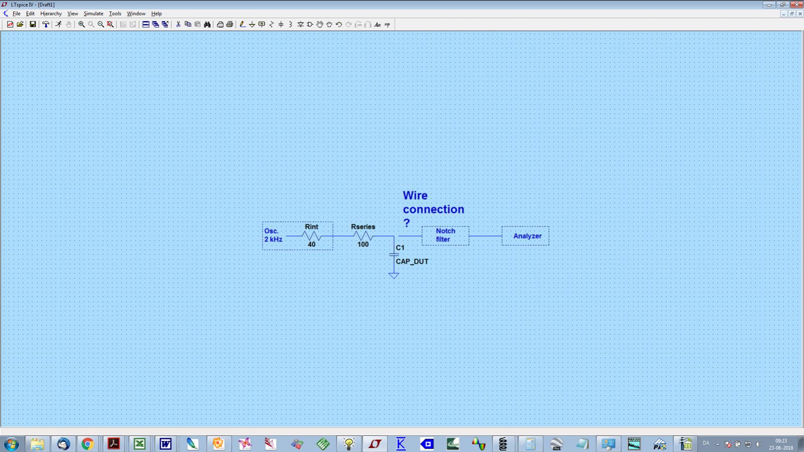

As a follow-up, today I received some Nichicon UES1C221MPM1TD (220µF 16V non-polar) and put one on the same test jig that I used for my earlier tests, except without applying any external DC bias, since this is a non-polar cap, to be used without any DC bias.
I found that they had unmeasurable distortion in my test scenario: drive the cap with a 40Ω source 2kHz sine wave through a 100Ω resistor into the cap, which is then connected to ground. The test set analyzer receives a differential voltage across the 100Ω resistor as well as across the cap under test. The cap under test signal is then put into a distortion analyzer that notches the 2kHz fundamental, and 64 complex averages of a 512K point 192kHz FFT are taken from that post notch residual.
The largest applied test signal to the cap under test was +15dBV, and as measured from the 100Ω series resistor’s Kelvin connections, this resulted in 46.6mA of drive current through the capacitor, quite a huge drive level. Still, I could not detect any distortion component down to the noise floor of my test set, which is around -165dBV for this measurement. So, in terms of distortion, it seems clear to me that these caps are extremely clean.
There are many reasons why people prefer one component to another, but I have to say that this Nichicon UES series part behaves extremely well in terms of distortion, even at extremely high drive currents, far better than almost all other quality polar caps I’ve measured. Personally, I was very pleased to see these good test numbers from this cap, since many people seem to like them, and I know that other caps actually do measure worse under the same test.
I also want to point out that most coupling cap applications do not force the cap to handle >40mA of signal current. Often, the current through a coupling cap, which is proportional to its distortion, is a few orders of magnitude lower, more on the scale of tens of microamps, and not tens of milliamps. So, IMHO, these Nichicon UES series caps seem to be blameless re. distortion, even when they are asked to do extremely heavy lifting, and can pass huge signal currents with essentially unmeasurable distortion.

I thought you are abroad as you're not familiar with the brown Silmic II 🙂Hi Johnego
Your in Indo too ?
Me in Batam. Lol . I hardly play with Silmic ll cause I don’t really like the sound.

Appr. 2 Vpp music into 8 ohms into the capacitor connected to ground. Bias 4 VDC.What does exactly consist of that "very long burn in period"?
Actually the very UES types that Monte McQuire has posted distortion measurements for this morning. Also some very large size Panasonics (BP type) that sounded quite good but were too big.What were the bipolars you tried?
No, I didn't. My amp does not have GNFB.Did you used bipolars for NFB decoupling in any power amp?

Hi Monte ... If possible can I ask you to just briefly clarify what your measurement setup looks like? I've attached an LTSpice screendump of what I reckon it could be but I am a little unsure of how you connect things around the resistor and capacitor ... BTW - have you ever tried to measure the caps with higher frequencies e.g. 50 kHz? Could be interesting to see how they respond to higher frequencies ...drive the cap with a 40Ω source 2kHz sine wave through a 100Ω resistor into the cap, which is then connected to ground. The test set analyzer receives a differential voltage across the 100Ω resistor as well as across the cap under test.
