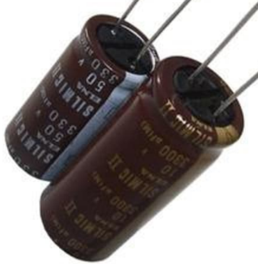

Elna Silmic II are indeed a fine audio cap. Better than two Nichicon showed here...
Sorry I don’t agree. The BP has got a very good sound & you miss out KZ. Frankly the above caps all aren’t bad but it really depends on where you use them on. For me I don’t like the sound of Silmic ll cause the trebile isn’t realistic but I found good success in using Silmic ll over other caps as main ps cap for digital stuff on digital side.
Can You describe the difference?
Mids are sweeeeeeeeeeeeeeet... Vocals are much more present. Effortless.

Listen to lots of brass & percussion instruments & you’ll hear more weakness. Yes bass does not go down deep enough & it’s a little slow when compared to KZ. Btw there’s a Japanese version of the Silmic ll which not only is wrap differently & its’s taller too. Sound wise it’s more balanced

Oddly enough, on a distortion analyzer, the Silmic II has the lowest distortion of any aluminum electrolytic I've measured. No 3rd harmonic can be measured and 2nd harmonic just barely rises about the -160dBc noise floor of the APx-555, and only if you DC bias the tested cap to 22V. With 17V bias or lower, i can't measure 2nd harmonic at all.
By comparison, Panasonic FR at the same drive level (+15dBV into 100Ω into the cap to ground) shows -150dBc 2nd harmonic and -130dBc 3rd harmonic. FM is a few dB better, as is FC. The UCC KZN series is the best performer among the low impedance long life caps I've measured: -155dBc 2nd and -147dBc 3rd.
Sure, these numbers are way way down there, but there are measurable differences, and I'd like to think that these measurements correlate to what we can hear.

I buy my Elna Silmic II from Digikey, so I checked the invoice for country of origin. Different parts list Japan, Malaysia, and Thailand, and the one I measured, a 220µF 35V part, was from Thailand.
Sorry Karl its inside the machine. Anyway the outer wrap is gloss Black with Gold printing. From what I gather, for domestic Japanese market it seems that some stuff that they have are of even higher quality then export items.

Ok, thank you.Sorry Karl its inside the machine. Anyway the outer wrap is gloss Black with Gold printing.
The SilmicsOk, thank you.
