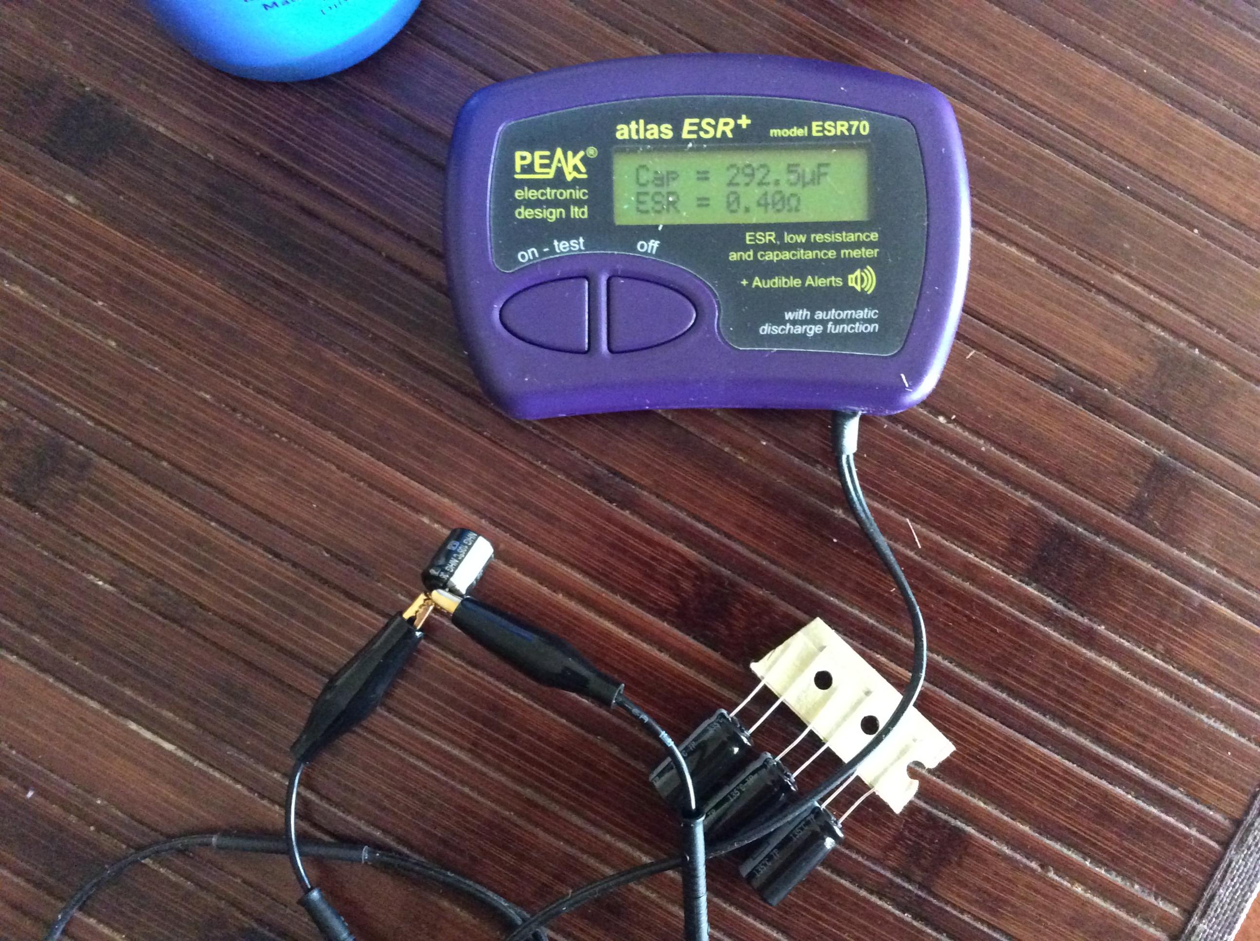

I also purchased a Peak Atlas ESR70 that gives me the capability to measure the capacitance and ESR at an instant.. Excellent little device...
