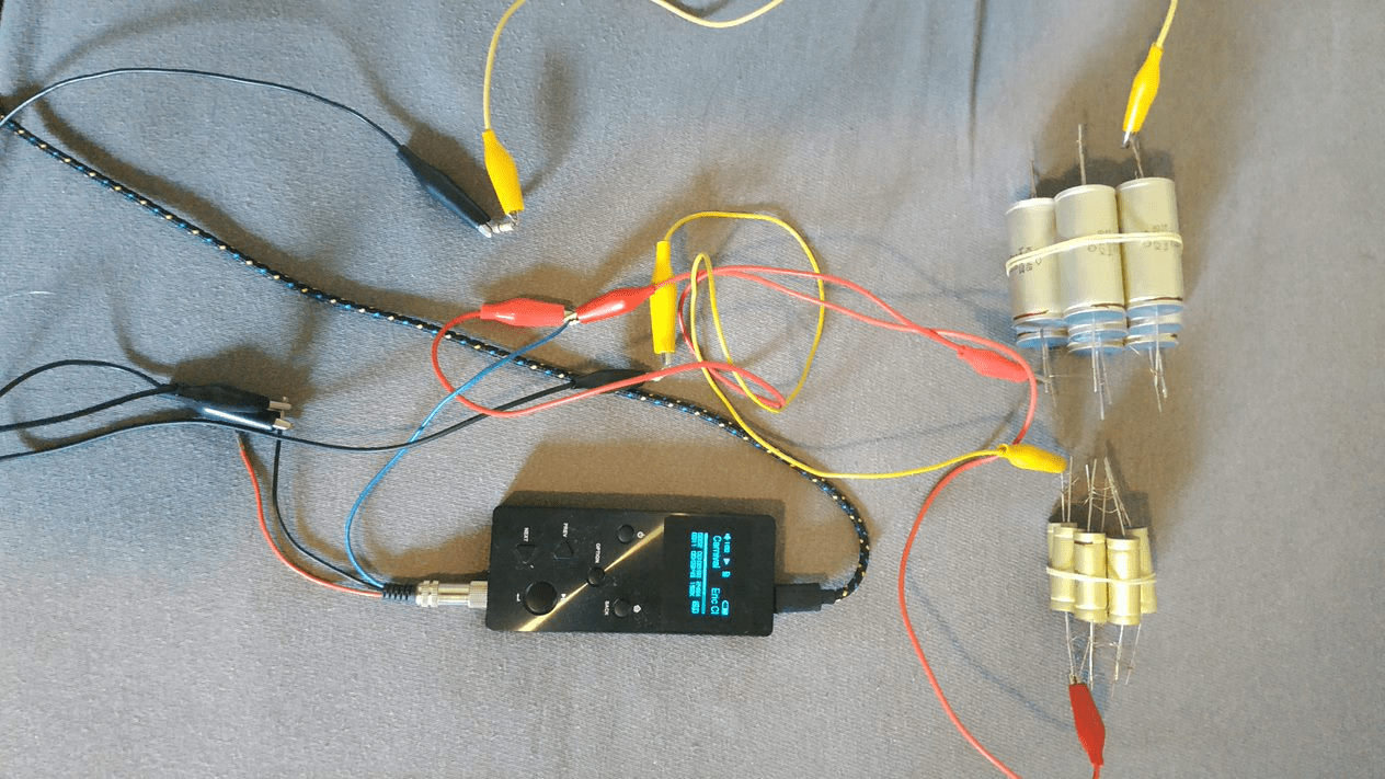

FWIW, I use a little DAP to break them in, in the background, over a few days. For 'lytics, I reform them first, with a DC PSU in place of the DAP.

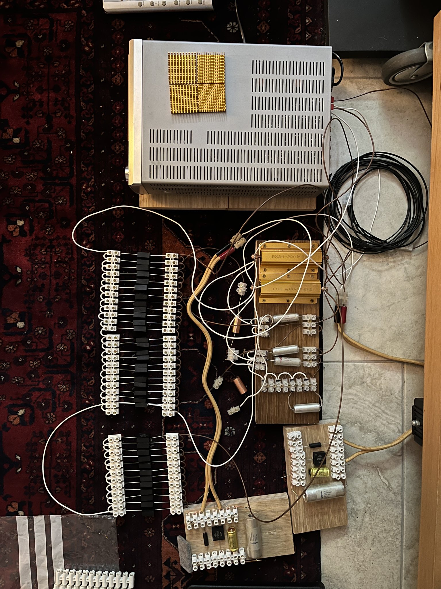

My once neat unit now overcrowded, I run in cable in series and the views of others was in parallel for the caps. No electrolytic's at the moment
