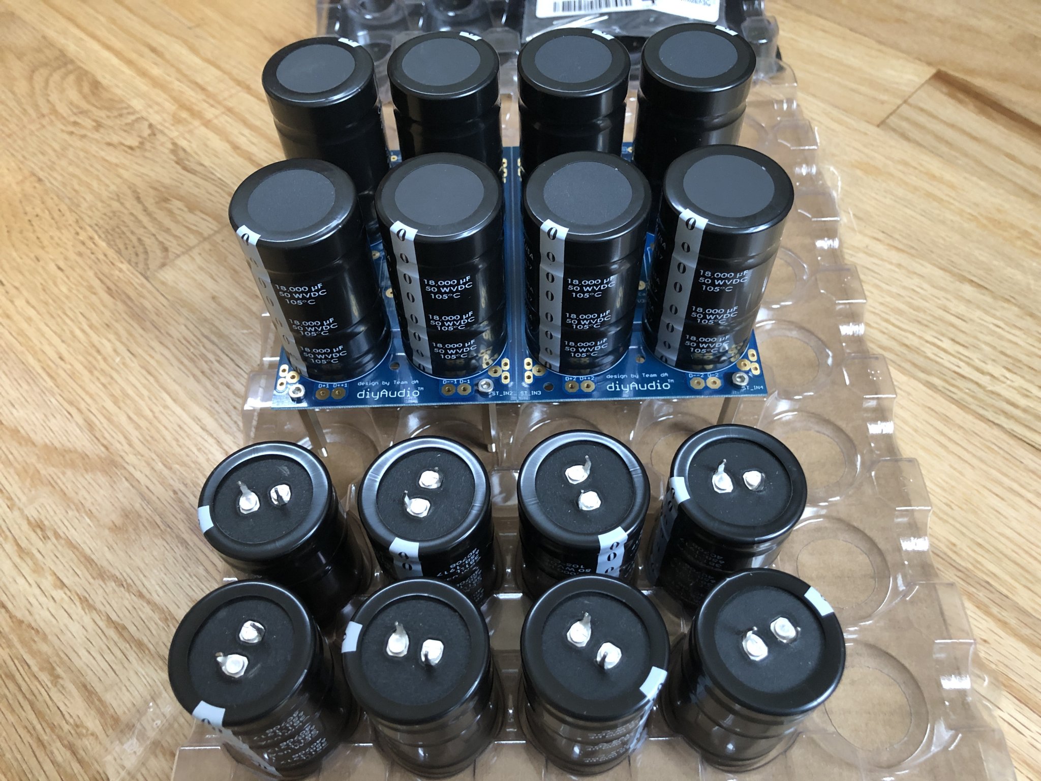

Well, I don't know CDE but I use the different Nichicon (FG, KA, KZ) and Silmic 2. I'm buying CDE 380LX at first time (already ordered). I hope for a good experience!As for the sound, the best cap simply doesn't exist.

Hi sworder84,
As long as those are legit Cornell Dubilier capacitors, you will have a good experience - unless expectation bias throws things off. I've used this brand (and others) since I began buying components as a young fella in the early 1970's. It is a solid brand and I still will buy and use them.
Relax, buy authentic new stock parts and ignore ideas about what is better, then come to your own conclusions. You'll see the truth at that point.
-Chris
-Chris
@sworder84 I think that if originals there is no reason to think that you don't have a good experience with your choice.
The advice is always to buy from usual distributors known for their good reputation.
Anyway my view is that it represents a step, maybe after months of satisfaction you will have some money to spend and you will think to change them just to hear if "something" changes in the sound of your system, maybe not.
The search for "the best" does not take you anywhere, because the best does not exist, but the things that can be done for pure fun with the spirit to discover your ideal sound are so many, some time.

Second vote here for CDE, they have been going for years. Not a fancy name in modern terms like Vishay etc but work well and not had a problem.
As alway check datasheet and then test but pay attention to the derating with frequency, temperature and age.
Wow!
Who cares what one person uses?? Jeeze, decisions are made on quality, delivery and price. You can't assume that part is the best simply because someone uses them! That and the truth is, several manufacturers make "the best" capacitor depending on application and model number of the part (capacitor in this case).
When you are buying in quantity, delivery (lead times and stock) is a paramount concern. Price factors in of course and you need a certain quality level. Almost every single good manufacturer does make a suitable part that performs as well as another manufacturer's part. When you are not building enough devices to require large parts orders you have a lot more freedom ('cause you don't need as many).
For example, where I am concerned I need the part to be available of course. I also need a high quality part (and I do have the experience and equipment to determine this), and of course the price has to be in the ballpark. Notice that I didn't say the least expensive or the most expensive. It also must fit properly physically.
I'm going to tell you from decades (over four) of experience with parts, there is no one best brand / model.

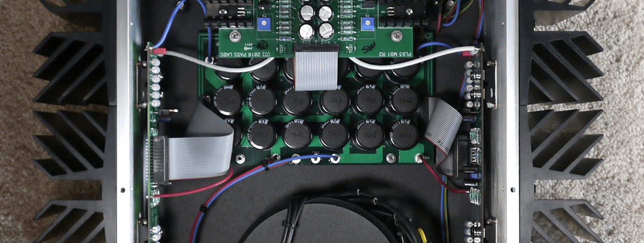

Correct me if I’m wrong but I would try to use 105c caps like 381LX or 381LL in power amps especially in class A amps.
Best electrolytics? For me which just nicely does the job.
Regards to mr. pass
Regards to mr. pass
Excellent electrolytics, ex BHC, I used the ALC10 series in my old DAC.A question of tehcnical suitability for Tube HV PSU ( PP Amp, A/B class, Bridge rectifier in PSU ) :

In my class A amplifiers, I have the 380XL series, which are 85C and after 15 years of use they are still like new. Normally, everything depends on the temperature at which it will work.Correct me if I’m wrong but I would try to use 105c caps like 381LX or 381LL in power amps especially in class A amps.
I ended up using 381LL series but I went for overspec. Figured they'll last my lifetime but I'm sure there are many other brands and series that will work just fine for a long time. Not sure how critical the temp rating is for Class A if they are provided enough ventilation or a seperate PSU chassis.Correct me if I’m wrong but I would try to use 105c caps like 381LX or 381LL in power amps especially in class A amps.
Yes, internal temperature for a capacitor is what determines how long they last. So you have ambient temperature, and also the ripple current through the capacitor that generates heat.
