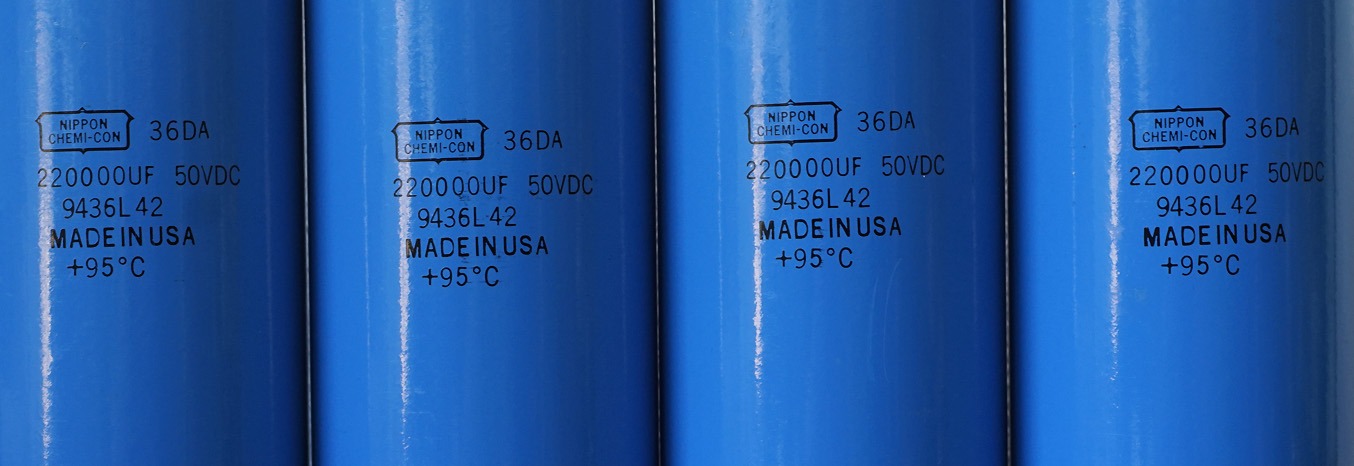

Thanks, that is an old design. Nothing remarkable and certainly will not benefit from huge amounts of capacitance at all.
So for max current peaks (that is what you are talking about - right?), you need a capacitor that can take and release energy quickly. That description is not for a huge capacitor. You would probably be clipping for this to be a factor anyway. Keep in mind that music has a peak to average level of between 10 and 15 dB, although you can find examples outside of this. That means that listening to a digital source at 10 watts average, your amplifier may well be clipping. Now, reconsider what you are worried about. You will only ever draw peak currents delivering a sine wave into a dummy load (most speakers will not survive that power level even though they are rated for it). So .... you're concerned about what exactly?
You didn't list the bias current, I'll assume betwen 50 and 100 mA. Any more is excessive. I guess you have three caps per rail for the high current supply then? The driver supply doesn't need very much at all. So for the high current supply, you could use 3,300 uF (that's 9,900 uF per rail) and have a ton of excess capacity. They would perform much better and greatly reduce hot switching current and hash from rectification. the inrush current would then also be at sane levels with an E-I transformer (better), a toroid requires a soft start and doesn't do much more than allow higher frequency line noise in, and conduct heavily with effective DC on your mains if there is any.
Smaller capacitors in parallel are only effective near the point of load (or use), and even smaller ones near the rectifiers to try and reduce switching noise. The best way to to avoid generting HF hash as much as possible to begin with.
I'm cetain the designer thinks this is superior to any amplifier that ever came before. You should be more concerned about PCB layout and wire lead dress as that makes a much bigger difference in performance. Think about what I just told you, and figure out your average current at a 10 watt power level.

With 37V rails I would go for 3 x 15.000
The thing is, we want stable supply voltage for high current draws at low frequencies.
Transistors like constant supply conditions, that is why we use cascodes, voltage drop at bass impulse is quiet the opposite.
Additional local decoupling near the output fets for the mid to high frequencies.
Ouput and driver transistors never have a stable supply. Compare the output amplitude to the ripple amplitude. Compare the amplitude of the ripple voltage to the average DC levels.

At 20hz, a 4.700uF will have a 1.7 ohm capacitive reactance. An 47.000uF will have ten times smaller, 0.17 ohm. Sometime, you can hear that. In a highend domain, the linear impedance of the power supply in all audio band is a must have. Ok, a larger capacitance for this situation is not the smartest choice but is simple to apply. In this moment, the caps will not be just a ripple filter, will be a energy reservoir for the lowest frequency too.
Generally speaking we don't need a huge capacitance but sometimes, with large and difficult speakers is good to have more then enough capacitance.
