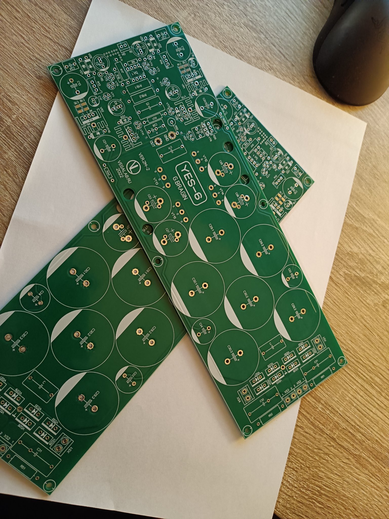

Yes, I need the maximum capacitance with 35mm diameter. They said that's correct. I aslo saw 10 and 15000uf in sale.
I am choose the electrolytes by quality, brand, prices. Sometimes needs the low esr capacitors. Datasheets of theses two capacitors a very same but I don't know Cornell - never use them and recently learned. 380lx positioned by for audio like Nichicon Muses, is that correct?
I can give you a schematic if it helps.

Well, that is incorrect. The advice you have is wrong, and you didn't provide any information as I asked.
I can't help you with that idea in mind.

Large capacitors, and maybe lots of them, are not a good choice for any amp, especially if you want it to sound good.
I did something like this 25 years ago, but I've learned.
There are various ways of calculating how many uF makes sense on the web, but don't be surprised if you only get 10,000uf as a total capacity, which is best divided into 3-4 capacitors, as CRCRC..... with 0.x - 0.0 x Ohm resistors are installed.
Alternatively, you could use a good dual voltage SMPS for audio. You would then only need a capacitor between 470 and 4700uF for each voltage (follow the recommendation of the SMPS manufacturer). I wouldn't be surprised if that beats your conventional power supply by X00,000uF and is cheaper.

Any option is very good. I use 22.000u/50v. Accuphase has 47.000uF in one capacitor and is very good. Have you 3 big capacitors in paralel on rail ?Hi, guys! Now I build the Diy project of the power amp and I need to buy a large denomination of the capacitors. I am looking at two options - 380LX CDE and Nichicon LLS. They are needed in 18000uF/50V (35mm).
Which option would be better?
Yes. I can to start with 3 caps for channel.Any option is very good. I use 22.000u/50v. Accuphase has 47.000uF in one capacitor and is very good. Have you 3 big capacitors in paralel on rail ?

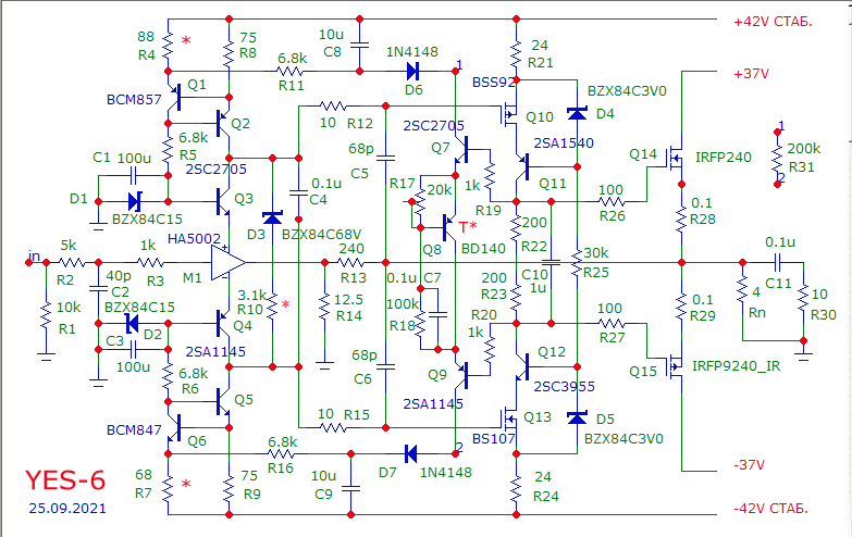

Guys, I'm only repeating the project! This is how the others assembled! I'm open to an alternative opinion - please say it.
I have not seen the design, have zero idea of the power output (into 8R) or the idling current. I don't think that anyone can give advice without this very basic knowledge. I have asked repeatedly for this information.

When I needed reserve caps I looked at the max current at that 50hz I needed. The cap for me (datasheet wise) was the CDE 380 etc. Other options i’ve bought panasonic and nichicon.
Thanks, that is an old design. Nothing remarkable and certainly will not benefit from huge amounts of capacitance at all.
So for max current peaks (that is what you are talking about - right?), you need a capacitor that can take and release energy quickly. That description is not for a huge capacitor. You would probably be clipping for this to be a factor anyway. Keep in mind that music has a peak to average level of between 10 and 15 dB, although you can find examples outside of this. That means that listening to a digital source at 10 watts average, your amplifier may well be clipping. Now, reconsider what you are worried about. You will only ever draw peak currents delivering a sine wave into a dummy load (most speakers will not survive that power level even though they are rated for it). So .... you're concerned about what exactly?
You didn't list the bias current, I'll assume betwen 50 and 100 mA. Any more is excessive. I guess you have three caps per rail for the high current supply then? The driver supply doesn't need very much at all. So for the high current supply, you could use 3,300 uF (that's 9,900 uF per rail) and have a ton of excess capacity. They would perform much better and greatly reduce hot switching current and hash from rectification. the inrush current would then also be at sane levels with an E-I transformer (better), a toroid requires a soft start and doesn't do much more than allow higher frequency line noise in, and conduct heavily with effective DC on your mains if there is any.
Smaller capacitors in parallel are only effective near the point of load (or use), and even smaller ones near the rectifiers to try and reduce switching noise. The best way to to avoid generting HF hash as much as possible to begin with.
I'm cetain the designer thinks this is superior to any amplifier that ever came before. You should be more concerned about PCB layout and wire lead dress as that makes a much bigger difference in performance. Think about what I just told you, and figure out your average current at a 10 watt power level.
