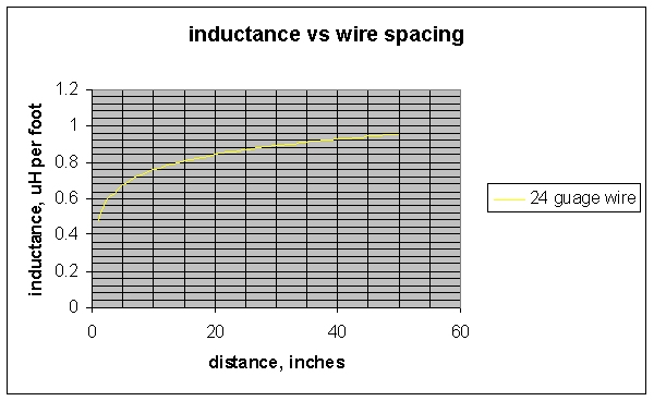

What I am pointing out is the problems measuring what you guys are talking about, with concurrent errors.
As an example, a 24 guage wire pair exhibits about 1 uH per foot when it's anticurrent mate is 60 inches away.(This spacing chosen to get a reasonable per wire estimate of inductive reactance). For a single current carrying conductor of 24 guage, it is reaonable to assume half a microhenry of reactance.
A diode which will shutoff in 1 usec, and 1.5 amperes (the old jedec spec numbers), that is 1.5 amps per uSec. Using V =L di/dt, the induced voltage across .5 uh is .75 volts, across one inch of 24 guage wire, that voltage error will be 63 millivolts.
If the CVR (as you recommended try) is low enough in value to not disturb the series circuit, say 100 milliohms, the IR drop you are discussing will be on the order of .15 volts give or take.
At 1 amp per microsecond, the error will be 63 / 150, or 42 percent.
A 1 uSec device is a general purpose rectifier.
At 10 amps per uSec, the error becomes 420%.
At 100 amps per uSec (this is typical of a 10 nSec device), the measurement error is 42 times the entity you are trying to measure. Attempts to view this device using a simple resistor, or even using a scope probe with the alligator clip type ground lead, will result in wildly erroneous waveforms of the type that diode manufacturer (onsemi I believe) has provided.
I know how to remove that error very easily. But it is an error that most are unaware of. Discussion of wild transients must be tempered by the fact that they certainly do not exist at the levels that the measurement equipment is reporting.

Ah, last math error of mine in post..forgot to convert from 500 nH of a foot, to 1 inch CVR. 42 nH for one inch. At 8 mm, that'd be 13 nH.
So let's have an abrupt I dot of 1.5 amperes/1 uSec.
.013 uH times 1.5 is 19.5 millivolts.
That is for a standard recovery device. BTW, that is the timeframe for the device to arrive at zero conduction, and does not represent the rate that it "zones out". Abrupt recovery devices are very bad in this respect. So I use the device spec'd number just for reference, with the caveat the real devices will transit from reverse conduction to zero at approximately 10 times the rate. My estimates are lowballs.
100 Nsec devices...195 millivolts
10 nSec, 2 volts.
IF the 10 nano device actually recovers in 1 nSec, 20 volts?? That is the voltage response on your 8mm long resistor, 50 milliohm resistor.. Your resistor design would not be acceptable for use in a TRR fixture as a result of it's inductive storage. Yes, it is low, no it cannot accurately distinguish the current change in a fast or medium fast diode.
The one or half amp signal in reverse direction is being viewed as a 50 millivolt signal, but yet the resistor will generate 4 to 400 times that depending on the snap characteristics of the silicon.
As I said, how does one distinguish the characteristics of the silicon independently of the cvr?
Personally, I would be less apt to recommend the selection of a diode based on it's recovery characteristics if all I had to go on was waveforms and writeups based on those waveforms where the test conditions were incapable of discerning real differences. If you really want to identify the issue of diode selection vs sound, this is not the best place to look. I note that both of you are also looking at the other circuit element waveforms, and are doing so quite well. I have been very happy to read both your's and Eve's posts.
Using a differential probe setup does not remove the pickup inductance. You must consider the physical signal path loop.
I have found that those little probe tip females, the kind that come with the hp or tek probes, are the best, but the physical size of your resistor does not allow taking advantage of that.
This is why I said I can detail a resistor which does not suffer the issue I speak of.
Cheers, John
Edit: Joseph, I just remembered that you were the one I had the braid over capacitor discussion with...
Your resistor suffers the exact same thing..the external inductance..
If you take 10, 1 ohm resistors and parallel them to form a cylinder..have the circuit current flow through those. To measure the current through this resistor, run a wire through it on axis, use the scope from this wire to the tie point opposite the wire connection. That removes the scope wire from all collapsing magnetic fields. This is exactly what I had mentioned as possibly sending to you for measurement on the analyzer..
