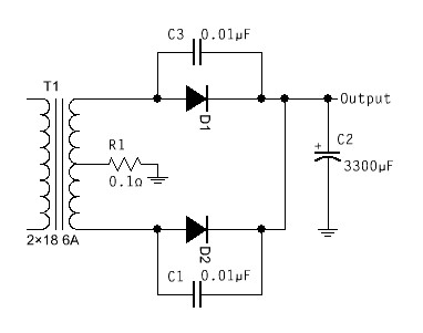

when are we going to kill this over-flogged horse -- you can see the effect of a diode's junction capacitance when you use an EI core transformer (with large leakage inductance) -- I said you can see itwith a scope but I don't know if you can hear it in an application which draws a few amps. If you are an analog circuit designer trying to squeeze out acuracy in the LSB's then it's germaine.
the diode capacitance forms a "tank" circuit with the transformer and will oscillate -- the cure is inexpensive -- an RC network in parallel with the diode is the simplest cure.

Put a low valued resistor in the ground return to the transformer's center tap, something like 3 Ohm. Then put your scope's probe across the resisitor and you will get an idea of the charging current spikes.......

pwillard said:No doubt it's a regularly debated issue, but a circuit like this using standard power diodes makes for a good supply.
putting a 10nF cap across a diode just lowers the resonant frequency of the "tank" circuit --
I should add (to my own post) that when you lower the resonant frequency of the tank circuit you also DECREASE the voltage spike that the diode will see as a result of the transformer's leakage inductance --
