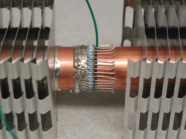

As a test engineer for the largest manufacturer of diodes on the planet (4 million units per day at the time), One of my tasks was measurement of TRR, both for existing product, and for newer higher speed R and D. In that capacity, I developed a TRR fixture capable of measuring the snap recovery of a diode with sufficient bandwidth to show a square wave with 250 picosecond rise times. This of course, required the use of microwave power resistors (BeO) and the layout from "heck".
I discovered then (1981) a signal generator called a Tek type 109 (at the time it was over 20 years old) which produced 250 pico rise/350 pico fall times. A little known attribute of mercury wetted reeds is their amazing rate of current change during make or break.
My fixture allowed the diffusion Phd's to see exactly what the diode was doing in the sub nano regime, and gave them feedback for diffusion profile modifications.
Seeing the waveforms being presented on these posts remind me of the horribly speed challenged TRR fixtures I have seen in the intervening years, and the incorrect assumptions resulting from the inadequacies of the test methods and materials. Also, the fundamental errors which we (I include myself) have committed in trying to measure these speeds in low Z circuitry.
One of the easier things to remove, is the inductance of the current viewing resistor. It is actually rather trivial to make one which theoretically goes below 60 picohenries. I made one, pic attached. I must note that I have tried to measure the inductance of this beast, but have not been able to acheive a reliable measure at the 60 pHenry level, I am only able to get the measurement down to 250 picohenry maximum. (this inability stems from the current path taken as it spreads out to the ring of resistors, I cannot physically remove that.)
Anyone interested in making a simpler one that will be good to the single digit nanohenry level, I'll describe it. It would take only 2 or 3 matched 1/4 or 1/2 watt carbons to make a simple one which outperforms even the caddock ceramic types by an order of magnitude.
(I have much experience in this area, having been bit in the hindmost on many occasions)
As the waveforms are such a confusing mess, it it very difficult to figure out which is due to the diode, which the surrounding circuitry, and which the result of measurement error as a result of inductive coupling and inductive reactance. This is why I said get the stuff to settle in 200 pico or less, that way it is much easier to understand the waveforms without wondering how much of it is related to the measurement technique. I would be happy to evaluate and put my two cents worth in if pictures of the setup including scope probe were presented. There is a very small possibility that my experience could be of some use. Ok, maybe a small possibility, but I can dream..
Cheers, John
Edit: yah, the right side is not soldered, this is a pic of the incomplete one. I did not have a good pic of the finished which shows the detail of the resistors.

What is wrong with you...??poobah said:That look's an aweful lot like a space modulator. I have had to build IGBT snubbers that were as messy.
Given your Avatar, I was sure you'd say it looked like a tie fighter You're under your game there..
Actually, I figgered it looks more like a space heater, what with the fins and all.
It's amazin what ya can do with a section of slantfin from Home depot and some resistors from Digikey. (my first test load resistor got overheated and melted the solder, it was on a 1/2 inch diameter tubeset, with no heat sink fins...using the slantfin allows more dissipation.
My next config will be a symmetrical block style, and I'll epoxy encapsulate it with a CPU cooler as the base of the structure. That'll get me into the several hundred watt RMS regime without melting the solder again.
Cheers, John
