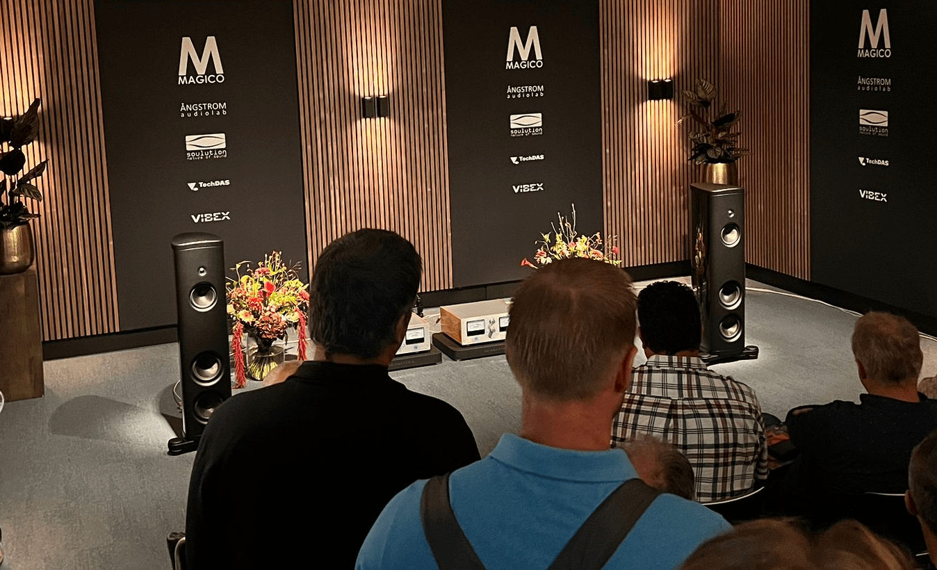

Magico Ro808?
Your own experience with them?
In camplo's thread I've briefly shared my experiences, but I'll add some details.
First a translated quote from a dutch website.
"It was hard work to get everything ready on time. From all the preparations in advance, the layout of the room, the acoustic properties to be obtained and of course what to bring with you to give a top demonstration. Having functioning room acoustics is absolutely desirable and necessary for performance. That is why it was decided to make a large frame that was mainly made up of wood-up panels. These highly decorative panels contribute to obtaining very good conditions for sound reproduction. The combination of both damping and diffusion is very desirable for reproduction and it also looks very nice. The panels are available in various types of real wood veneer. To obtain a correct bass reproduction, we have placed Bass Chunkz behind the frame."
And some additional stilted, diamond clad marketing blurb:
"Setup and tuning
The challenge remains during such an event to obtain enough sound, tranquility, space and definition from the system. That is why importer Symphonie Audio decided to supply equipment from Angstrom's exclusive Stella series. We played with the Angstrom Stella ZPR 22 preamp and ZMA 180 monoblocks. These are "all tube" designs and have amazing control with a very rich sound spectrum. The Magico M2 brought along by AudioXperience were effortlessly controlled by the Stellas, thanks to the circuit operating in class A. No less than 180 watts per mono power amplifier! As source we brought the dCS Rossini Apex player with accompanying master clock. A fantastic high performance streaming audio player with CD transport. New at AudioXperience is TechDAS. This idiosyncratic manufacturer from Japan supplies and makes one of the most beautiful turntables on the market and fits perfectly in terms of level in this system. Crystal Cable debuted with the van Gogh Art series cabling; never before have we become acquainted with interconnects and speaker cables of such a high level. Exceptional refinement and very rich sound structures filled the room with music! We opted for a tuning in which the aforementioned aspects were fully present in the reproduction. We were thrilled with how incredibly rich this system sounded with a very wide and deep soundstage. The playability was also fantastic, you didn't have to look for that one recording that works. In short, we were delighted and given the number of positive reactions, the audience present was too!"
I have absolutely no need to speak on behalf of 'the audience', because about 15 years ago I disconnected myself from the high end audio world.
Nevertheless, my expectations were high and I was counting on a certain 'quality experience', even though I knew in advance this setup would never meet my philosophical and technological ideals.
Fortunately, Sunday afternoon was considerably quieter than the day before, so there were no queues for most rooms.
Definitely one of the more expensive setups, with a total price north of $250,000.
I sat down in the same chair as the slumped man in the black sweater on the right.
I often close my eyes to avoid visual distractions.
A blues track was played, not exactly the type of blues I would listen to myself, but certainly not standard MOR high end music.
Over the years I have developed a (personal) frame of reference > a combination of experiences (including live/acoustic music), knowledge and a more philosophical contemplation on these matters and more.
Under the influence of imagination, a kind of 'inner knowing' has arisen through which, when listening, everything immediately snaps into place, or not.
The snap does not imply 'perfection' in any way, but consists of certain basic qualities through which the experience reaches a certain level. Non-rational terms such as 'authenticity'/naturalness and 'credibility' come to mind.
In the Magico room I wasn't touched/involved, so there was no 'snap'.
In fact, in typical audiophile fashion, my attention was immediately drawn to all kinds of details in the reproduction instead of the music as a whole.
In other words, it was mainly a static, technical presentation in which the inspiration/soul of the music was missing. My brother and our buddy both agreed.
Was the rendering bad? Evidently not, but the sterile, analytical character suits studio monitors better in my opinion.
