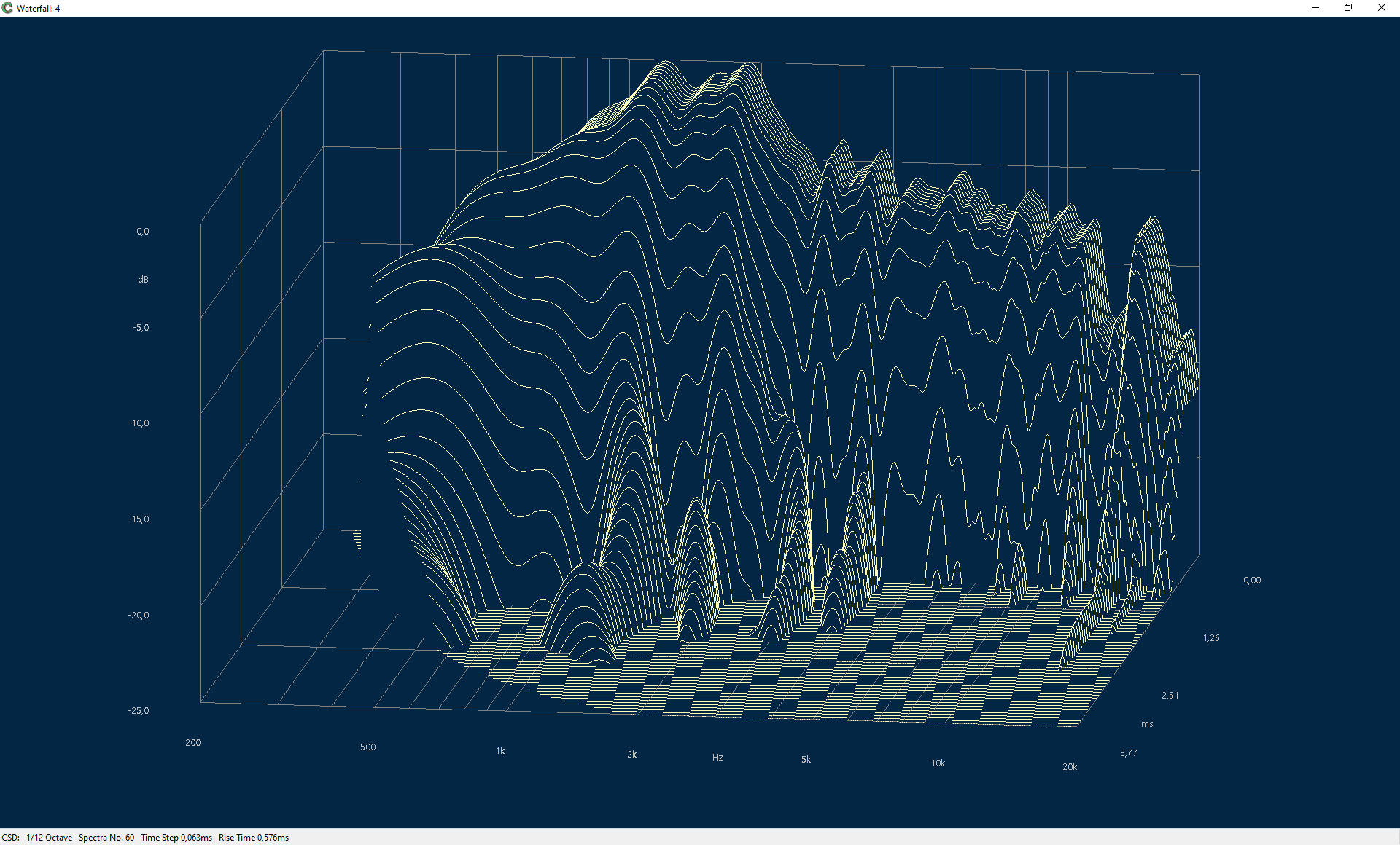

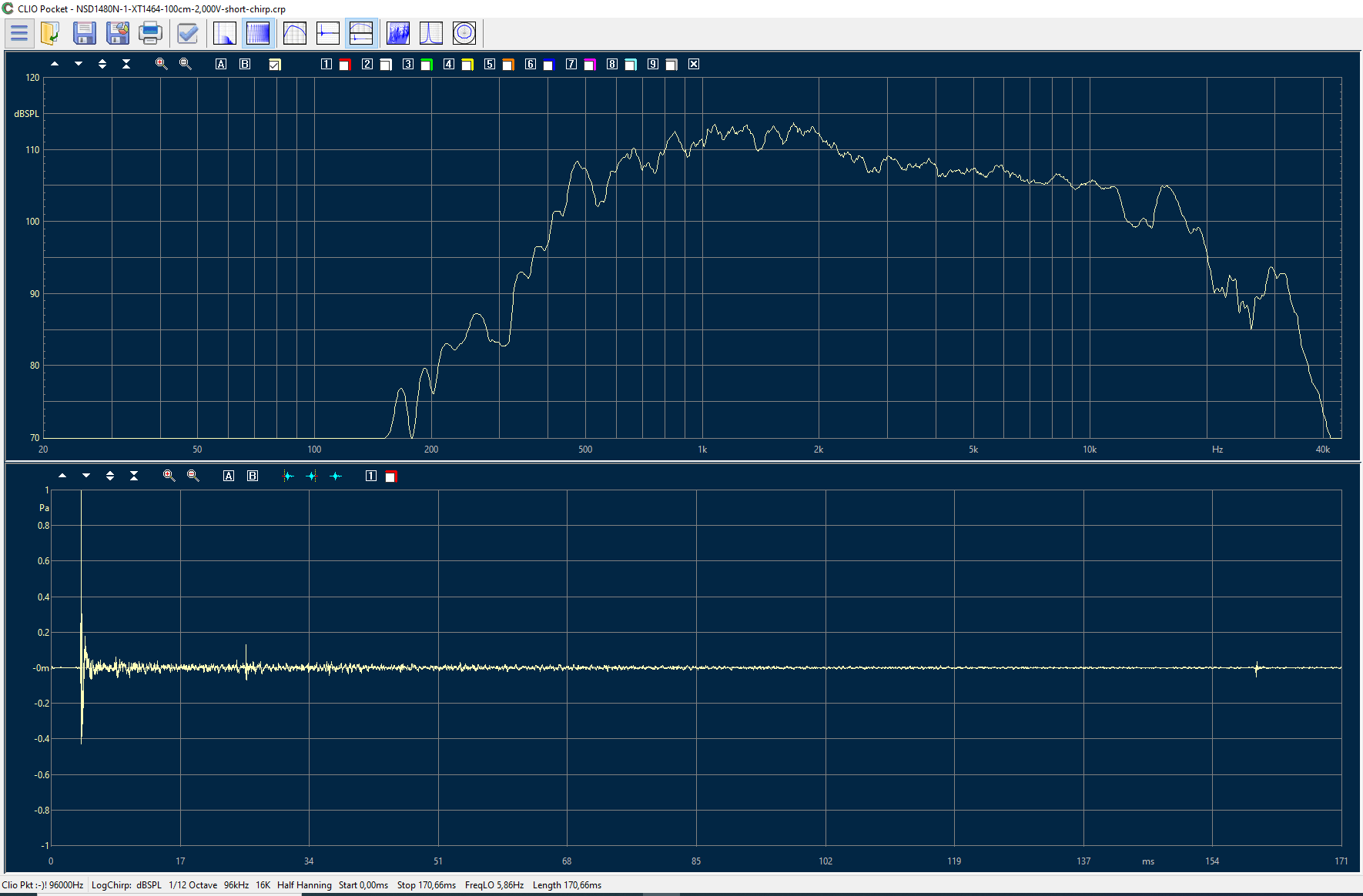

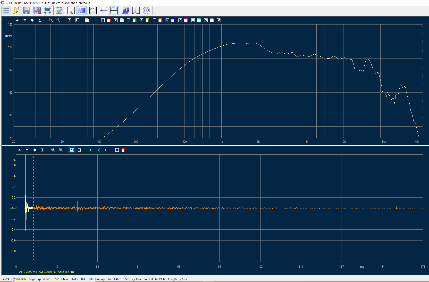

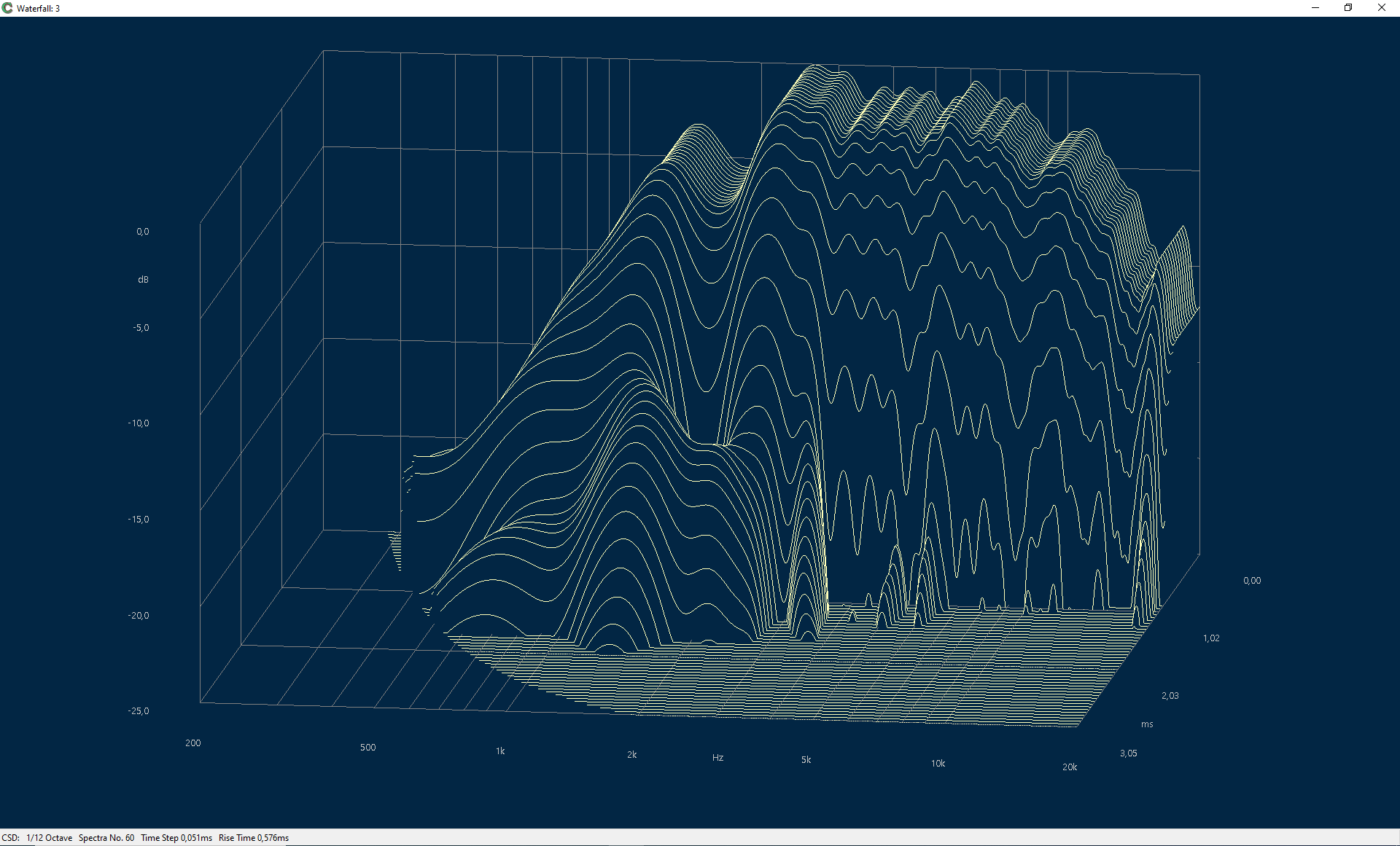

Here another bigger nitride coated one, NSD1480N + XT1464 60 X 40 elliptic CD horn - but i do not like the "it's all plastic what you need" look & feel of the 18sound XT1464 horn
unwindowed third octave smoothing for horn cut off evaluation
windowed measurement for upper frequency behavior with one twelve octave smoothing
and the corresponding waterfall diagram

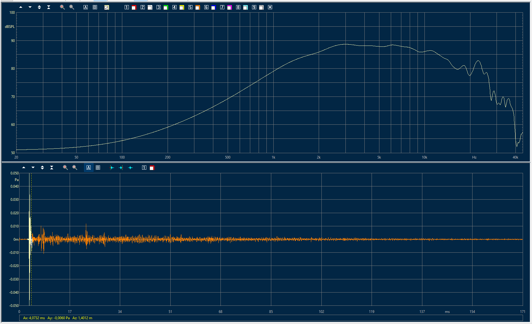

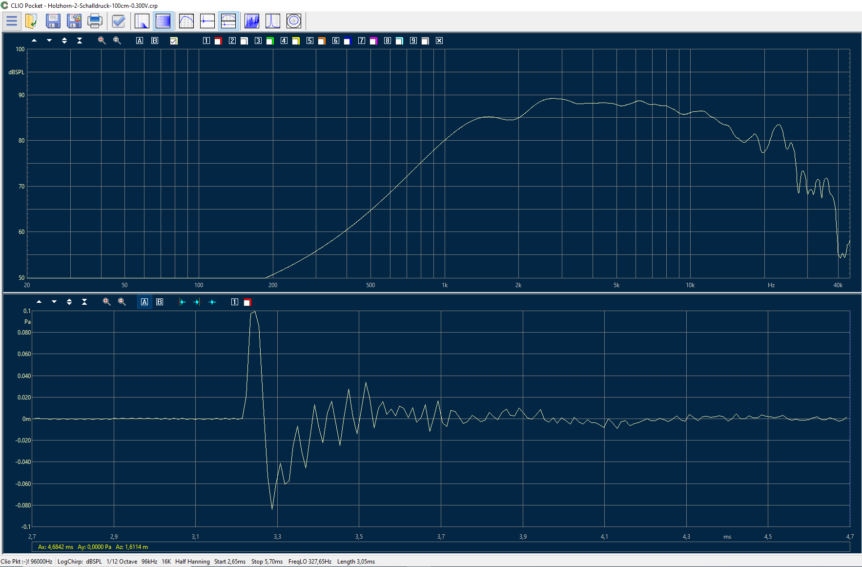

Thanks for the measurements. Could you post the impulse but with a total time scale of 2 ms please?In the affordable range my choice are the 18sound drivers with the nitride coated titanium diaphragm material.

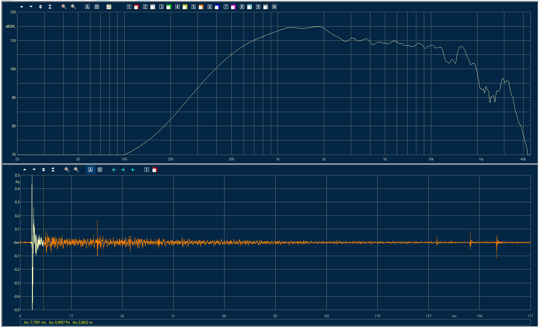

I have the small one with some measurements done with CLIO pocket here:
18sound NSD1095N + LMH sTrak 4.5 inch tractrix wooden horn

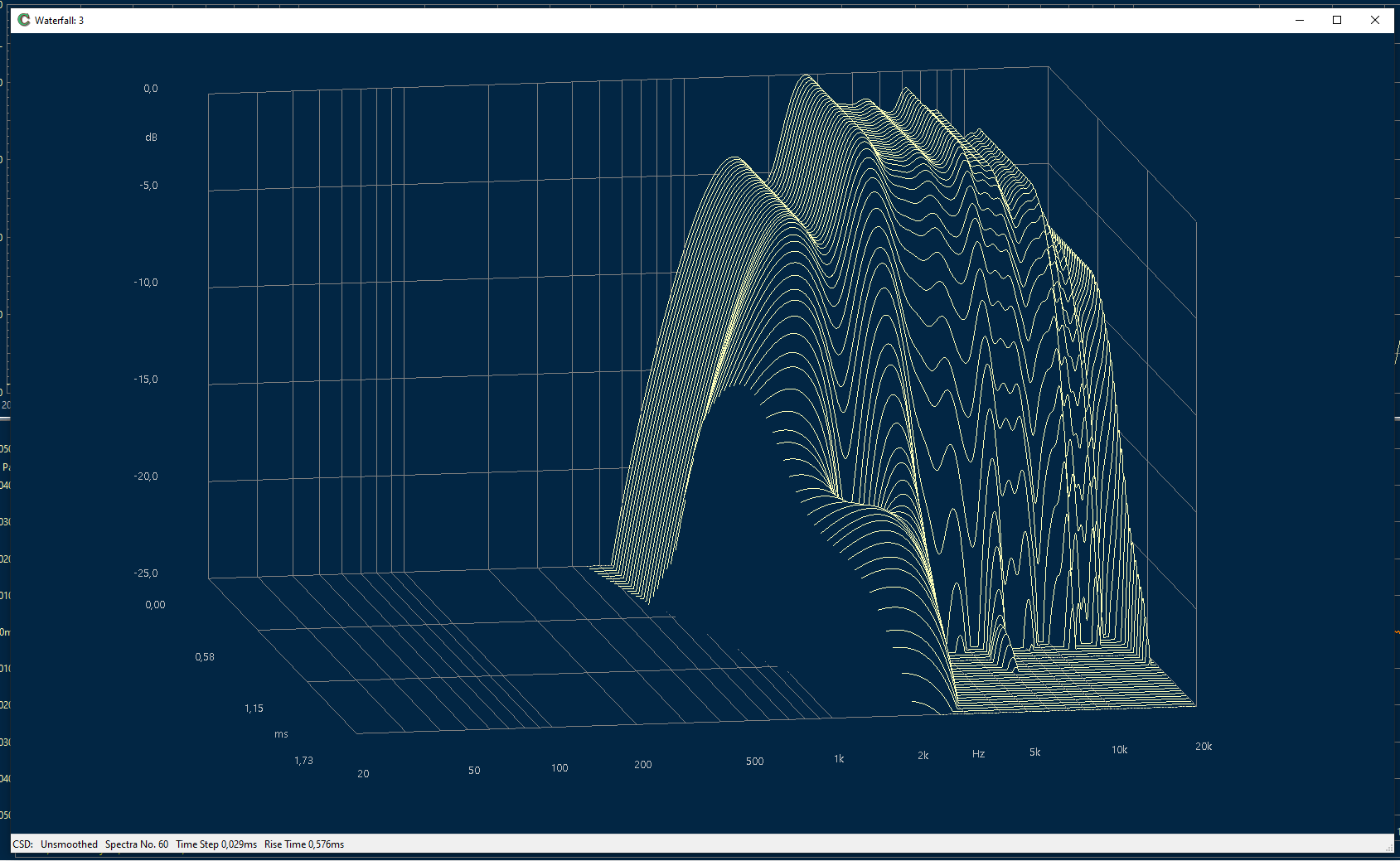

And if possible, turn the waterfall for a veiw more from the right (high freq) - and start it on 500 Hz - also deepen the levels so we can see down to -3+ dB?

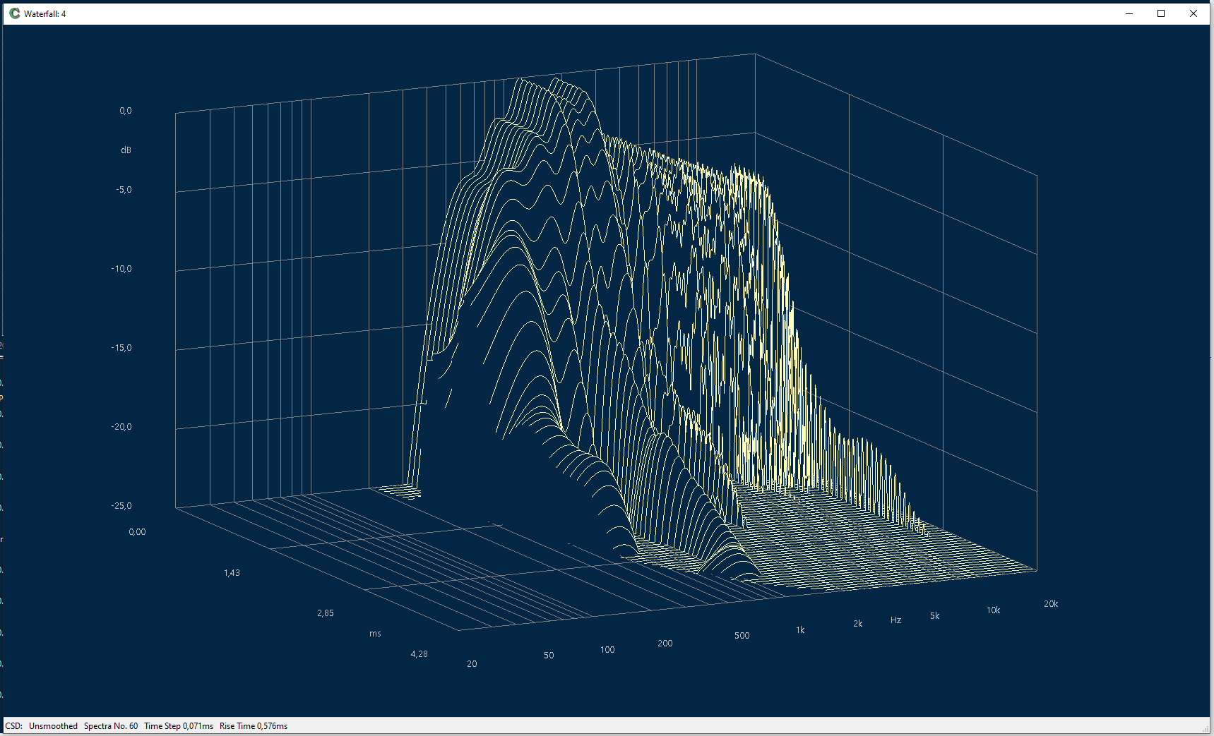

Good morning ladies and gentlemen!
I am quite new to CLIO pocket and still fiddling around a lot with the software issues.
I post some changed views from the same CRP file obtained from the measurement of the NSD1095N with the 4 1/2 inch wooden horn some days ago.
here we can see clearly that an analog measurement without sampling effects with a good old storing oscilloscope would be much better
this is the unchanged default view of the waterfall diagram from the CLIO software

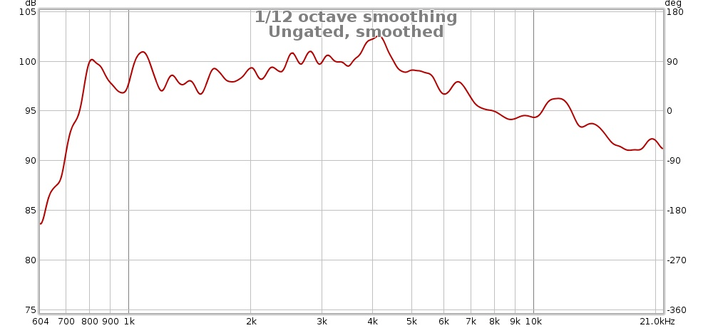

This is a measurement of the CP755Nd on my monster ES horn at random level and 0.5 m distance (inroom, therefore Psy smoothed). It is an exceptionally flat response.
Just for comparison, BC DE500 on a smaller version of the ES horn:
Different scale and smoothing, but the downwards slope above 4k is clearly visible. I am not sure where this comes from, maybe my pair is just not perfectly OK. There is nothing like that to be seen in the datasheet.
